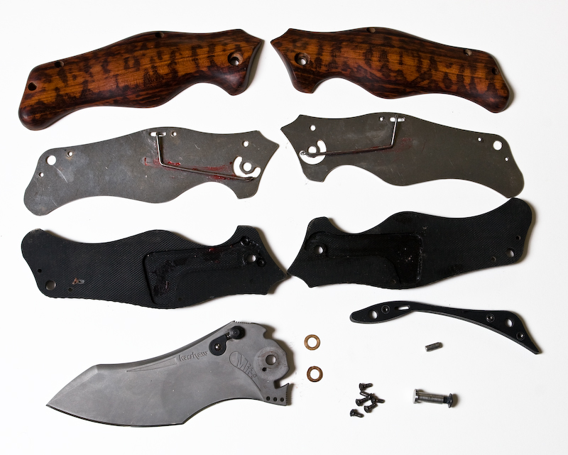

Here are some photos of disassembled Speed Safe knives. The Offset is the only knife with two torsion bars, as far as I know. You can see the bar in place on the 0350 with the translucent scale.
Torsion bars can break, but it's rare and easy to fix (Kershaw sent replacement bars in two days, free of charge). The most reliable way to break the spring is to repeatedly, and in succession, open-and-close the knife for a while. This will fatigue the spring, causing it to break.
A broken torsion bar will not stop you from using a 0300 due to the friction caused by the frame-lock. It is a big deal on a knife like an Offset or Bump (stud lock knives). With the bar broken, there is nothing to keep the blade closed. It would be a little dangerous getting the knife home in a state like this, if there weren't redundant systems on all of them.
