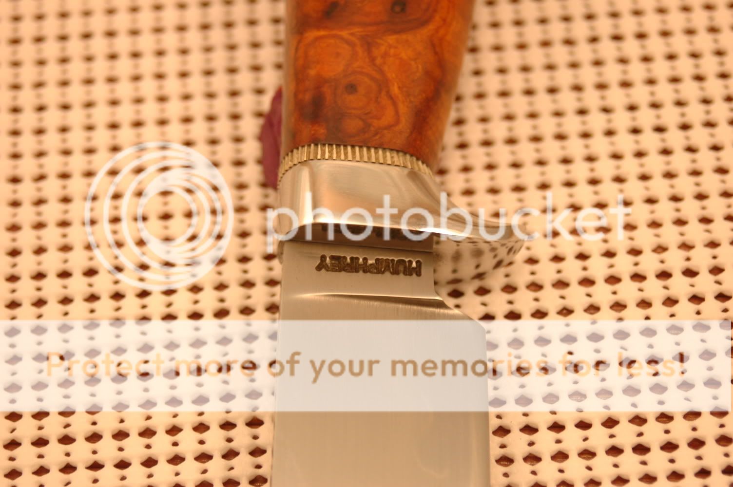

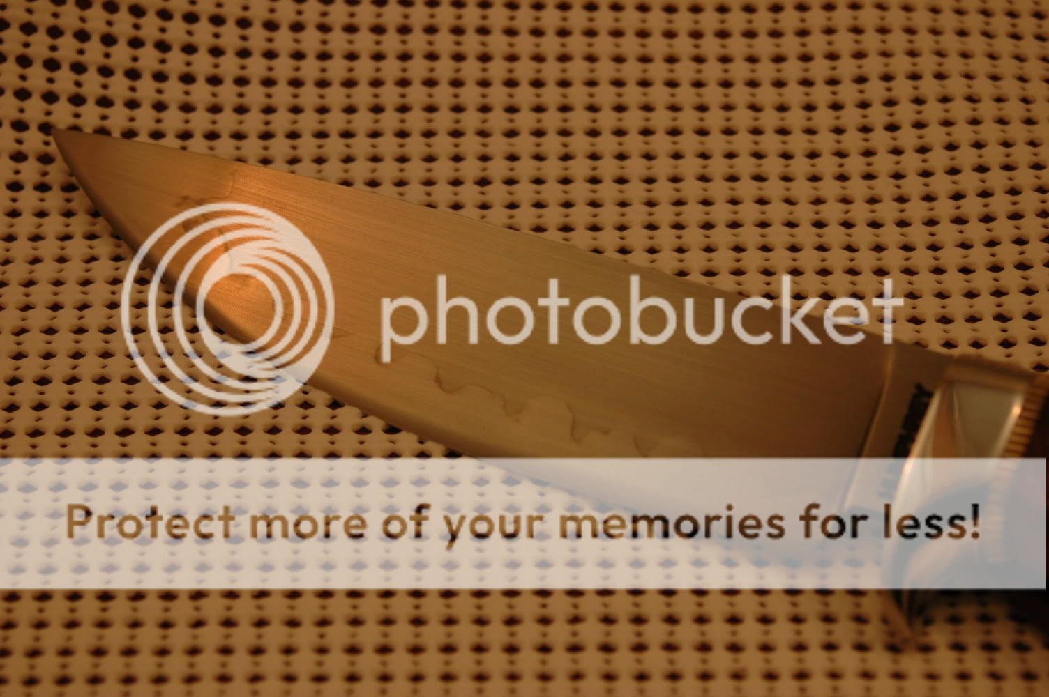

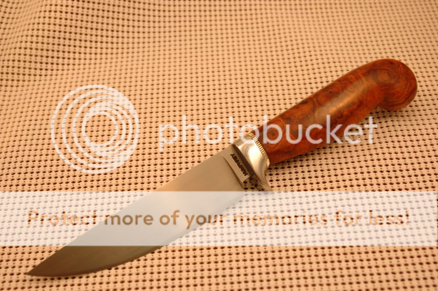

Do you have a pic of the Lon Humphrey W2 knife, you had?
Sure. Lon's a great guy and makes some seriously nice knives.
Plus forges his knives out which I have great respect for anyone whom does that.
And actually I think I will get getting another knife from him in the future, I really liked his work.

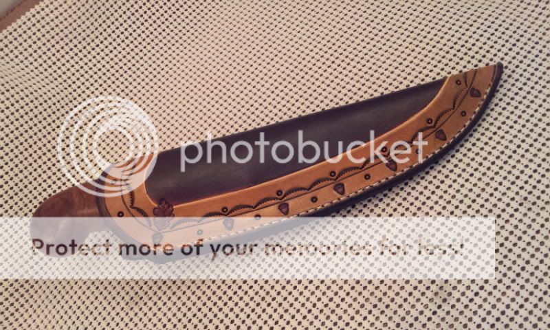

Sheath I believe was custom from Sharpshooter sheaths. I don't remember 100%.
