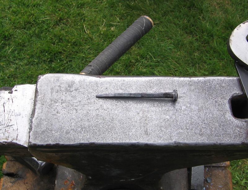

I was thinking more along the lines of the old home made square nails with the faceted (rose) heads. I make these to go with various hooks and hangers I forge. A square shank of the proper size would fit the slot very well.
People love getting these old style nails with their hangers.
I think some of the hand forged nails used for finish and furniture making had the T heads as well as some cut nails.
