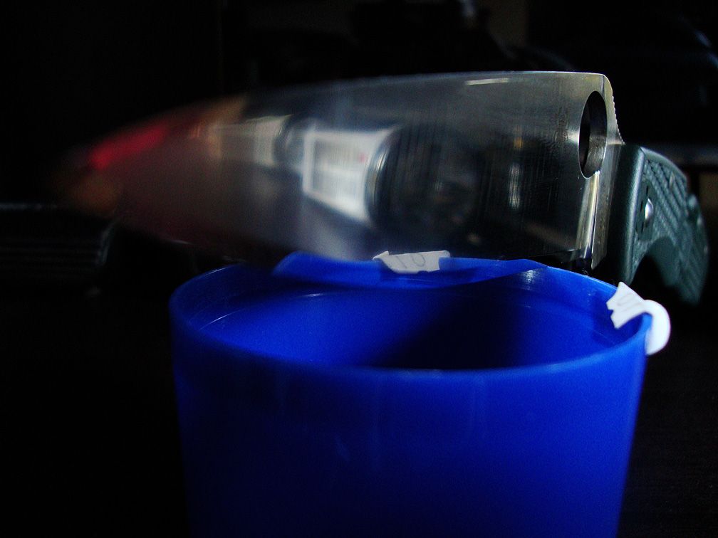

The 1st Endura I got was back in 1992 and has served me very well with the ATS-55 blade steel , a few months ago I pulled the trigger on the Endura with ZDP as one of my EDC's . I can attest that Spyderco's ZDP is amazing steel and keeps a sharp edge for a very very long time and if sharpened properly can match the Rockstead ZDP very close for sharpness , which is very very sharp . Keep em sharp boys !!.
I just got a ZDP-189 stretch. It will be my new EDC. Why I waited so long to get a knife with ZDP-189 I'll never know
I have several William Henry B-15's and Spyderco Enduras with ZDP-189 blades. I haven't had to to bust out the diamond "stones" on any of them. The Vanadium Carbides in steels like S-30, S-60, S-90, S110, and S125 Rockwell at 82 on the C scale. Tungsten Carbide tool bits Rockwell at 72C. They can be sharpened easily on SiC (Caborundum) stones. Aluminum Oxide stones are harder than 67 HRC. If your ZDP knife takes a little longer to sharpen, rest assured that edge produced will last much longer.
I really have enjoyed my BRG Spyderco Stretch, in ZDP-189. it's held up to a myriad of task without being, chipped or anything like that, it's not something you want to drive screws, or pry with, but mine has displayed that it will hold a fine edge for some time, and a working edge for a very lengthy amount of time. I sharpen mine with a Lansky, and diamond hones. I sharpen it 20 degrees per side, with a hint of a 30 degree micro bevel. Works for me, but may be too thick for many. Not the most corrosion resistant steel I've used, it's actually forming a sort of light patina in some areas, and I personally think it's cool.
Well zdp-189 is an incredible high performance steel. if you're thinking about it, just pull the trigger and thank me later. That being said, it is an EXTRAORDINARILY fine grained steel, always comes hair splicing sharp and can take a beyond scalpel sharp edge. Zdp is also the hardest knife steel period, I believe spyderco runs their around 65 RC but it can be taken up to 68 if I remember right. If you let it get dull (which would take forever) its a nightmare to reprofile and fully sharpen. That being said, if you touch it up continuously, strop it, and keep that hair splicing edge, it'll be by far the most insane steel you've ever experienced. I'm told its not as good as M390 or CTS-204p, however I cannot attest to that. Only other gripe I ever hear is some people saying their ZDP rusted due to its super crazy high carbon content. I've never had zdp rust but I'm careful with knives and oil them constantly

ZDP-189 isn't a nightmare to sharpen. It is just a very hard steel, so it takes more strokes to abrade the metal. Don't make the mistake of bearing down with more force - that will cause burrs and chipping. Just make twice the number of strokes you might use for the same knife in VG-10, and you are in the ballpark. A light touch and patience will pay off.
But ZDP does hold its edge for a long time. I have to sharpen mine half as often as many other S30v and VG-10 blades...
