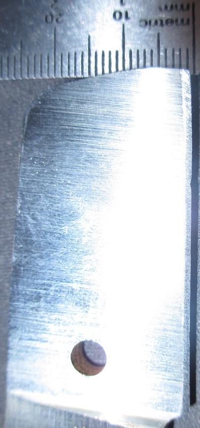

After saw your zt0180 edge after cutting a nail, I was curious about my SQ 52100 strength & toughness.
Spec:
52100 super quenched; 61rc; sharpened 20dps with 0.025"(0.64mm) behind edge thickness.
Cut a 16d size nail into 6 pieces. 1 cinder block cut. And cut 1 small rock.

Close up pic of edge (at the end of the video)
Thoughts/assessment?

There are a couple of things a little different. I don't know exactly how much difference they would make. Your blade is sharpened at 40 degrees inclusive, the ZT was sharpened at 32 degrees. The spine and primary bevel look a little thicker on yours. I don't know what kind of nail I tried cutting through but it took harder shots without splitting until the hammer broke. I also placed a small piece of 2x4 between the hammer and the spine to prevent the dings from the hammer on the spine. I don't know of cutting a piece of a cinder block is any easier or harder than trying to cut at a full block.
Having said that, your edge looks like it took less damage than the ZT. ZT also cannot really hit a superb heat treat regimen doing them in large numbers without really jacking the costs up.

Short of long story - I end up with 1/4" instead of 3/16" thick test knives (zt0180 is 0.2" thick). For this test spine thickness isn't a factor. However 20dps edge wedge is 25% more stout than 16dps, so damage depth would be at least proportionally less with obtuse angle. A direct hammer strike against the spine is most effective however a few strong strike on 62+rc spine can have nasty result -- umm that was how my test knife went from 4.2" to 2" blade. Oh, what is your zt0180 behind-edge-thickness?
Cinder block cutting (off camera tests before video) is easy in whole or chunk form. After 1/4"-1/3" cut depth, wedging take over. Initiate the cut is when most damaging to an edge. In video, a glanced off cut to a rock - putting a lot of lateral load, which would inflict heavy damage for a less strong & tough edge.
I will thin out this test stubby knife spine to 1/8" thick and sharpen with 15dps with 0.02" edge thick. Then see how it holds up against nail.

Based on your picture, at 480p, the edge damage to yours looks in line with the ZT, although bodog put his knife through a lot more rigor, at least I gather that from his decriptions above of hand fatigue etc from the amount of chopping and cutting he performed, while your test was done in a ~6 minute video -
Here is a screen cap of your damage closeup since your attachment is not displaying for me -
Your process looks to have provided a good hardness as well - thanks for the video.

Edge bevel does looks bad, but dark spots were mostly granite smeared. Here is the edge shown at the end of the video
edited to add: This 6 minutes video was shot, right after I did a 25+ minutes video. Actually you can hear my slightly winded breathing. That 25+m vid contains too many brain dead oopsies to post.
