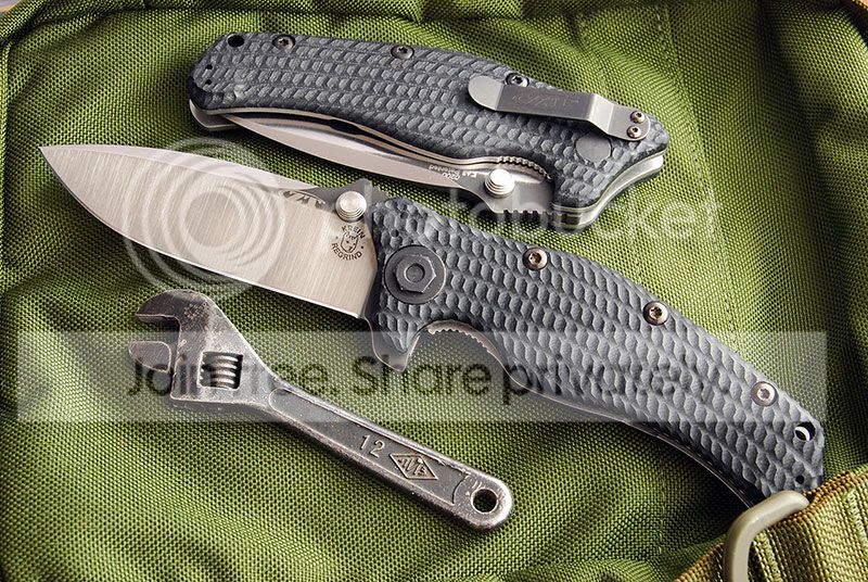

Buy a black or DLC version ans send it out for a regrind. You will get the satin finish and an two-tone appearance. They look great.

Is this a DLC after the regrind? VERY nice looking. I have no clue what the cost and wait time would be for something like that.
That is a black/DLC after regrind. You can still see some of the black remaining around the ZT logo.
Contact RazorEdgeKnives or Krein Regrind. I'm sure they can fill you in.
Good things usually don't come cheap or fast. But if you can get it factory, this is an option; a better option in my opinion.
