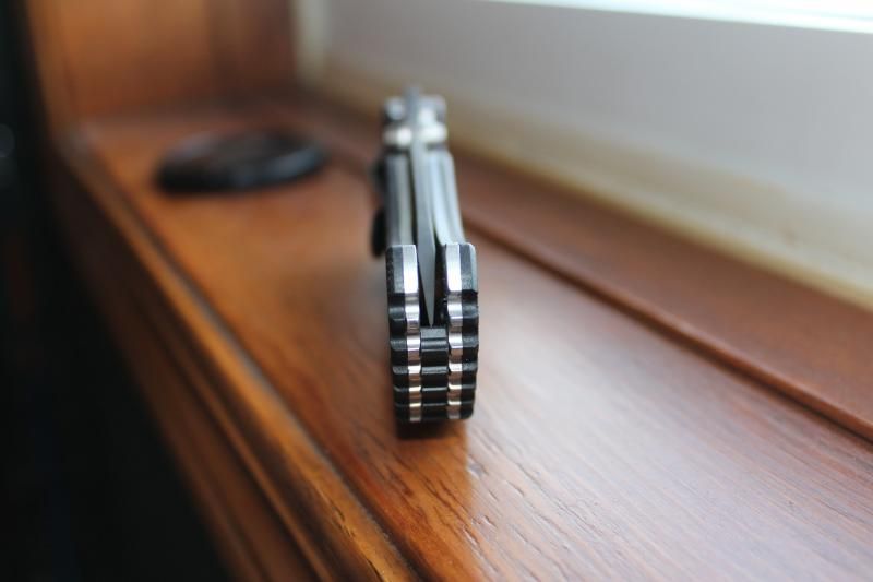

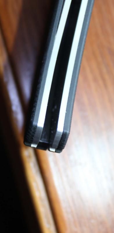

I will be adjusting the screws later tonight, thanks for the advice guys. Here are a couple pictures(I don't have a macro lens). Blade is a little off center and blade touches handle when shut.
In this pic you can make out where it has been scratching after being closed maybe 10 times.

Is the blade hitting the back spacer as well as being off center? If it's hitting the back spacer, then simply adjusting the screws might not fix your problem 100%.
Yes the blade is hitting the back spacer. The only time it does not hit back spacer is when it is very lightly closed. The blade tip rests on the back spacer when fully closed.

I never owned a 350, but generally, a blade shouldn't be hitting its own back spacer. I'd recommend an exchange over a self-fix.
I had a 350 and it was also off center. Ironic that a ZT has such bad tolerances, apparently :D
What I did was adjust the pivot until I found the "sweet spot". One thing you could look at doing is to adjust the lock tension. I have had many a knife where the lock put too much force on the blade, pushing it off center. A slight adjustment to the tension goes a long way (but be careful, too much adjustment and your lock won't work too well). Luckily the liners are steel, so you can do it by hand.
I've had few ZT's and I've been happy with them except for the 350. I had the same problems: blade offcenter (my suspicion is the linerlock pushing it too much(?)) and the blade hitting the backspacer.
I will second this. Out my 6 ZT's, only the 350 had any blade alignment problems. In my knifes case they were not severe enough to cause unwanted mechanical contact between blade and other parts of the knife so no adjustment was needed. But the tip of the blade is clearly off a bit. Still pretty happy with the knife.
If my 350 was misaligned that badly I would return it for repair. A $20 folder is one thing. A $150 ZT needs to be held to a higher standard.
