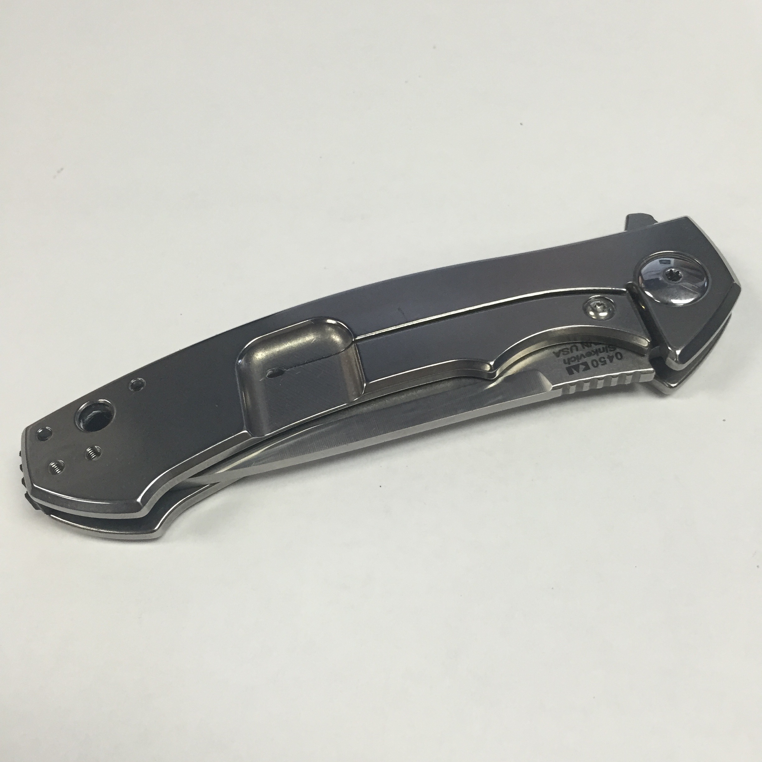

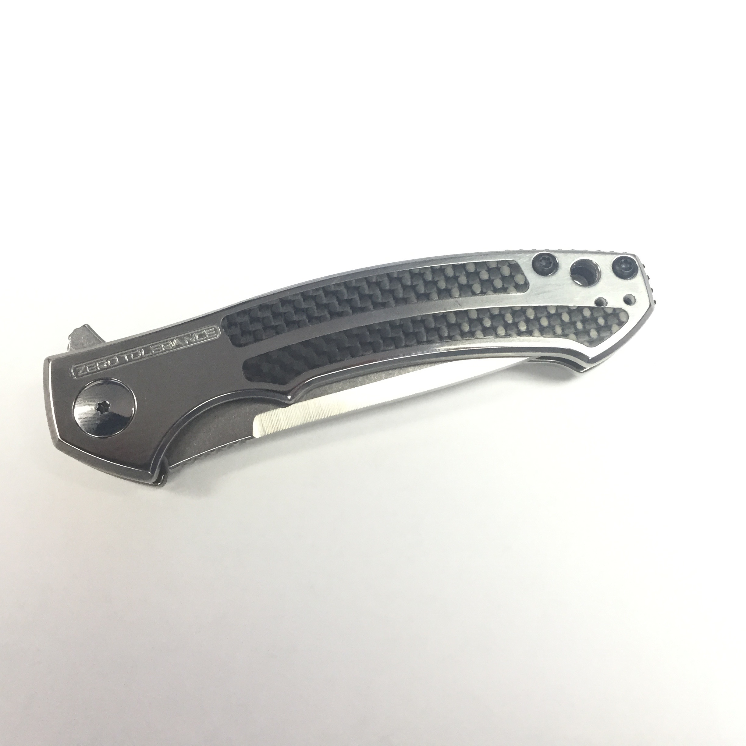

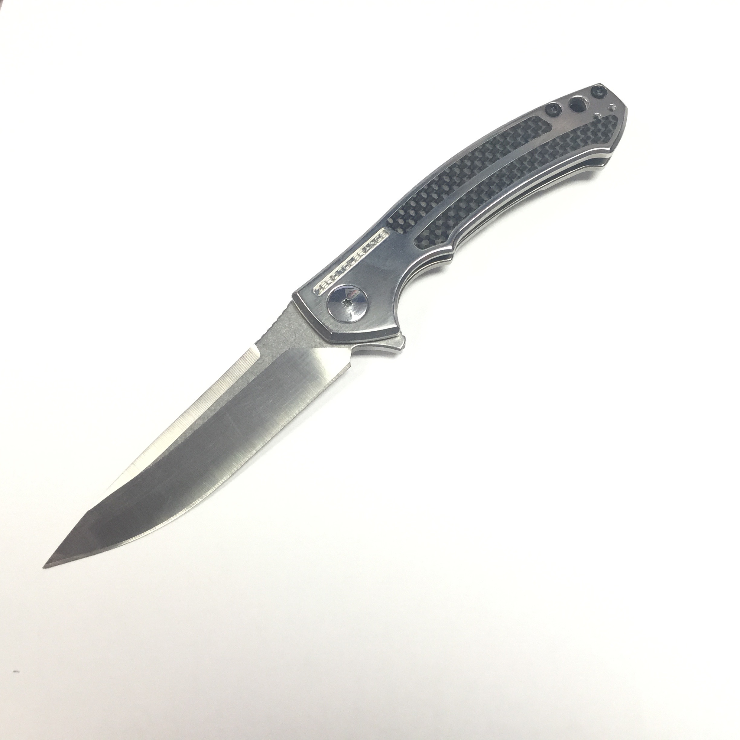

Hey Gang
Here's something we've been working on at the shop -
Here's a Carbon Fiber Inlay on the ZT-0450.
Feedback appreciated
Cheers
Chris

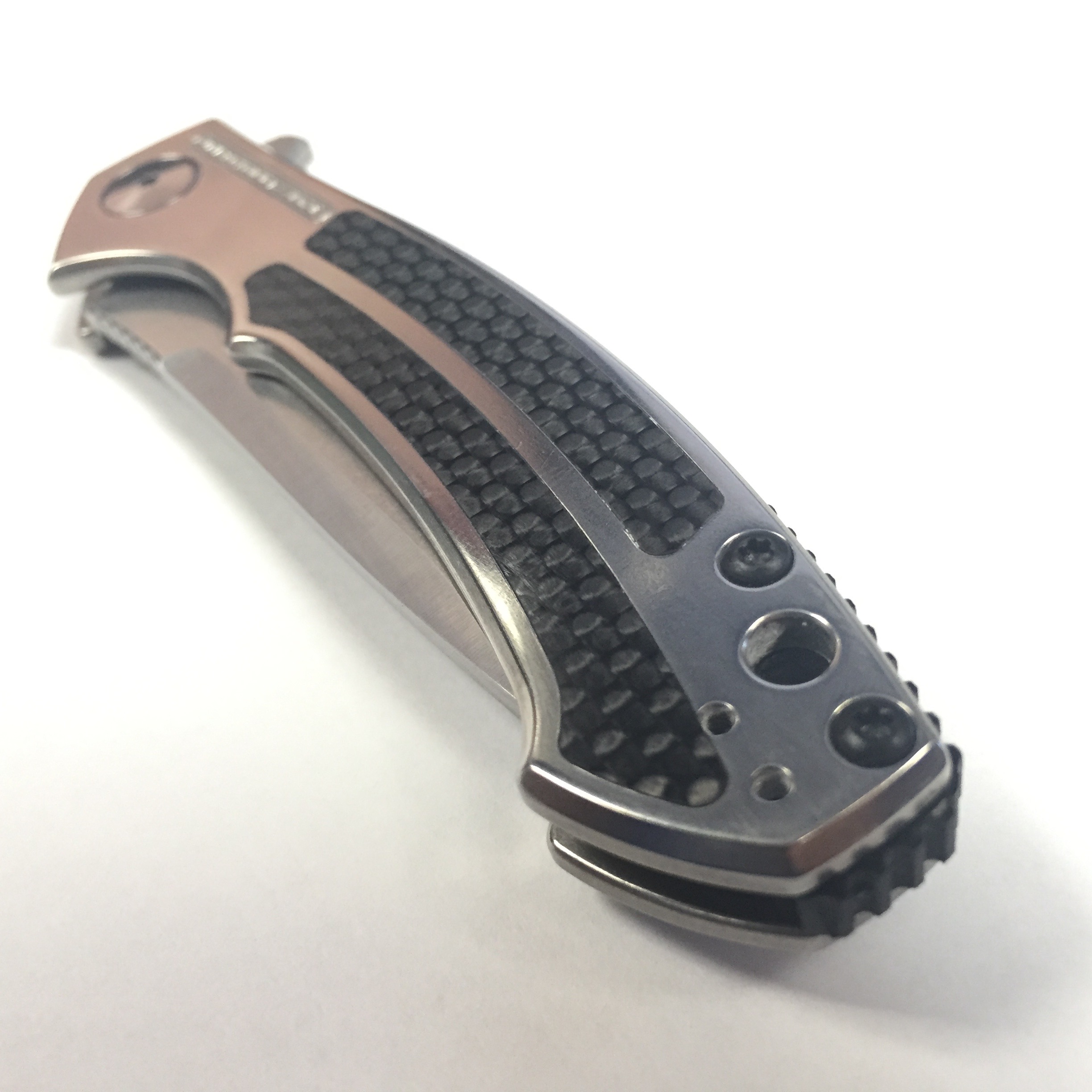

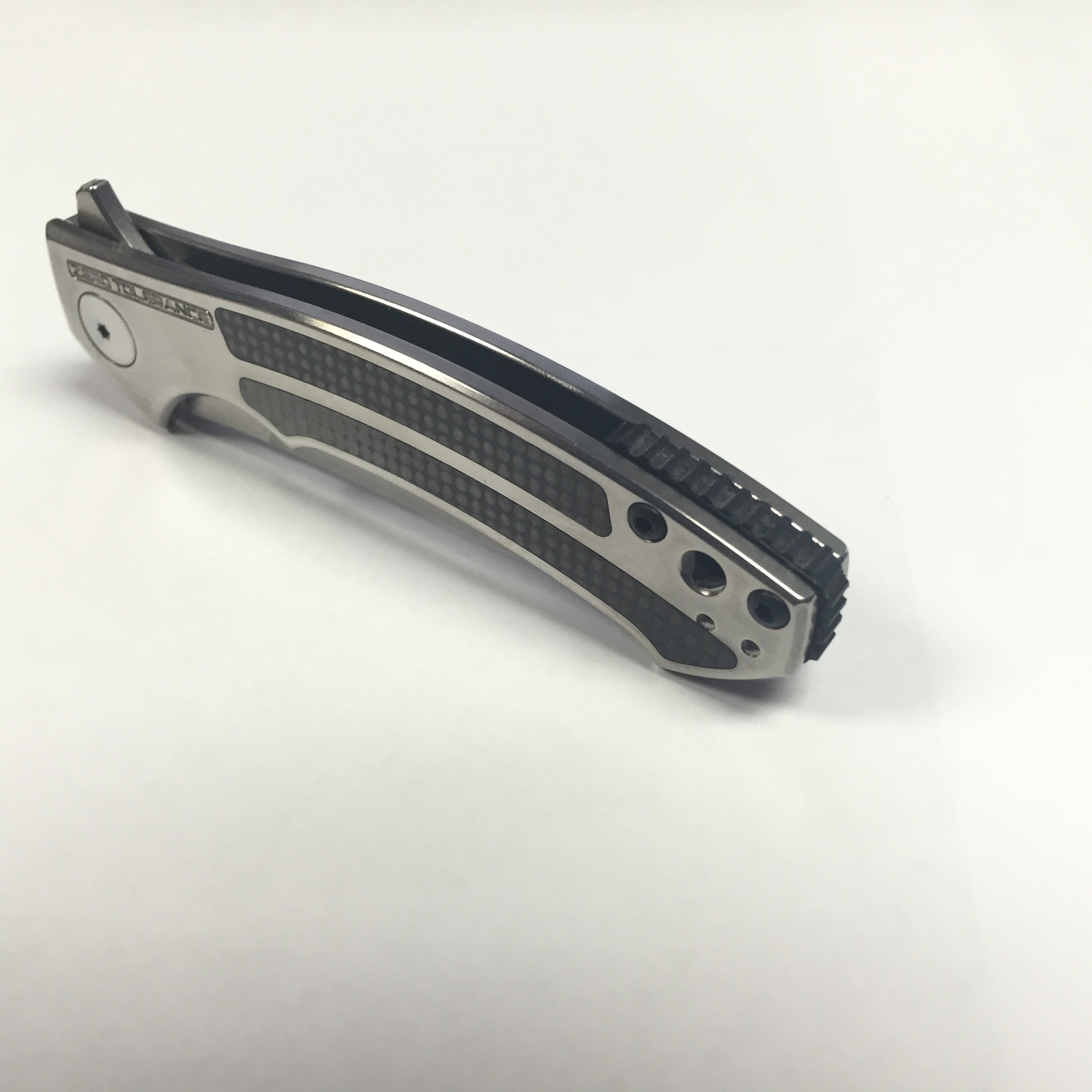

Can't tell in the photos but is the inlay flush with the scales?
Yes. This pockets were milled to the thickness of the inlays, 0.03125 (1/32) and then epoxied in.
I consider this one a bit of a goof.
1. The bottom inlay hits the pocket clip hole on the handle side.
2. There was a tiny bit too much epoxy in the front side, so i had to do a little sanding. This ended up making the carbon fiber layer inconsistent. I will be more careful next time with the epoxy.
