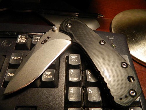

Just was not thrilled with the scale on this knife. Rough on the pocket IMO. Counter bored the screw holes so that the head of the screws would sit a little lower then when new. Had to shorten the screws a little since the scale is now thinner. Also had to take a little off the pivot bushing to center the blade when closed, since I counter bored that hole also. Kind of looks like carbon fiber now. Bit of a change.

It was fun and I am pleased with the result. Was thinking to add a few undercut lines but have not decided on a pattern.
