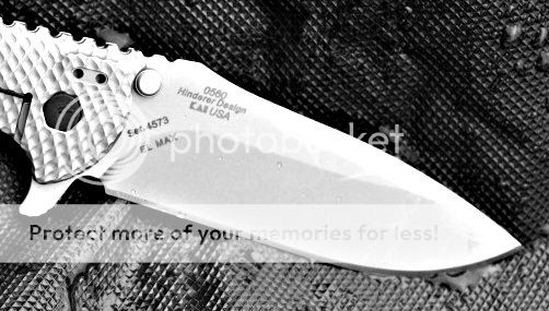

Mine is the same. #4573
I kinda like it.

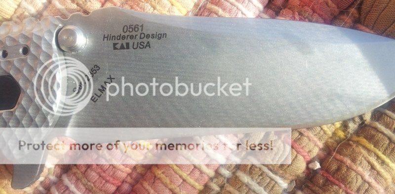

Interesting. I am assuming that American made Kershaws and ZT's are made in the same factories sometimes, or at least using the same equipment? I have a labeling flawed Kershaw too, except this is a double stamp. Different problem, different cause, but same general thing, who ever is doing the type setting and the stamping, apparently there is room for error(scary in a weapons manufacturing facility), along with with the fact that QA either definitely doesn't look at every knife, or they do and don't care about the stamps? In my Kershaw, almost impossible to miss, but for a $75 mass produced blade I don't guess I would expect every one to be looked at. For the 560's though, I would, and after looking at so many with the curved ELMAX stamp with no space, it should stick out like a sore thumb I would think! And how/why would someone change the "stamper"... maybe because they were running the new Carbon Fiber 560's through and they have a straight stamp???!?!!, If so, SWEEEET, been waaaaaaiting for that bad boy, no one even taking pre-orders yet though :/. Cannot think of another explanation except for maint or breakdown and and someone screwing up putting it back together(doubtful, or I pray doubtful!). Anyone have a 560 with a higher number than the ones posted here that is the old way again again? Or perhaps this is just the new way instead of an error?
Below is my error, and here is the same exact blade being reviewed so you can see it from other angles (got it from from eBay, who got it from a guy here in the Exchange, who got it from Nutn I guess): http://www.youtube.com/watch?v=ZpJ1UmeveFY, I have never seen another double stamped like it, and i have looked, most of them(all the new ones) don't even have the stamp anymore, the few I found that did weren't double stamped. My dad has been a numismatist for like 40 years, and double strikes and other minting errors on currency makes it worth a hell of a lot more, dunno if that translates to blades, but considering how mach some of the mint errors released are worth relative to their face value (even errors produced in the hundreds of thousands are 10,000 times or more than their face value), I would assume that there is collectibility factor for released factory errors NOT marked as blems for blades? Same thing when I collected baseball cards, ERROR cards(misspellings, wrong pictures, stats, etc.), were ALSO worth a fortune if corrected early, or the corrected ones valuable if corrected late. According to Google same thing with stamps, this one is worth almost a million, and 100 of them were made!!!
Point is, it seems that everything else i know of that is collectible where some relatively small subset is released with errors is much more valuable, I don't see why it shouldn't be the same with blades, but I couldn't find any evidence of that in Google, I guess blade collecting isn't main stream enough?
Is there any precedence for factory errors not blemed in production knives making them more collectible that anyone knows of? I couldn't find any, but if there is, good excuse for me to buy another 560 :). My current one is serial# 2897, and is the curved, no space ELMAX stamp.

The doublestruck Kershaw:

ZT and Kershaw are both made in the same factory. The markings are not stamped they are laser engraved. They have a number of lasers. One that has a number of fixtures and spins to engrave several in a batch. The knife is fully assembled when it goes to the laser and sits in a fixture. [Thanks Jimmer for showing me this stuff! Hope it is okay to post some very general details about it!] The lasers are all run by computers and have a configuration template file that specifies how they should be marked.
My guess is that they set up a laser that didn't have that template yet and the font was missing and in a high volume production setting you just roll with another one. The space may have been a mistyped space or may be bad kerning in that font that didn't appear with other words/combinations of letters. The double marked maybe got left in accidentally and partially remarked before the person running the laser caught this and it was packaged by mistake. Sometimes that stuff happens... have you ever typed up 100 pages and not hit a single wrong key? Little mistakes happen in any industry. I'd rather see the occasional minor error go out than each knife cost $1200 due to the costs involved to catch every tiny tiny error. KAI has the best customer service in the industry and they far more than make up for any issues with their willingness to go above and beyond for the customer. That is not only a better investment for them, it is far better for the consumer in the long run.
Since little things like this don't inhibit use nobody cares on a regular production model. With limited production models that people are collecting people generally don't want any noticeable issues and the value is usually decreased slightly. The only time I've seen an error increase the value is with the 0550 run that had Elmax blades but that was more than just a cosmetic change. I don't know how much that has increased value since I've been unable to find one for sale and Jimw451 is the only one that has said so publicly. Typically value is not changed.
Errors with stamps and money impact their use. There is the problem of automation with image scanning for stamps and money in vending machines but I think the bigger concern is that any sort of blemishes potentially indicate counterfeits and that is quite important so they are careful to make sure even tiny errors aren't ciruclated. For baseball cards and the like you aren't really using them and they are designed to be looked at and collected. Without that, they are just a piece of paper. Knives are primarily designed for use and as tools so those sorts of things don't have a lot of impact on the value. Even limited edition models are often not seen as collectible by everyone and we all cry a bit inside when we see someone laser engrave a biohazard symbol on a limited model knife or someone that thinks their super rare knife is improved by grinding an Emerson wave in to the blade.
