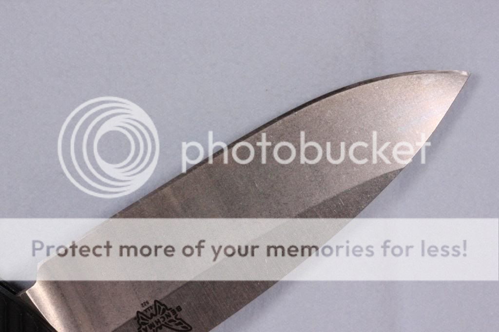

I would like to sharpen a ZT0561 on my wicked edge. I've heard so much great stuff about the steel. I have been very impressed with Kershaw and ZT steels in general. If someone will pay shipping I'll be glad to put a hair splitting edge on their ZT0551. User or new. I'll take off very little metal and put a very nice edge on it. Here is an example of my work:
