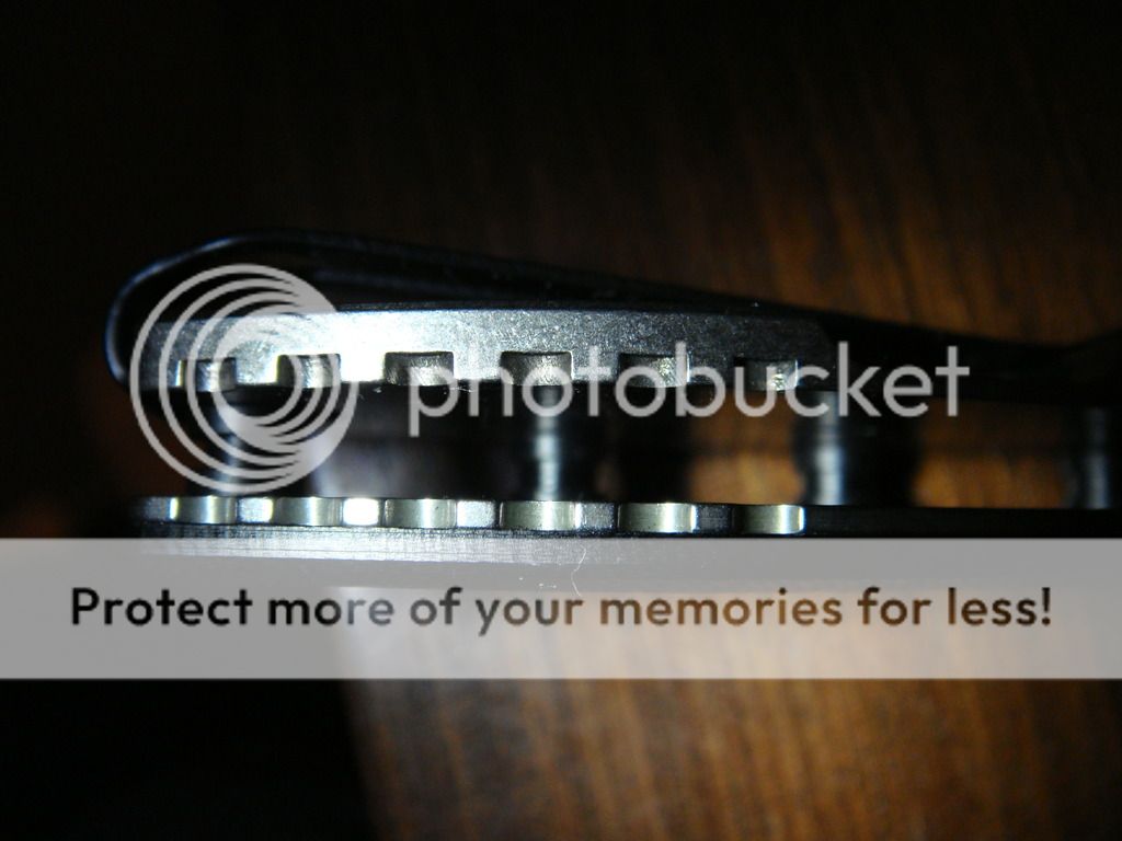

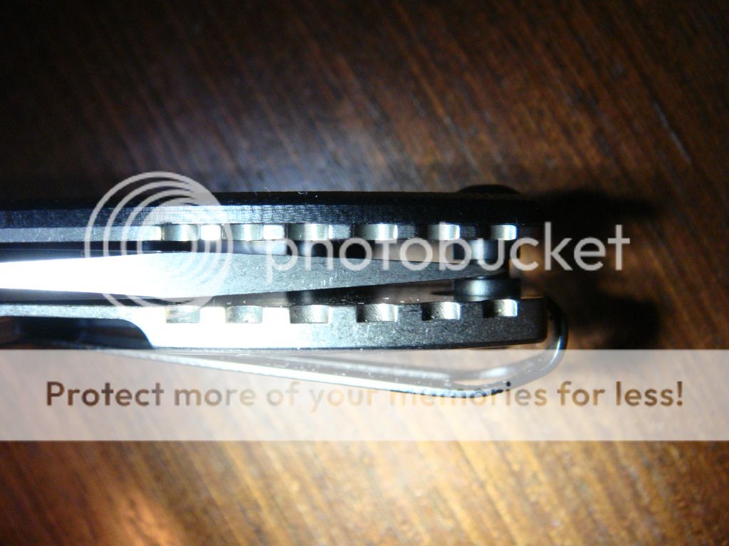

Hello,
Im new to knives and decided to get something good as i needed something reliable for my volunteering (SES in Australia)
So I purchased a ZT 0562 and the price was quite good. When I saw it in my hands it looked and felt like the real thing. Smooth opening, the titanium part is non magnetic and it had all the right letters for model and serial number.
The seller had bought a few from a store that went bankrupt from a liquidated auction and he was sure they are original.
Ive been trying to look online for high quality photos but couldn't find anything.

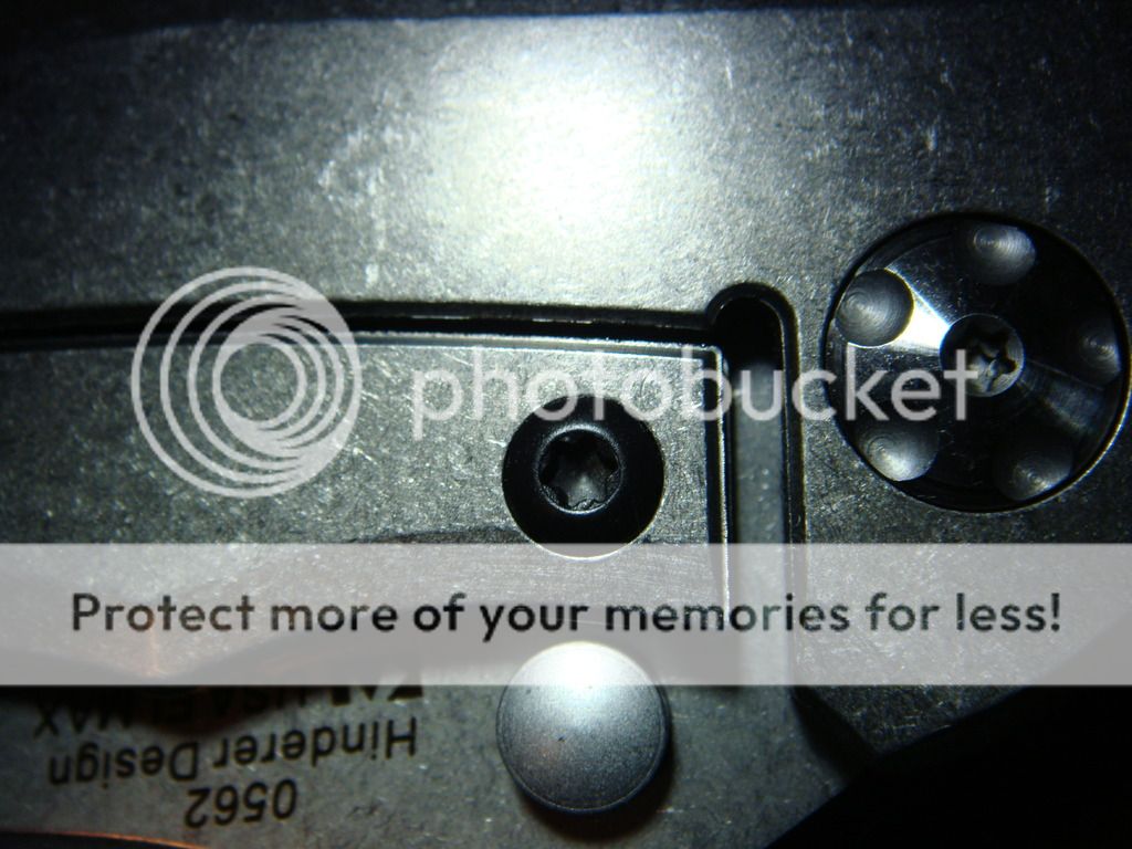

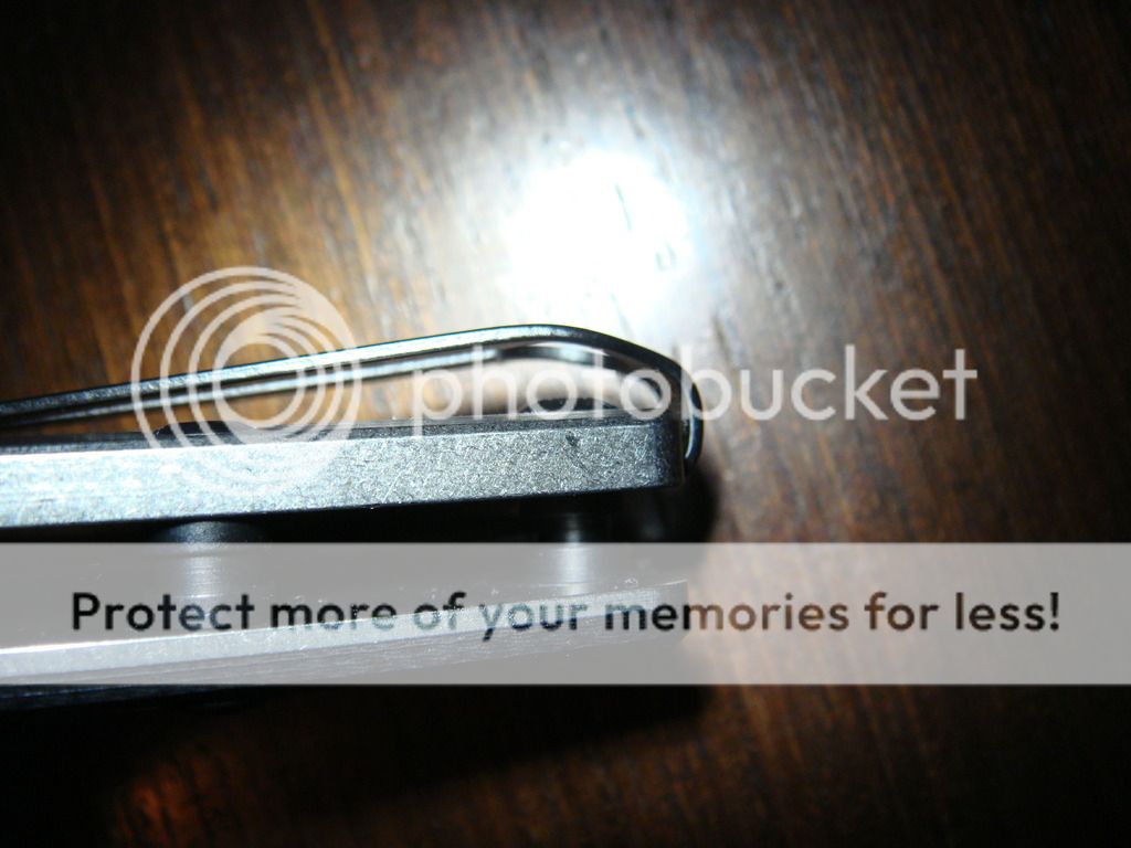

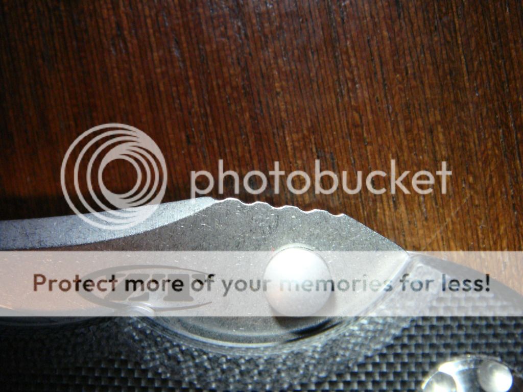

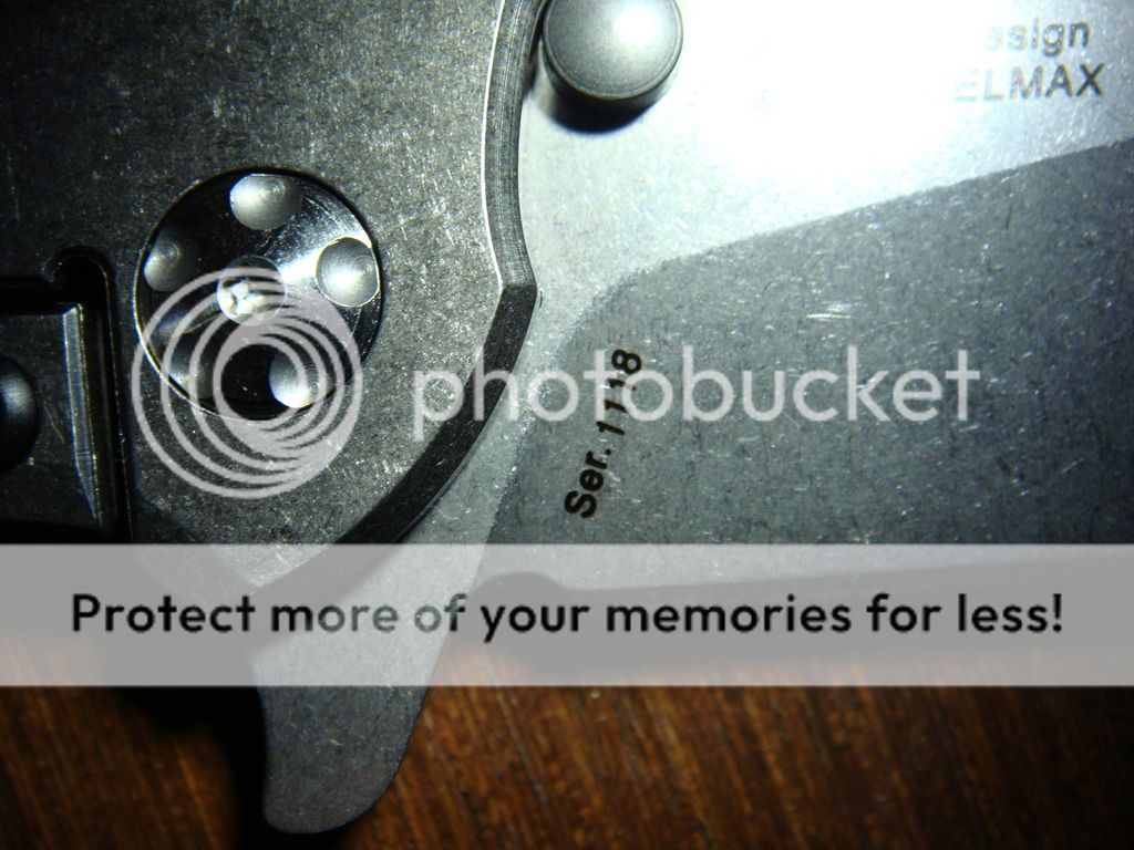

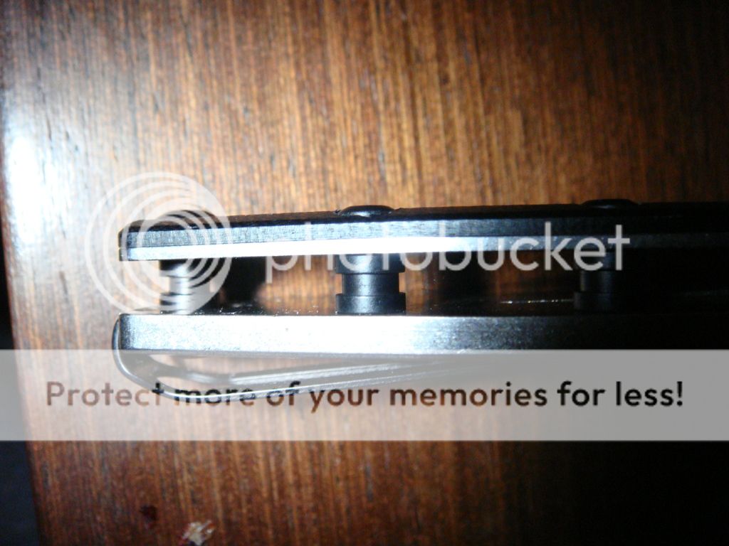

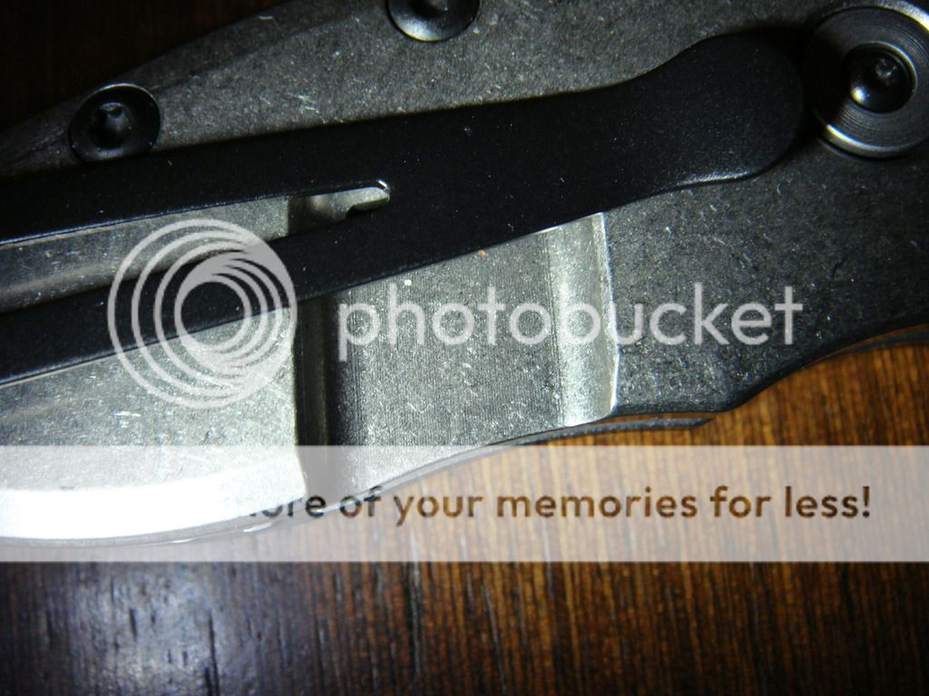

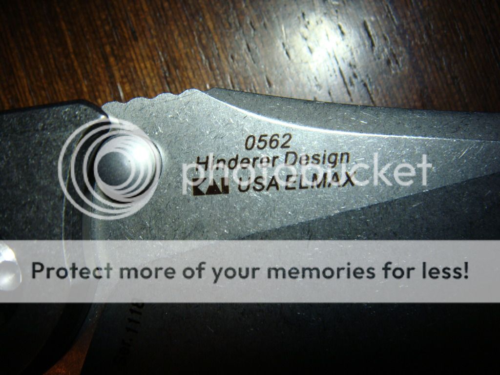

Ive taken a few close ups of mine and i would appreciate if you could compare to yours.

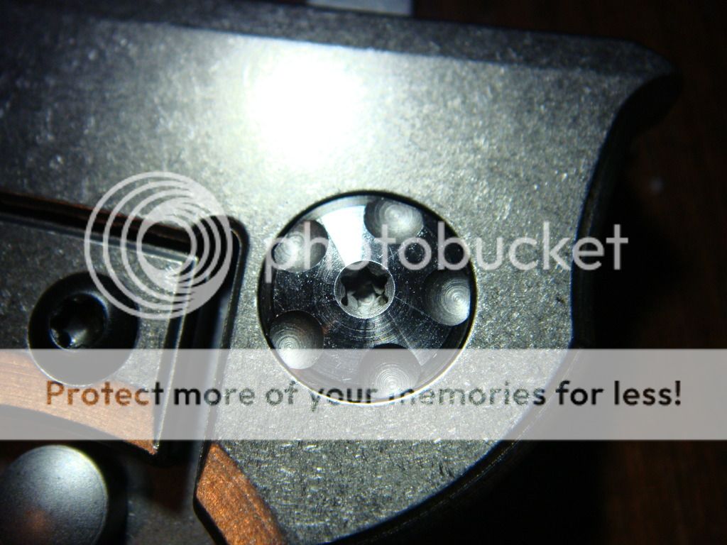

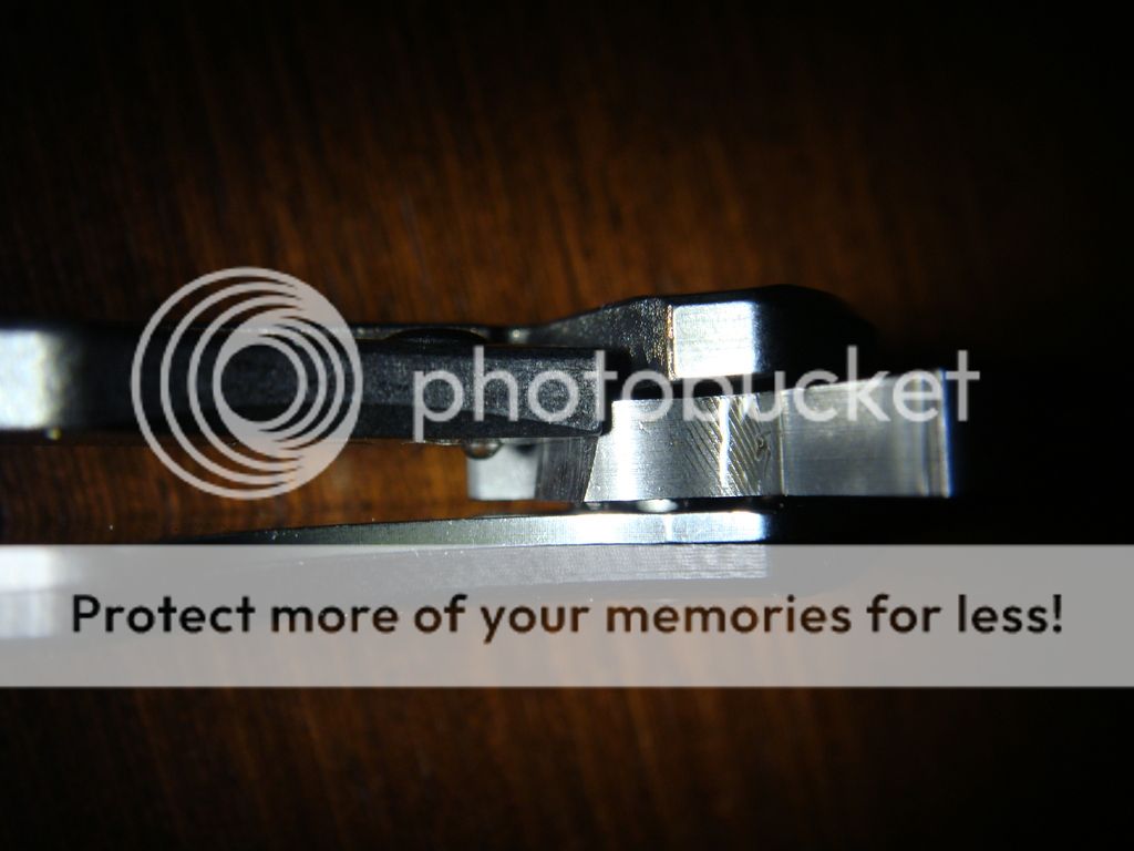

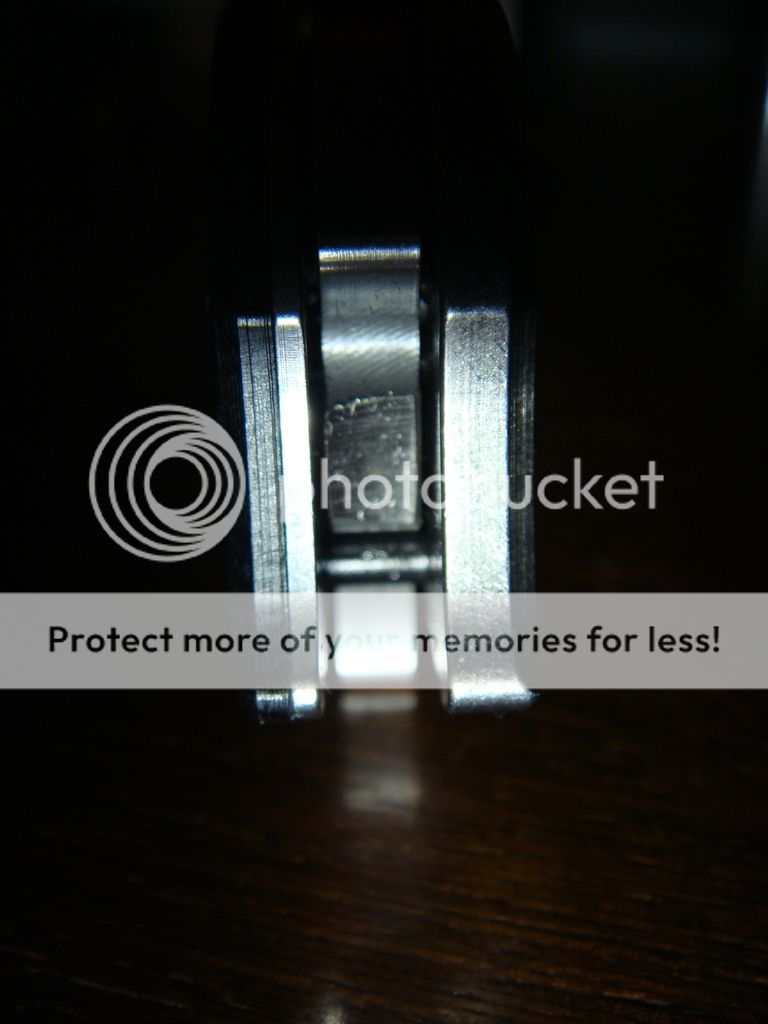

A few things to note that I'm skeptical is:
- The stopper, mine is rounded top while some say the real are machines and tapered.
- The main bolt that holds the blade. On mine you can see a triangular pattern of machining. From original its smooth?
- The groove under the pocket clip. The fake has a better CNC finish than the original.
- Locking mechanism seems to have a bit of a "ladder" detent around the circumference
Things to pay attention:
- The screws protrude over the body, so its not flush
- The 6 half cycles at the pocket clip, if you compare right and left side, they aren't perfectly the same diameters
- The pillar on the body (3 of them) are slightly different to the pillar that holds the pocket clip in place
Please see below and if you can point anything wrong let me know. If you need any clearer/closer photo also let me know. Cause if its fake I will then return the knife for refund.

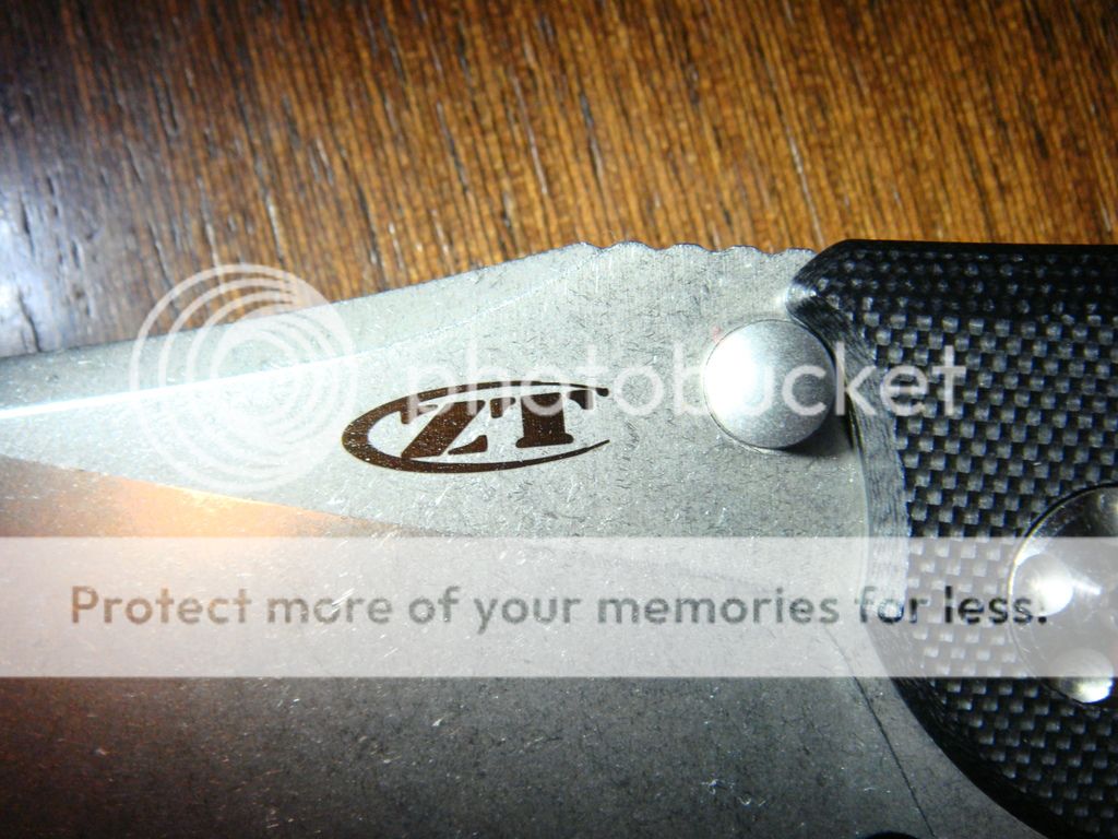

Hey mate, that definitely looks like a fake. Did you buy this from Jamess2895 on eBay AU? he is selling a lot of fake ZT's passing them off as authentic, and you should report him to eBay. He probably imports fakes from China and sells it as 'authentic' in Australia.
Return it right away.
Dead giveaways:
-bad laser etching of ZT logo
-bladestops' mill work is off
-pivot screw very rough and unfinished
-standoffs size differencs

There are differences that are hard to see at first. I had my 0562 out while looking at the pics. At first i was like yea its real but a second look has me suspect. Zt logo is not straight. Standoffs are not the same size. Metal finishes are off
Wow I thought it seemed legit. That's kinda scary considering that the 562 is a pretty popular and common knife. I would have just chalked the finish differences to a bad day at the factory because I have had a few legit ZTs that had less perfect finishes.
The first thing I noticed was the box serial # doesn't match the knife serial #..
I took my 562 out to compare and I can name something that's different in every picture. Big time fake.
