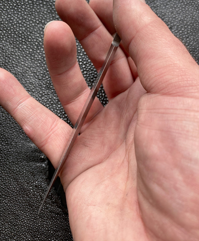

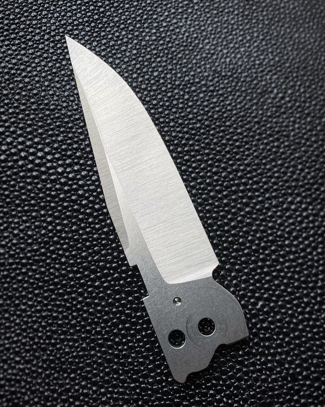

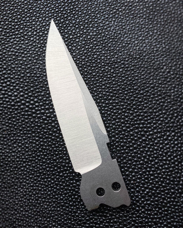

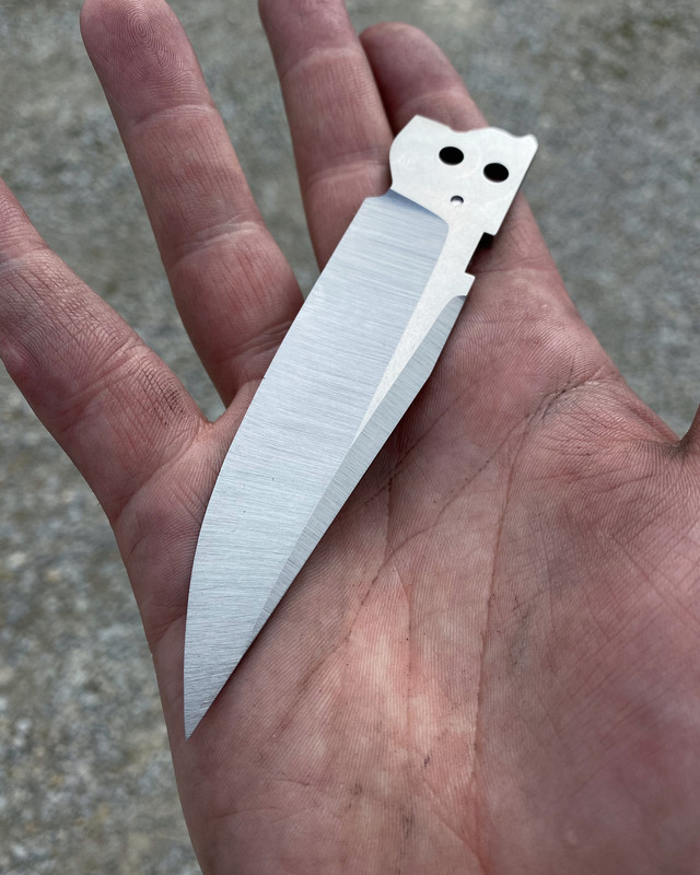

Yup, the other side is even better in that regard. I just told him to thin it out and make sure to get all the text. I don't have a proper tool to measure and I haven't reprofiled it yet, but it's "near zero" for sure.
Successful Sunday sanity project. I reground this Zero Tolerance 0640, the first folder I’ve attempted and only the third regrind I’ve done. I love this knife, but the grind was too thick and clunky. I gave it a nice deep hollow grind that is super slicey, and hollow ground the swedge to be deeper and longer as well. I need to measure the BTE thickness but it should be around .010”.
