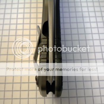

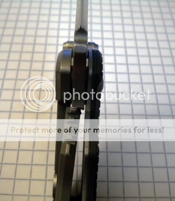

I've also noticed that if I put a decent amount (not a ton) of pressure on the spine the blade moves forward slightly even when holding the lock, none of my other Ti frames do this and I'm wondering if anyone else has or had this and if it ever went away. My 302 had a similar issue but it fixed over time and now when I grip that knife the blade doesn't budge and my SNG is the same. I really hope the lock is still setting.
Yes I know all the tips and tricks for fixing lockup on framelocks. The pivot is tightened, blade is centered, I bent the lockbar inward more to strengthen the detent and help put more pressure on the tang. Yet there's still slight bladeplay, everything is telling me that the lock is still setting but I'm uncertain because I've already owned this knife for quite sometime (my SNG broke in faster) and have opened it well over a thousand times.

You can see that the lock bar has moved over more than 50% yet only a small section of the bar touches the tang which leads me to think that the lock is still setting. Yet people say they have less than 50% and no blade play. Really don't want to mail this in unless I absolutely need to.

it really looks like there is just to much mismatch of the lockbar face angle, to the engagement face on the blade. I have many frame locks most have a better surface match/contact looks like this on is hitting on the corner of the lockbar. I'd send it in you only stand to get a better knife. just an observation
