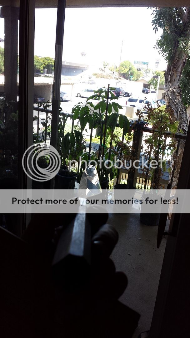

I figured I would stop by and say "awesome edge!" and tell you that you inspired me to whip out my retired Lansky and put a 2000grit edge on my SnG. I wish I had the supplies to achieve a bright, mirror finish.
Vanity edges ftw! :)
Nice shine!
Mine doesnt come out as mirrored, but im freehand.
