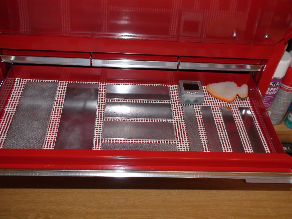

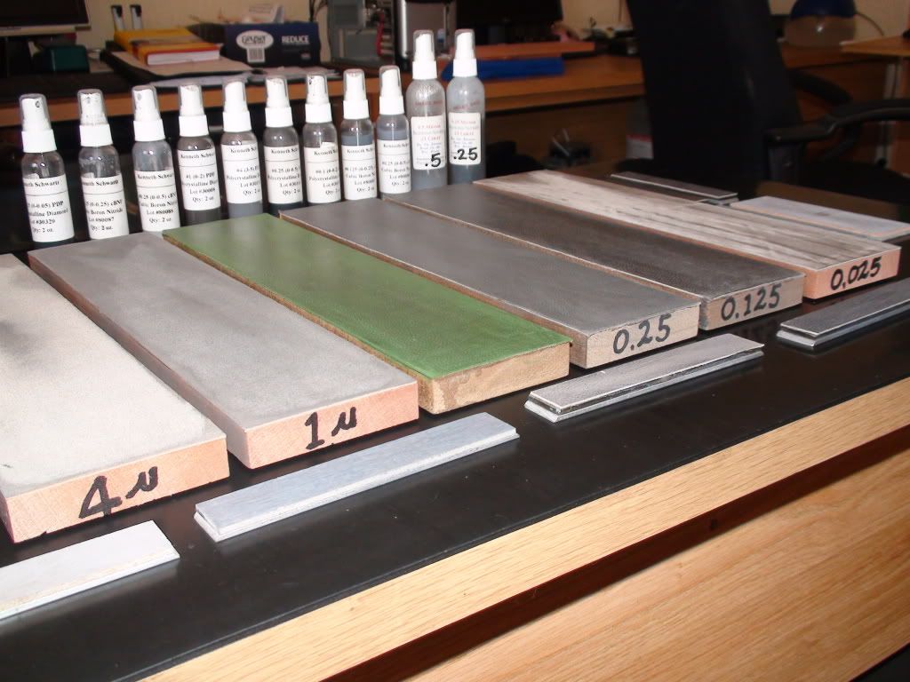

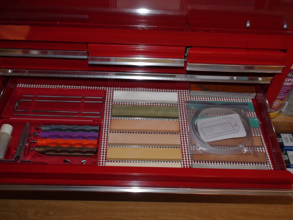

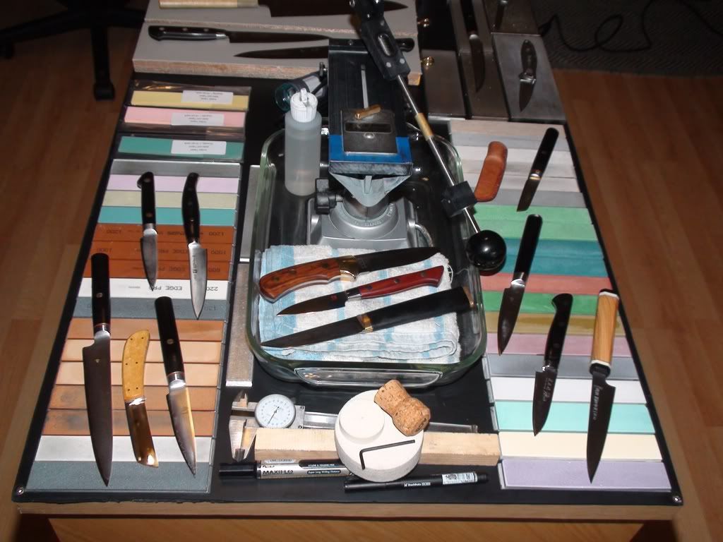

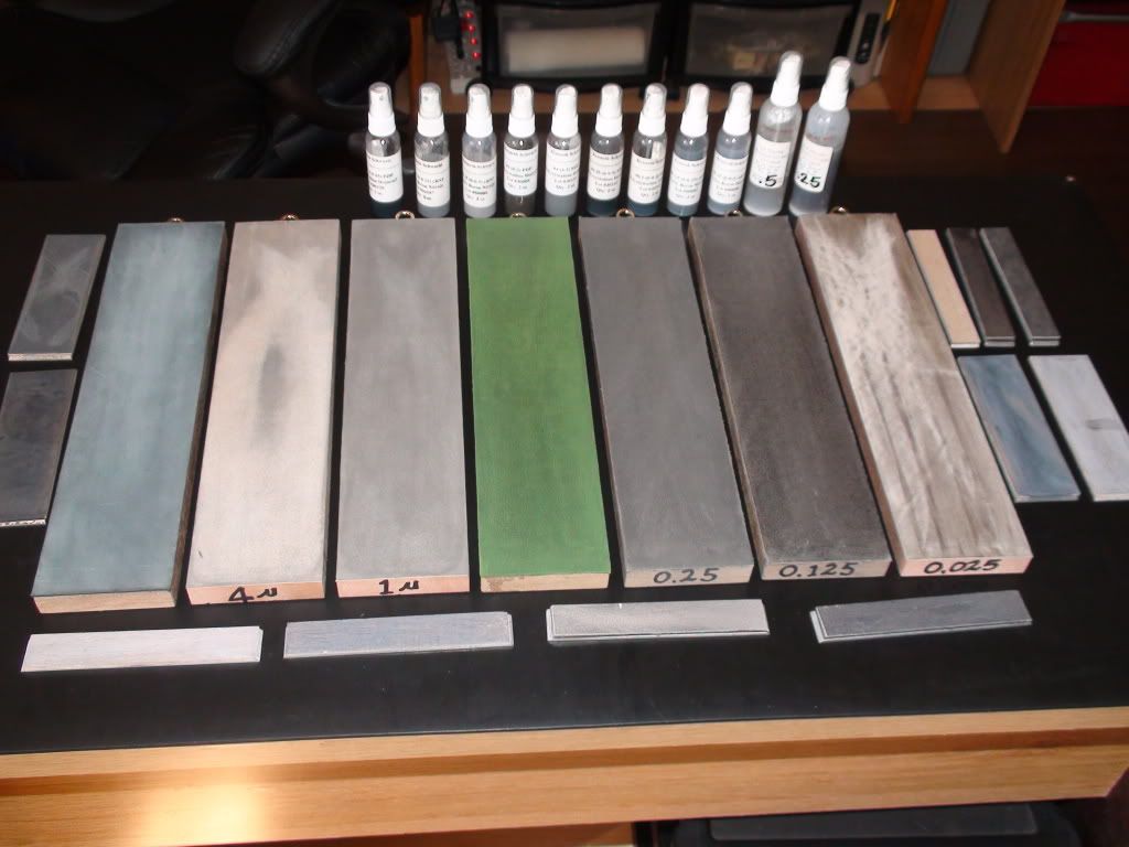

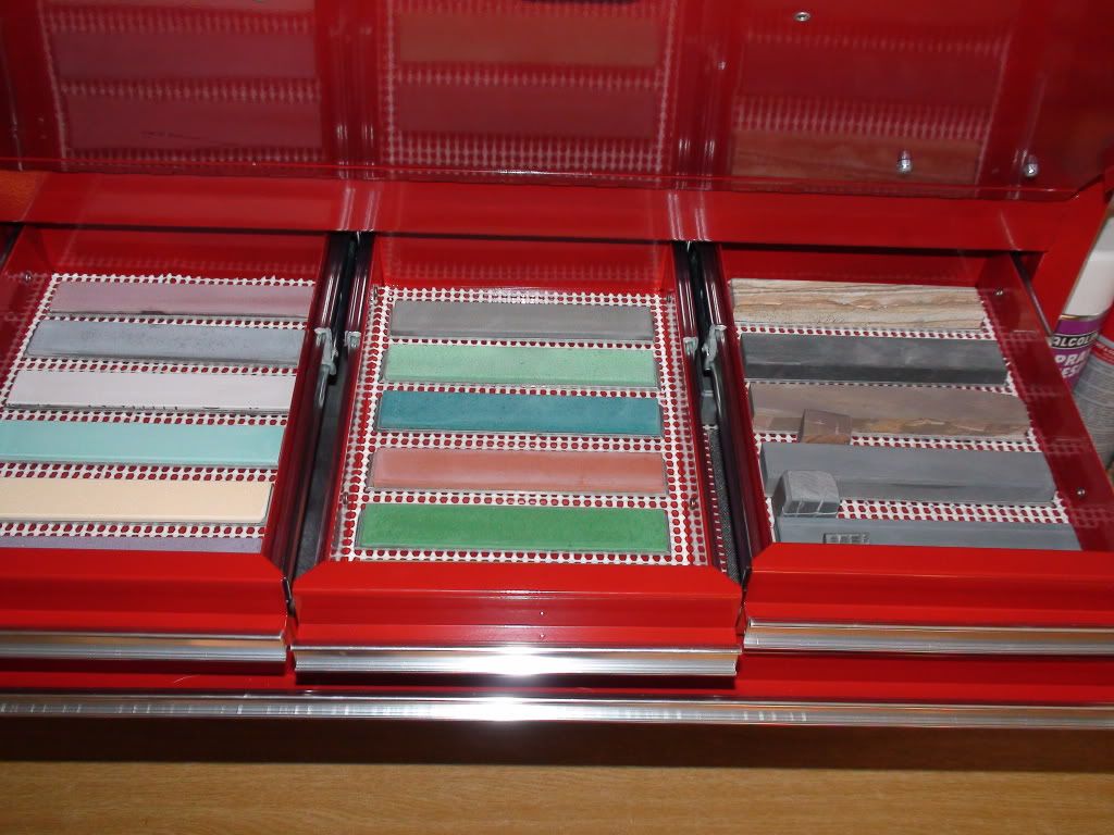

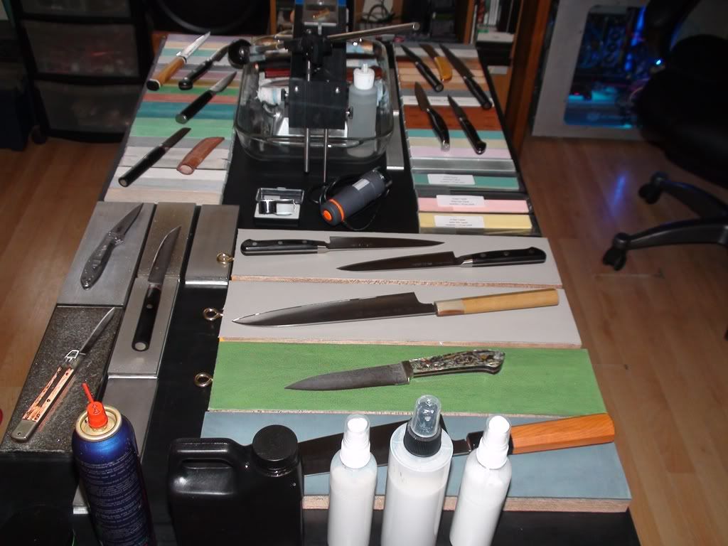

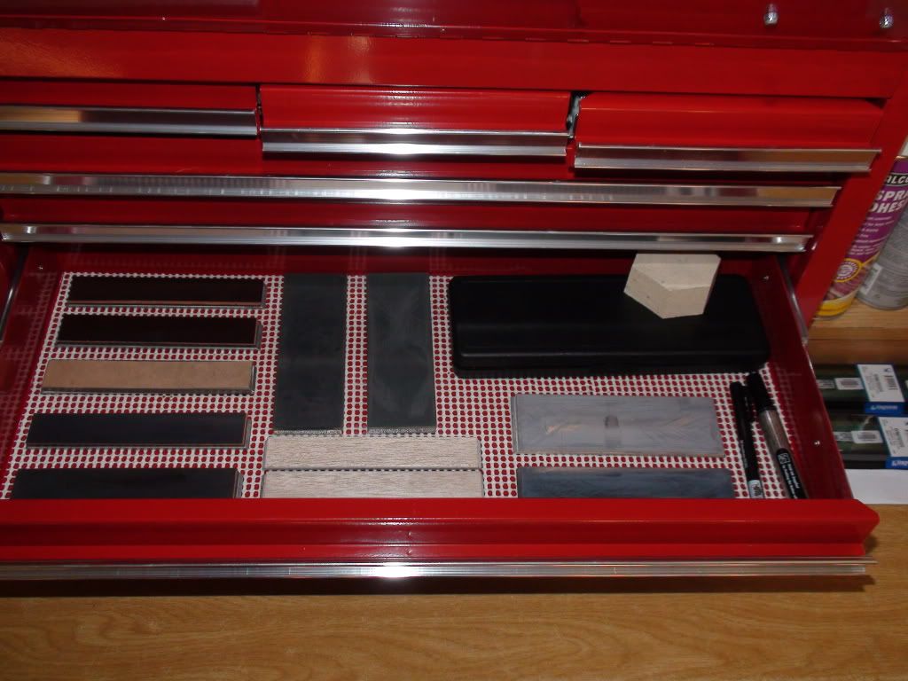

I was an avid Lansky user many moons ago - just could not justify the price of an EP Pro - eventually took the plunge and over the years have collected & collected etc....
Here is some pics of some years back - time to update it I reckon:

I freehand strop my blades as maintenance between physical stone sharpening - this could last up to 6 months, depending on severity of use.
I might just add that I strop any blade used during the day, at the end of the day - it's like my evening coffee/rum - routine - works well.
Nice edge! I still watch your stop collar vid everytime before I get out the EP.:thumbup:
