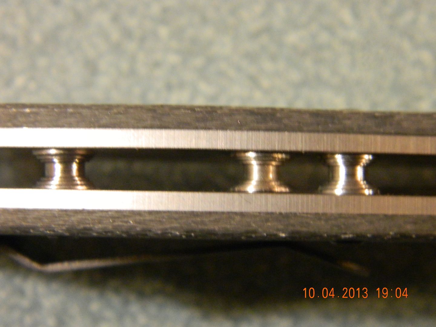

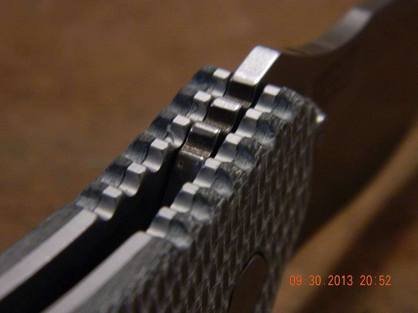

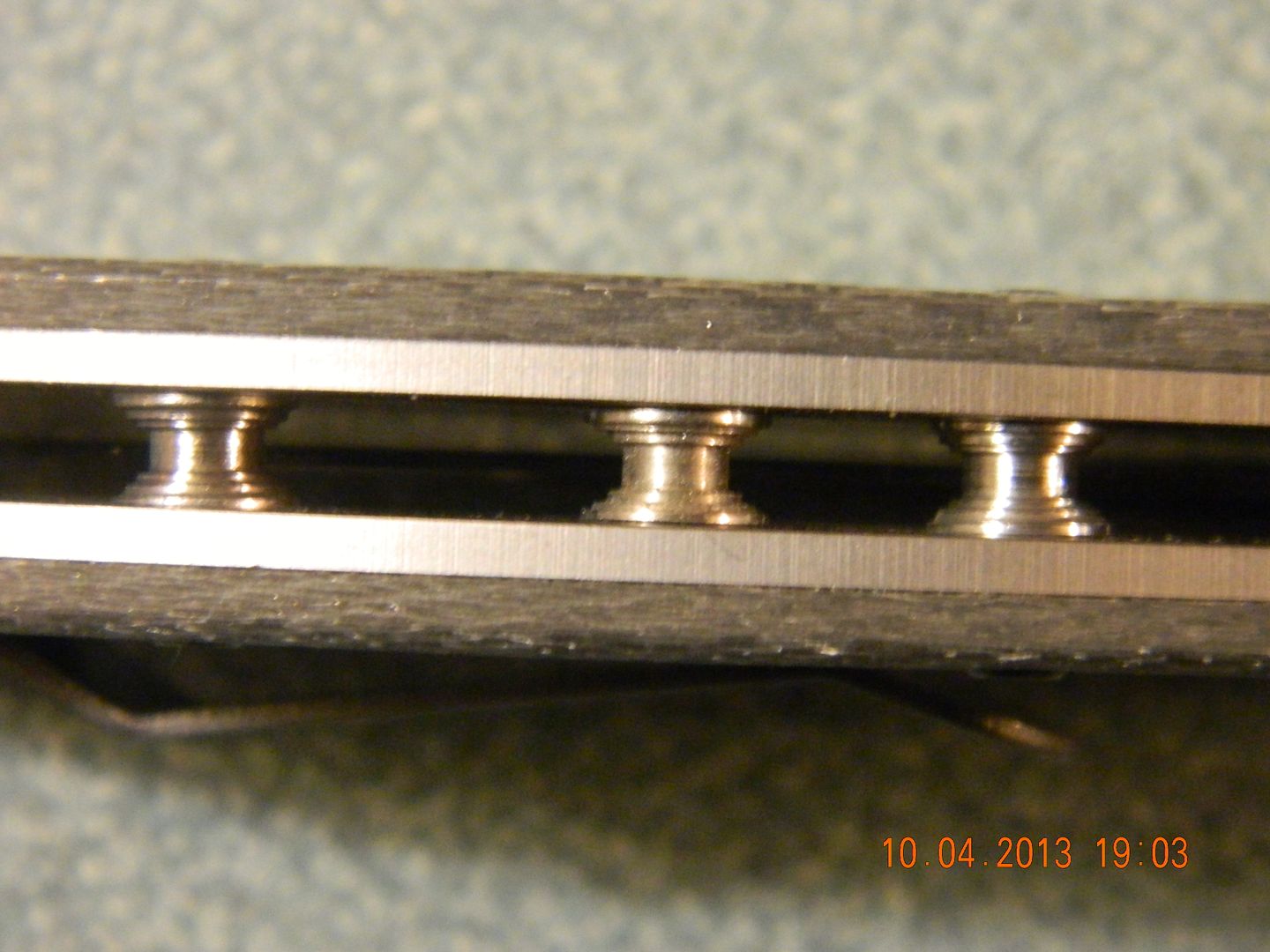

I put some standoffs on mine.
That's right, the back spacer is gone
Check it out!
Works perfectly.
Three are stationary, one moves with the torsion bar.
With the blade open
With the blade closed
Excellent work on both the CF scales and standoffs. Where did you get the the standoffs and what size is required?
Thank you.
I got the standoffs from an on line knife supply co. that sells knife kits.
A .150" standoff is required.
They did not have any.
So, I bought a larger size and modified them to fit.
