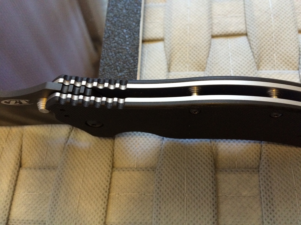

Zt0350 standoffs fixed centering on deassisted
Nov 26, 2015
4
Deassisted my 350, which I would recommend doing by the way, as many members have suggested it turns it into a much more enjoyable knife. The only problem was it was impossible to recenter, no trick or tweaking could get it centered, no matter what I did with all the bolts tweaking and flexing...it always came back to having to tighten the pivot so tight the blade would barely move....saw these standoffs that another member used on his, which look awesome IMO because the machining matches the thumb studs and looks custom for the knife. They happened to be .156 wide, which ended up being .004 wider than the stock spacer....it canted the liners just right to be perfectly centered and allowed the pivot to work buttery smooth. Heck without them and with the pivot adjusted like this the blade was actually rubbing before..although mine would never center nice even before I deassisted it so maybe I got a bunk knife....doesn't matter now it's perfect and awesome...now time to make some scales, just received 8 slabs of g10 and Micarta
