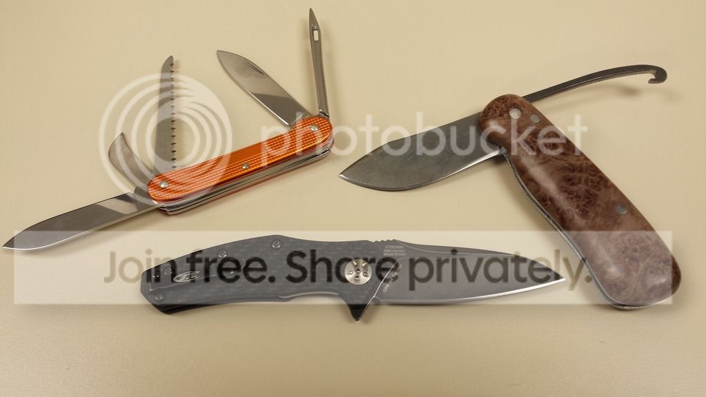

Had you have been watching the fans of ZT thread recently, you would have seen my slightly modded 770cfM4.
I pulled the blade out and let it soak in Hydrogen Peroxide for 1 1/2 - 2 hours, then hit it with 600 grit wet/dry under running water so I could see how far I was going. I polished up the highs and used the DLC as an impromptu black wash.
Then used the 600 to touch up the edge then off to my strop and this is what I had when I stopped:
(Pardon the SAK and the Becker 11.5 friction folder)
Yes Bill, I saw that and have a healthy dose of envy going right now. The good kind of course ;) I do not like coating and your method is better than keeping it stock imo. Thanks for sharing and your willingness to explain just how you did it. Looks great.
Thanks Trav lol This is a nice surprise to find out about today.
