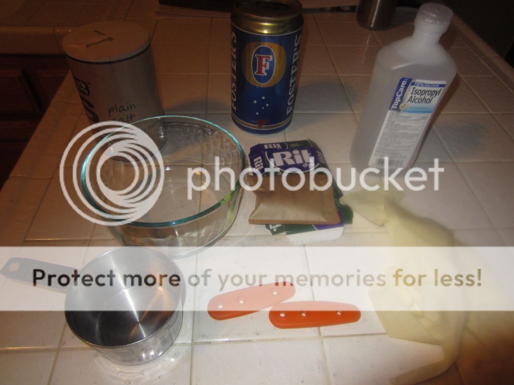

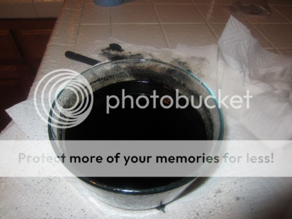

I used concentrated Dark Green RIT dye mixed from powder on my orange zytel scales, here's how they turned out:
Keep in mind though that I wanted to get these closer to green. They ended up being more like a smoky purple or something. I actually love them, turned out to be a happy accident, but keep that in mind heh. I could've used more diluted dye or left them in for less time to have a less dramatic effect, didn't know at the time.
Tip: Make sure you wipe down the scales with rubbing alcohol before dying so that you don't leave any oils from your fingers or whatever on the scales. It will make them dye unevenly. Have fun!

Heads up when I tried to dye mine a darker brown using "dark brown" RIT liquid dye they came out with a green hue to them so you might not want to use a brown if your desired result is brown.
