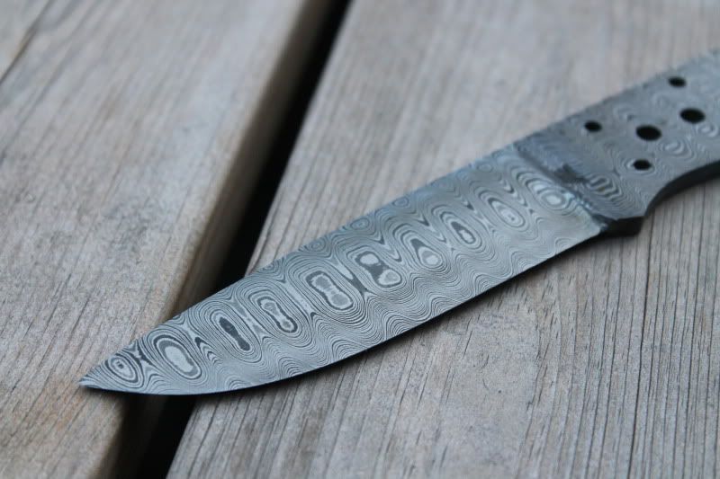

I scuffed up my Alabama Damascus Hiking Buddy getting some small spots off any suggestions how to polish the blade again?
If you want to bring out the damascus pattern I have had good luck using some Birchwood Casey Perma Blue paste.
Red wine vinegar also brings out damascus patterns.
This blade was all shiny with no visible pattern after I ground the full convex. Left it in vinegar for a while to get it to look like this.

Any vinegar will work to etch high carbon damascus and showcase the pattern. It's usually done before installing the handle slabs, but can be done after the fact with care. Another product that works faster is ferric chloride (sold at Radio Shack as "board etchant"). It's sold full strength and has to be diluted 4-1 with distilled water to use this way. With either vinegar of ferric the steel has to be free of any oil or grease to get an even etch. I use acetone to get it super clean. When clean, immerse the blade in the vinegar or ferric. With vinegar it can take 20mins. or more to get the effect you want, but ferric will do it in 30sec. or so. To speed things up with vinegar, heat the vinegar to almost boiling and then put the steel in it. The steel will get a dark gray/black coating pretty quickly, but a small area can be wiped with a clean paper towel so you can see how dark it's becoming. Using ferric can result in too much etch and a rough surface if left too long, so check it pretty quickly. When you have the amount of etch that's wanted, spray the blade with old style Windex (has ammonia) to stop the acid reaction. The black residue can be gently cleaned off with 0000steel wool and detergent. A light coat of oil helps set the etch as a finish. You can do the same thing on high carbon blades to force a uniform light gray patina which helps slow down any rust issues. It's also a quick way to show the transition line from an edge quench when using 10XX steels.
The bluing paste works well, too. Does give a little different look.
So whatcha think then Alabama Damascus Hiking Buddy etch or not?
Shane, that decision has to be made by you depending on what you like. Remember, too, it's not an irreversible process. If you don't like the results, it can be buffed back to original. I'm sure Andy can do that in his rehab set up.
