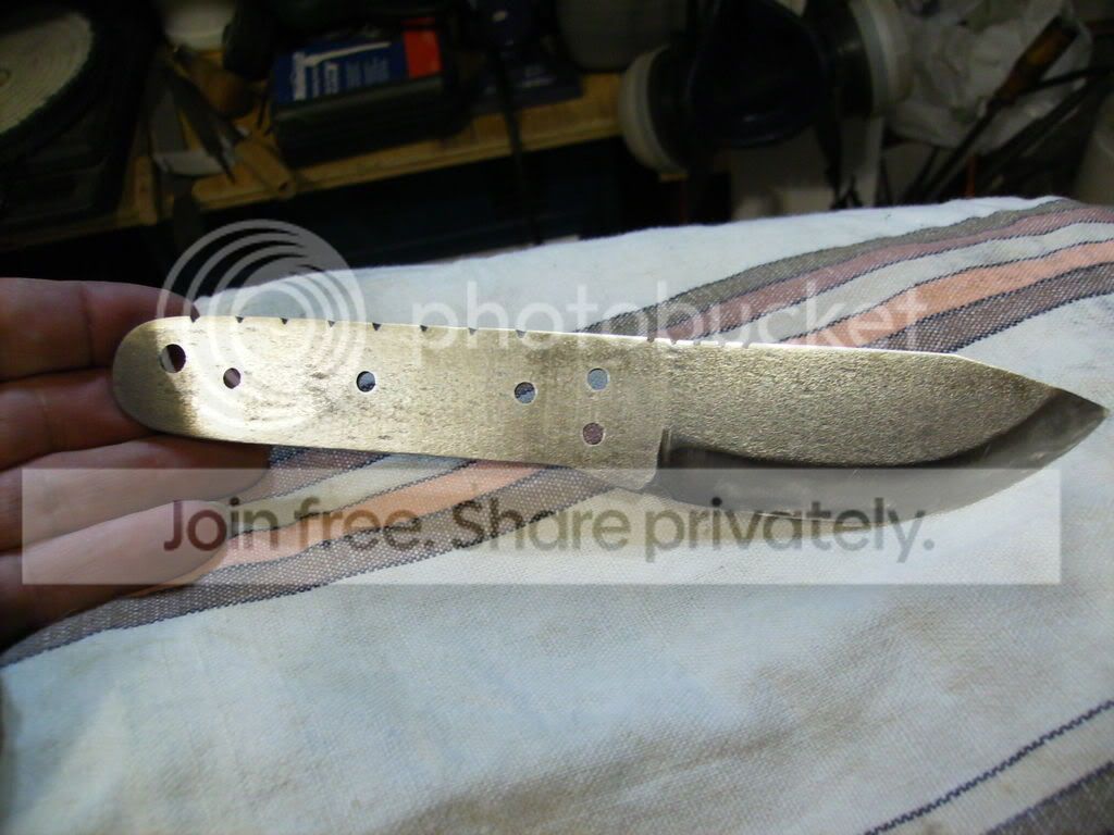

I would buy the cpm 154 precision ground, and send it out for heat treat. I would hand sand to 600 and buff and make it shine like a mirror. Then when you get it back there is very little left to do other than remove the scale and rebuff.Sharpening is the last thing done, as ive been taught.
OH and your gonna want to have all the holes drilled prior to heat treat. You wouldnt like trying to drill hardened CPM154 or 1080 for that matter.

REMEBER like Rusty said drill all holes first youll have a hell of a time after if at all . I just bought some cobalt drill bits they are suppose to drill hardened stainless .I tried to drill some ats 34 a while ago and could nt make a make let alone drill it with regular steel bits. kellyw
This one is near ready i had about another hour of sanding before it was done.
Carbide is for hardened stainless, cobalt are not much more than regular high speed bits. It gets expensive to buy drills for hardened steel, but nothing cuts a hole like carbide - one day you'll forget a hole and find out, unless you scrap the blade ;)
