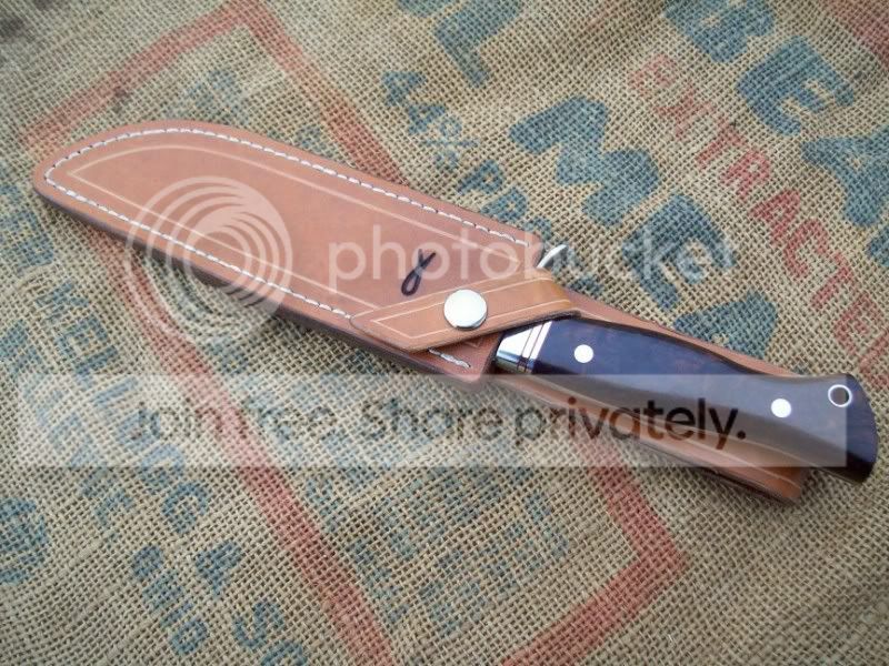

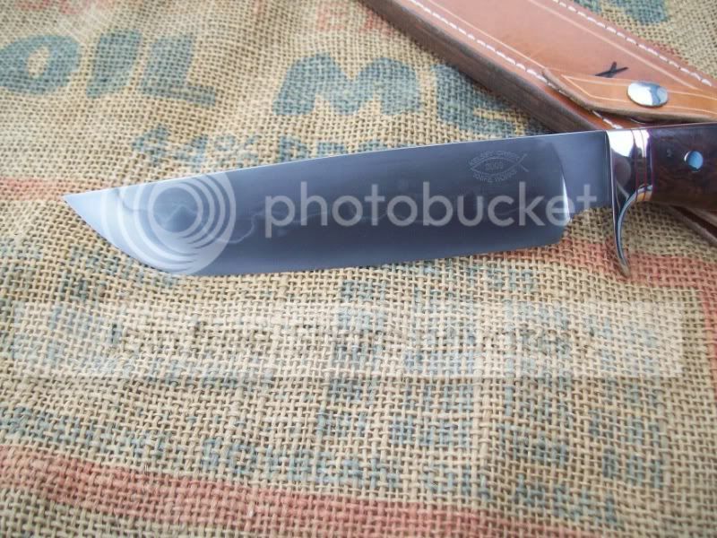

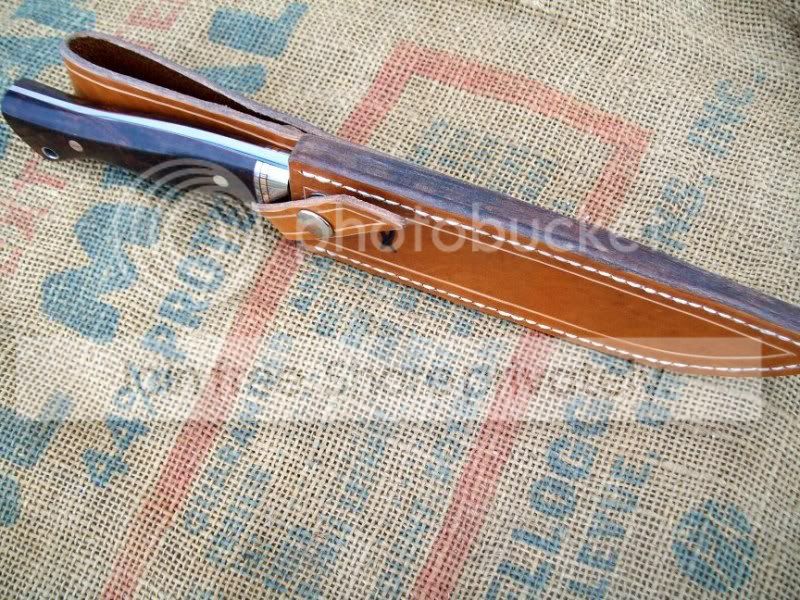

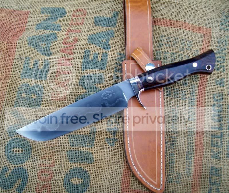

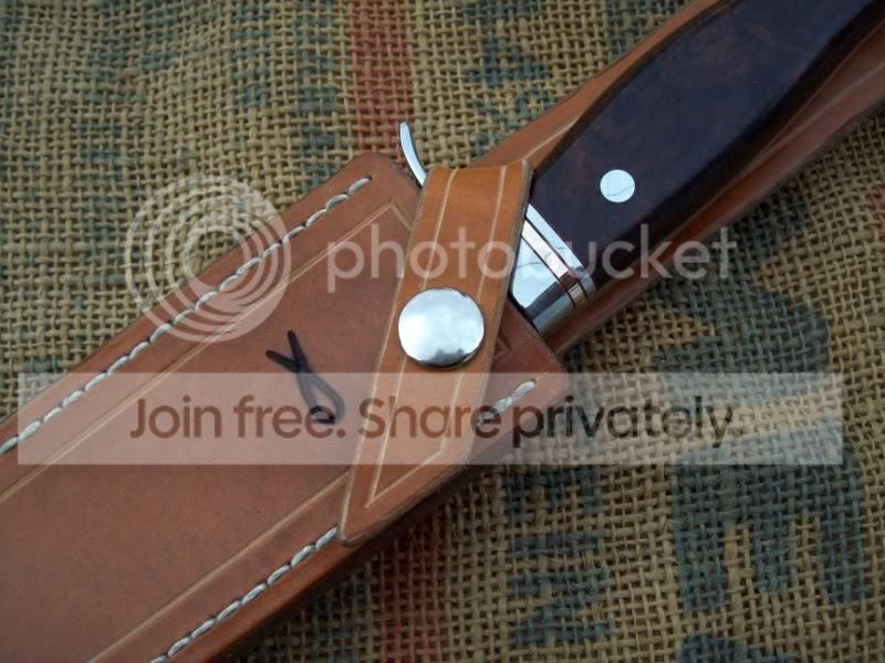

Due to circumstances beyond my control I haven't posted any of my work in months. I'm still kick'n ;)
Here's one I just finished up.
I forged the blade from Aldo's 1095.
OAL 12-3/8"
Blade length 7-7/16"
Heat Treat was 4 normalizing cycles after forging, then clay coated for hamon, austenitized at 1480*F w/~15 minute soak, quenched in Parks #50. Tempered @ 425* F 1-1/2 hrs x 2, it came in @ ~ 60+ HRC. It has a full tapered tang, a soldered & pinned 416 stainless guard, a 655 silicon bronze spacer with a few .010 red spacers in between. Handle scales are Arizona Desert Ironwood backed with a .010 red liner. Handle pins & lanyard tube are also stainless.
I made the sheath from Weaver 9-10 oz. veg tanned leather. My wife Joanna has been doing the hand sewing on my sheaths lately. Pretty nice job too ;)
Hope you like her : )
