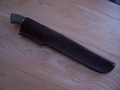

What better steel for a hard working knife than the spring properties of 1095. However there is still the always present danger of rust and stain in the high carbon steels. To help prevent this I have found that a controlled rust process using mustard and gun blue will give a knife a protective patina. Not rust proof but a very helpful preventative.
3/16 1095 steel
Hollow ground
"Aged" finish using mustard and gun blue
Overall length: 13 1/2 inches
Blade: 8 5/8 inches
Handle material is green micarta
Hand sewn leather scabbard
-------------SOLD--------------
$155 delivered to the US or Canada. Paypal (gldrewknives@yahoo.com) or money order accepted.
