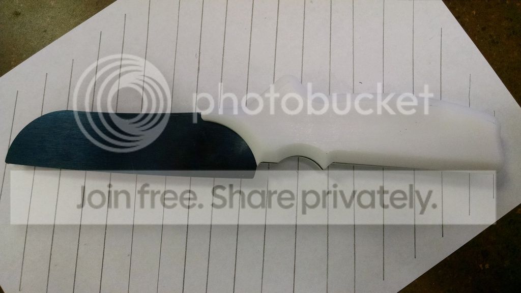

Once again thanks to all. Well I went for it this weekend. Like Davek14 I have a friend with a laser and another with a water jet for the handles. I went with the Santoku shape because I felt it fitted the material and the intended use. Handles are Delrin and they are just sitting in place for the picture because I haven't put an edge on the blade yet but I've got plenty to practice on because we cut out six. We cut out three 1/4 inch holes in the tang so that the handles can be internally pinned. I think it looks OK now we'll see if we can make it cut something.

I would think that a laser cutter screw up the heat treatment in the heat affected zone(?).

Well thanks again. I guess I'm going to have to learn some new tricks here. I thought photo bucket was something you threw your used flash bulbs in. I'll figure that out later tonight. You know the metal along the cut sure looks good. Didn't even seem to scorch the bluing but if it turns out to be a problem I'll water jet the blade as well. What characteristic of the metal would you expect to see or not see once I attempt to put an edge on if the temper has been degraded?

That's a pretty slick looking knife, sharpen it up and cut some cardboard, see if it holds an edge
Compare the performance against a carbone Opinel or Green River or Old Hickory or ... My guess is that your knife will need more frequent sharpening. Sharpen it several times before making a judgement as any damage might only be skin deep. Let us know what you discover.
