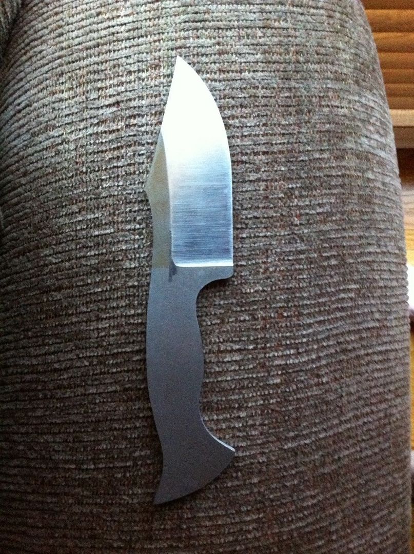

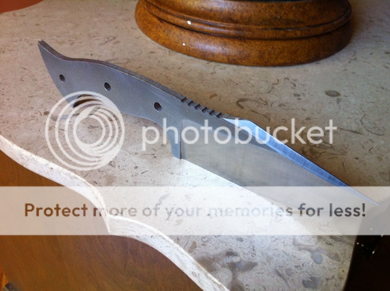

Here are the fruits of today’s labor in the shop which of course is just my garage, LOL. The grinds are not perfect but that’s the whole point of practising but they are pretty good and I’m happy with them at this stage. This is W-2 in 3/16 so it’s a nice sturdy little knife. Tomorrow I am going to put a swage edge on my drop point and some jimping with my milling machine on the blade just in front of where the handle will go and then pick up some furnace cement for my hamon and hopefully heat treat the next day. I think it is going to be a nice little knife because even without a handle it feels really good in the hand.
It’s nice to get working on a knife again because I have been so busy working my real job and getting my shop in order I have only made one other knife this summer which was my Nonlocking Flipper you might want to check out here?
http://www.bladeforums.com/forums/showthread.php/1429466-WHAT-A-non-locking-flipper-It-can-t-be!!!!
I really like flippers but I’m just going to make some non-folding knives for a while because flippers do take me forever. I think after this one I will try my first hidden tang with a brass bolster to continue practising my grinds.
Today I put a swage edge on my drop point and some jimping on the spine which worked out pretty well considering it is the first time I have done either. I drilled my quarter-inch holes for my handle pins but I drilled one size undersized and used a reamer that I had bought from USA Knife Supply because I want my pins to be nice and snug.
But when I tried fitting the pins there was tons of slop so I looked at my reamer and although it came in a case labeled as one quarter the dam reamer is 17/64ths! What a bummer. That is the second time they have sent me the wrong sized reamer so I guess I should know by now to check what they send me, LOL. I can either put lots of epoxy in the hole to take up the slack or I will probably end up putting a 1/8 inch hole on either side of my incorrect sized holes because I have someone 1/8 inch brass round stock.
Anyway hopefully tomorrow I can do my heat treating if I can pick up cement tonight for my hamon.
