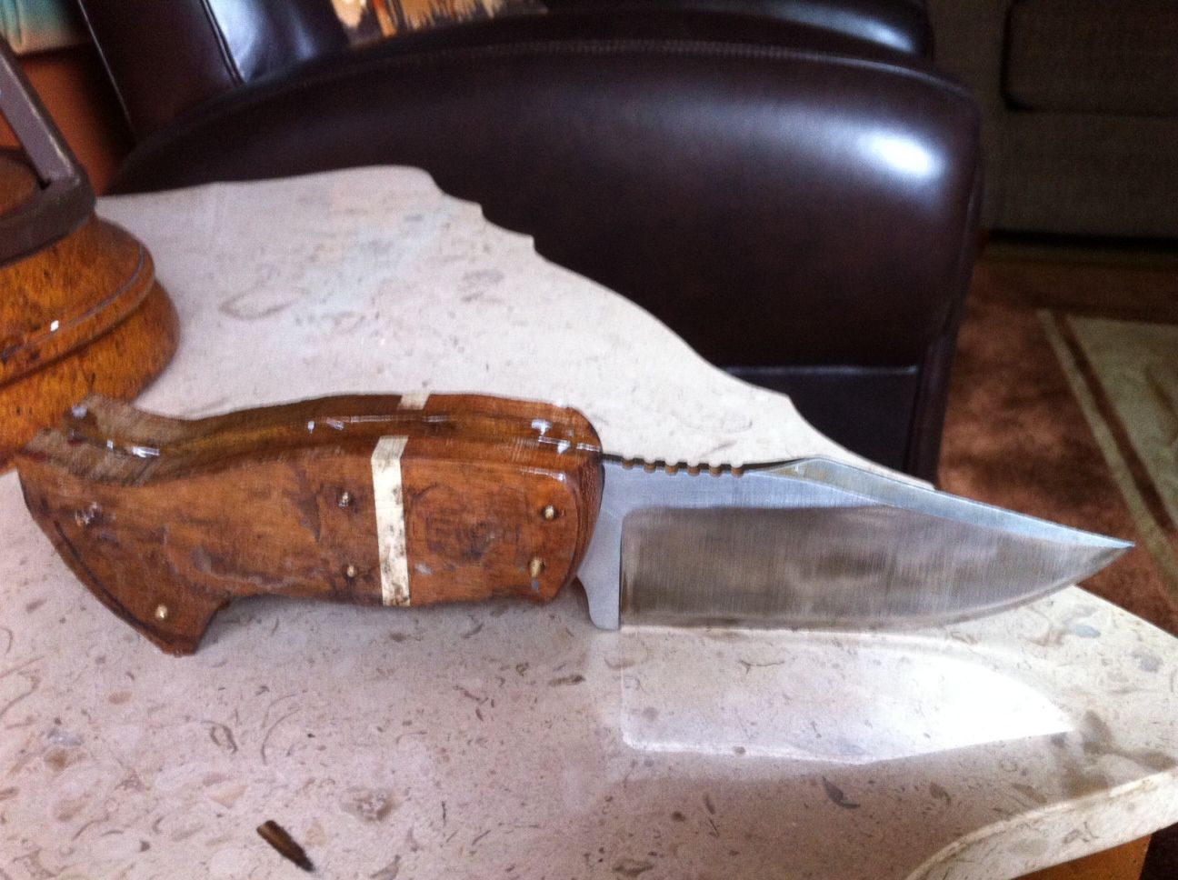

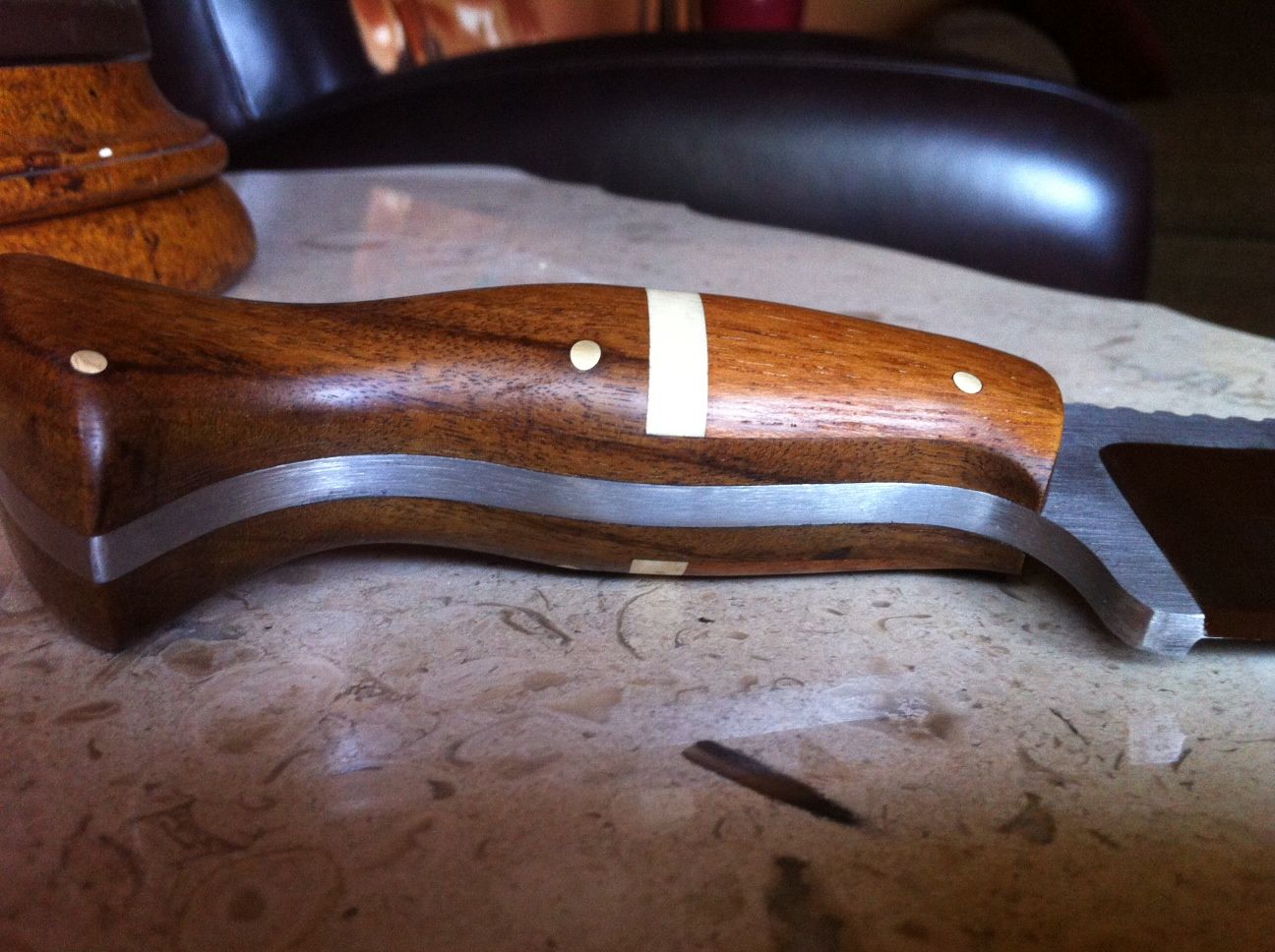

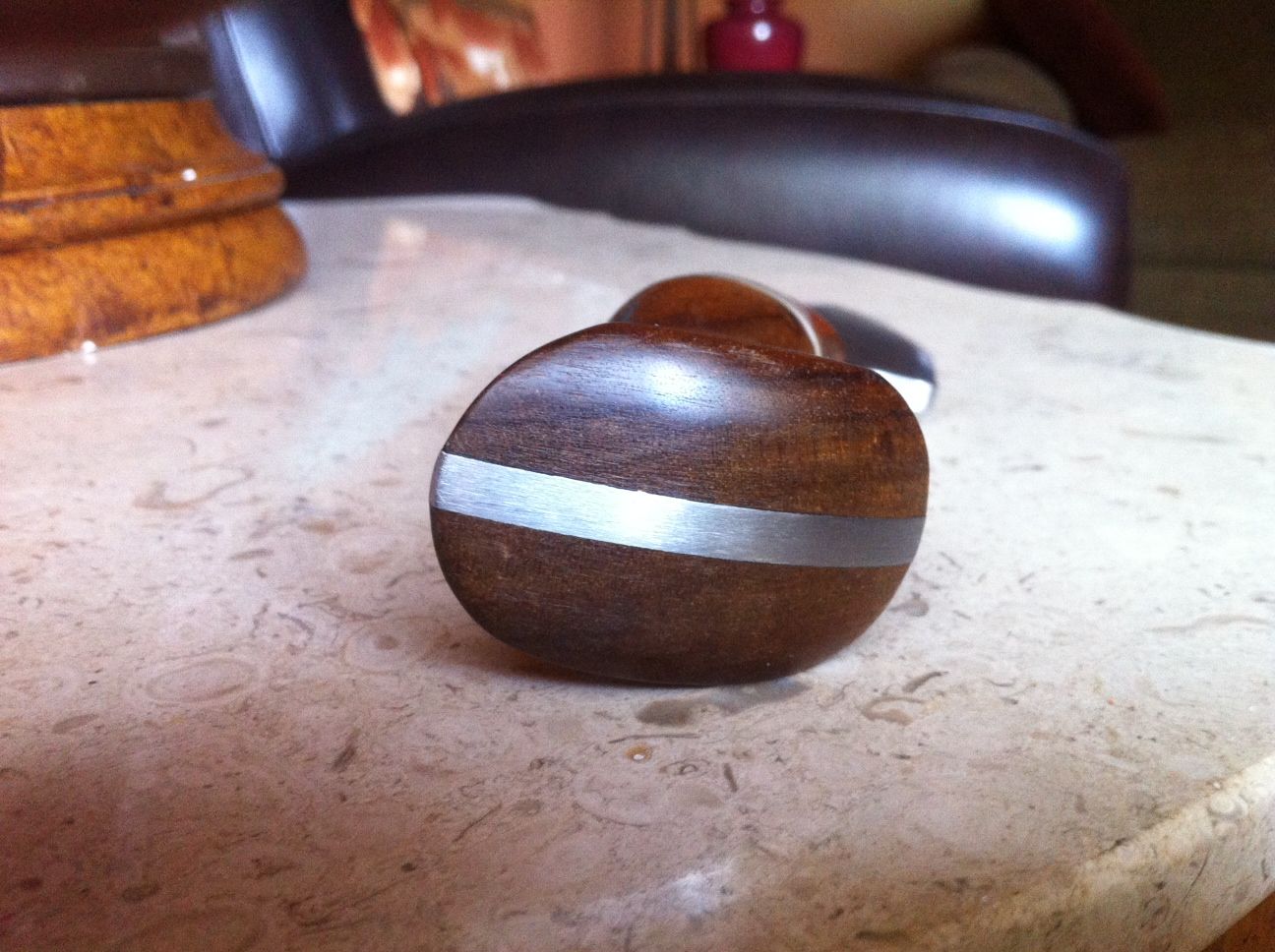

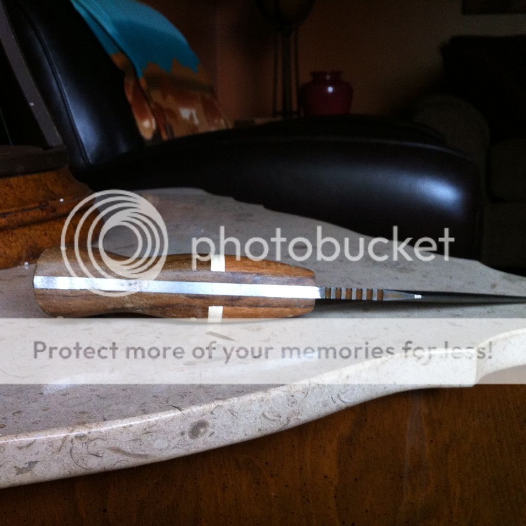

Well I finished my big W-2 grinding practice project. I don’t know if you call it a bowie or a camp knife or what but here it is. The blade is 3/16 W-2 and the handle is Ironwood with curly maple and Jatoba inlays. My hamon ended up being a total disaster and didn’t really show up defined but I am basically happy with the results because this was supposed to be for grinding practice and that turned out pretty well. I will play around with the hamon to see if I can improve them.
I just finished the handle shaping this afternoon. I took it to 500 grit paper and then hit it with a buffing wheel and it came out nice and shiny. I think I will put some kind of handle finish on it. In the past I have used Tru-Oil on some paring knives but after about a year the stuff is not holding up very well so I was thinking of putting some Varithane I have left over from my hardwood floors. I think that stuff is pretty durable.
Since posting this I found this thread:http://www.bladeforums.com/forums/showthread.php/773240-How-do-you-finish-wood-handles. So I think I will try another method than Varithane. Going to get some sandpaper up to 2000 grit and maybe some tung oil? :)

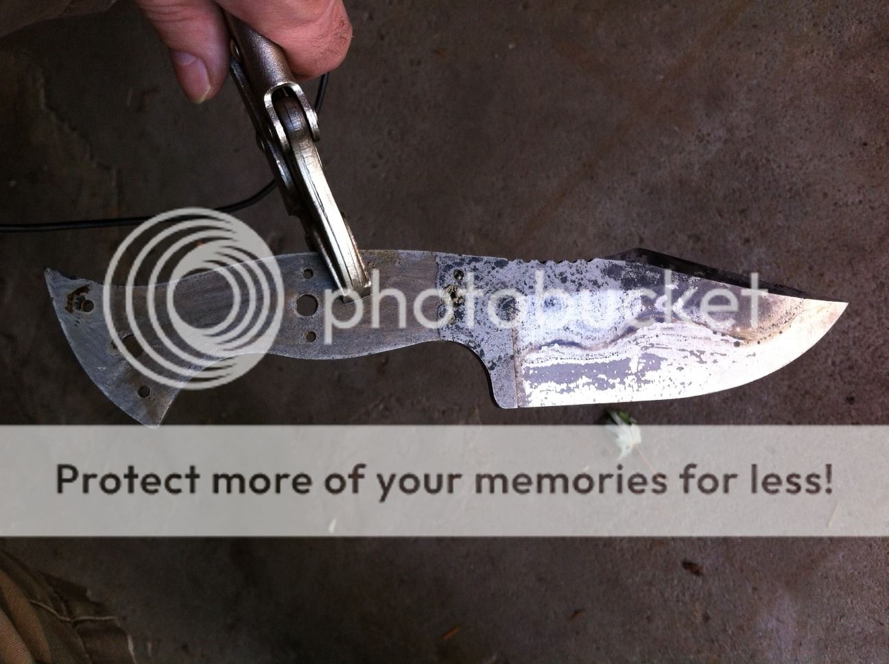

I don’t know why my Hamon didn’t work out. I went by Stacy E.Apelt’s directions here http://www.bladeforums.com/forums/showthread.php/663988-Clay-Quench-Question pretty much to the letter but it didn’t work out. Of course I blame myself and not the instructions just to make that perfectly clear. I do plan on trying to get them right in the future but I can live for now with that not working out very well because everything else seemed to go okay.

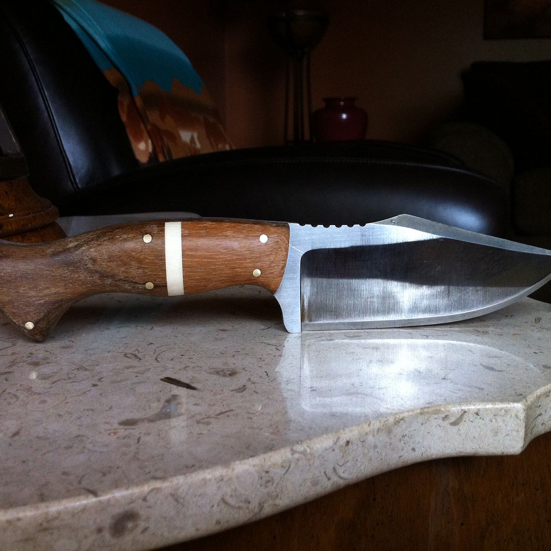

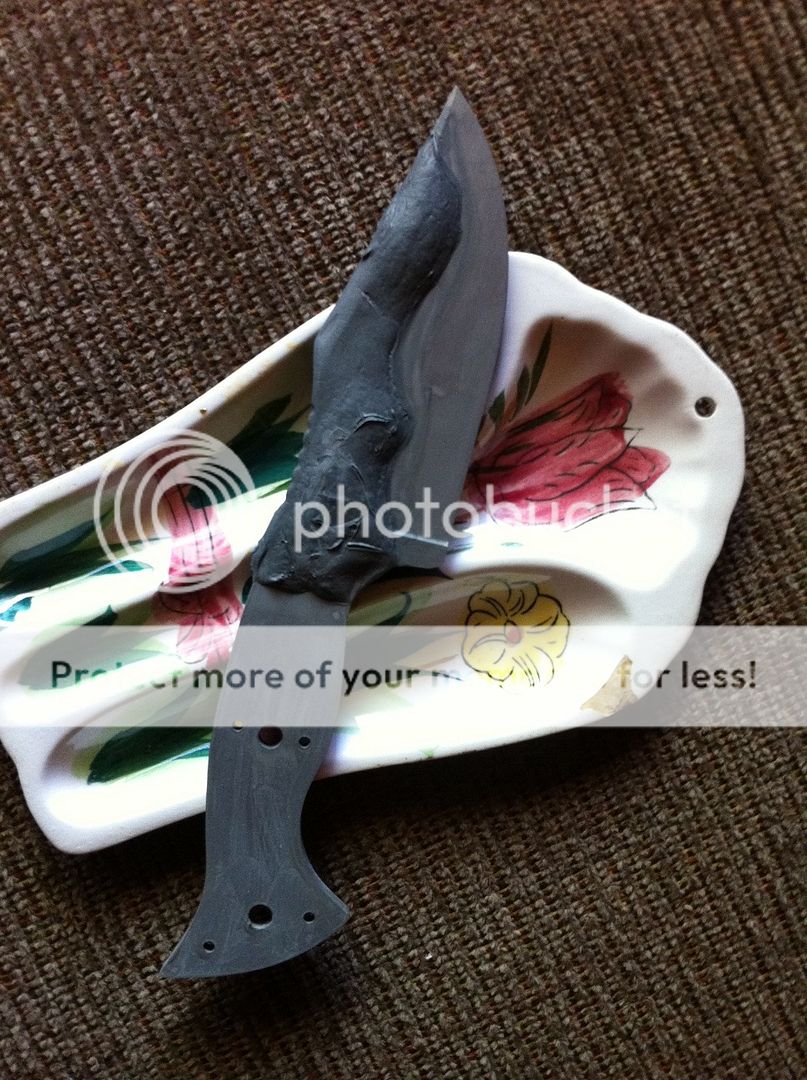

Here is a photo of my knife before heat treating with the clay on it. I put a very thin skim coat suggested by Stacy all over the knife and it did cut down on the scale. I don’t know why I didn’t get a Hamon but that’s something to figure out in the future.
Here is a photo right out of the quench before tempering. By the photo I thought I would have a hamon but to no avail, lol...

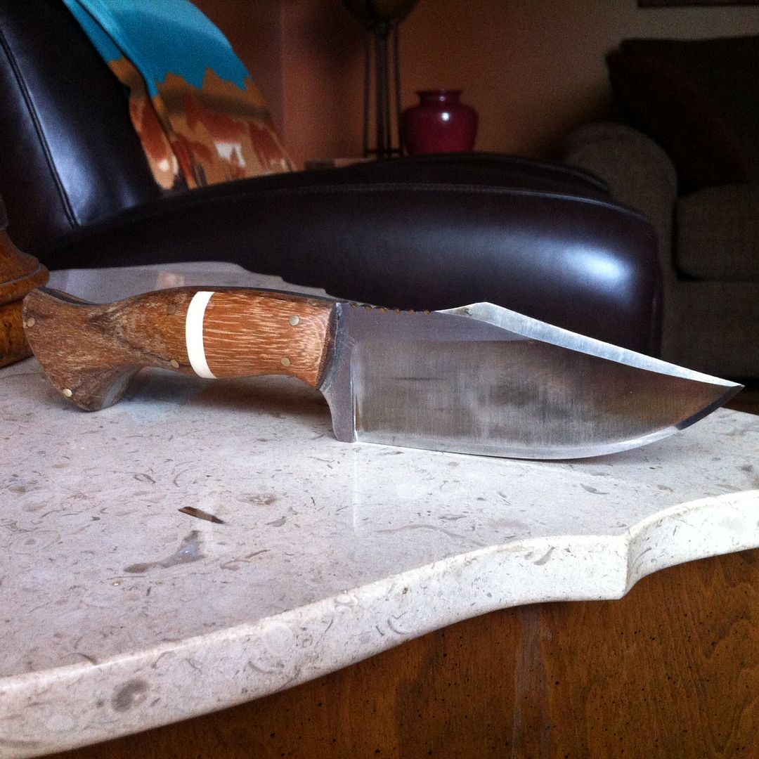

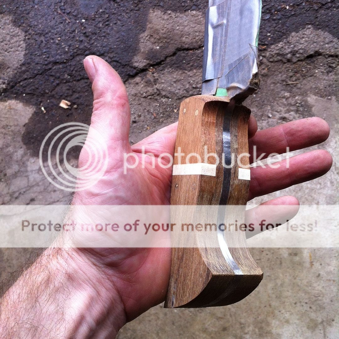

Here is one before I started shaping my handle and half way.
Again I would like to thank everybody who helped me get past my quenching dilemma to get to this point. I rushed the finish because I wanted to get it done before I had to return to work but I am going to go back and improve the finish. More to come!!
Wayyyy to much clay friend..You don't need more than say 3/32"-1/8" thick if that..Less heat,less clay..Heat treat at the bottom range of your steels aust. temp..We heat reat W2 at around 1460°..
With clay that thick your going to get a transition line at most..when you get that heat down and a thin clay you can almost write your name with it...Then later on when you get that down try just using heat control and no clay..That will give the most "cloudy" activity..

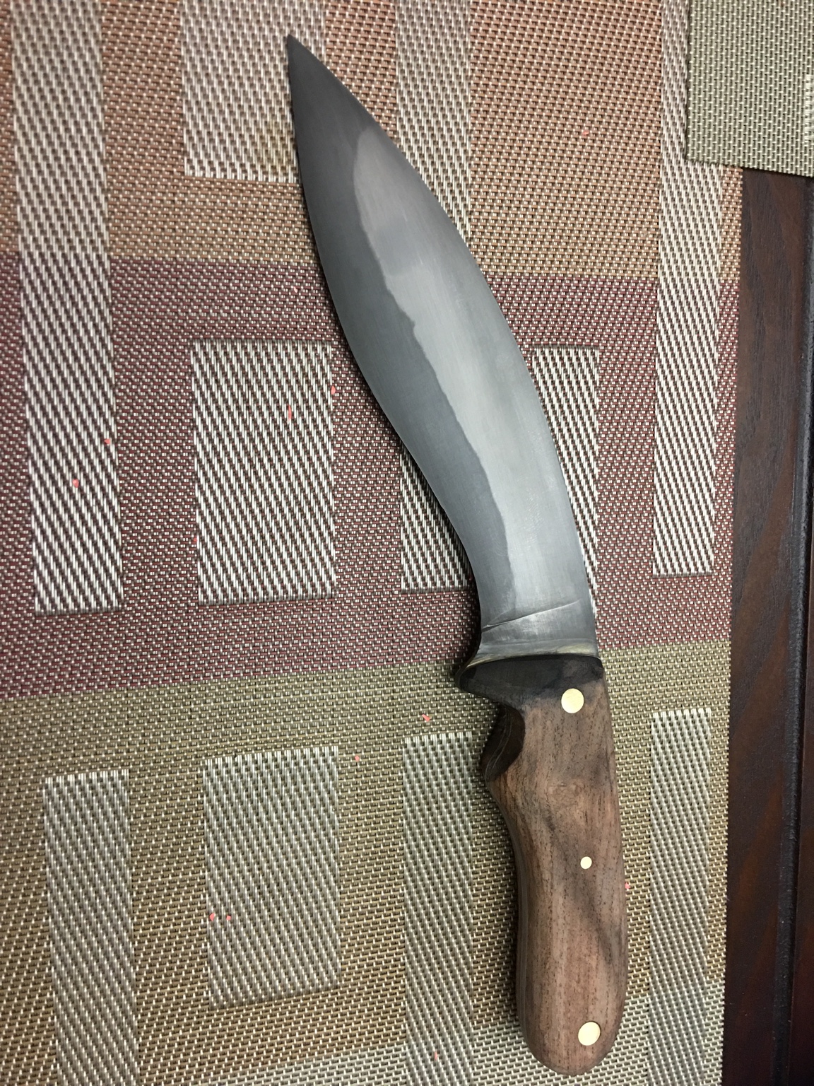

I did this blade today. Still have to finish the handles but got a really nice hamon on it using fireblock caulk from Home Depot. 1095. Heat treated to non-mag and gave it a couple minutes and quenched in McMaster 11 second oil.
Thank you very much Kentucky for your advice about my clay thickness. On my next attempt I will definitely make it much thinner. And also I appreciate the advice about aust. temps needing to be lower. I did read that previously but only once so I didn’t know if it was true and I didn’t want to sacrifice hardness for something I wasn’t sure about but now that you have verified that temperature should be lower I will definitely follow that advice too.
I have also heard about getting a hamon without using clay and I assume that is from just quenching the cutting side of the blade? Definitely something to aspire to but I think you’re right about getting the clay down first. Thanks again for all your help; greatly appreciated.

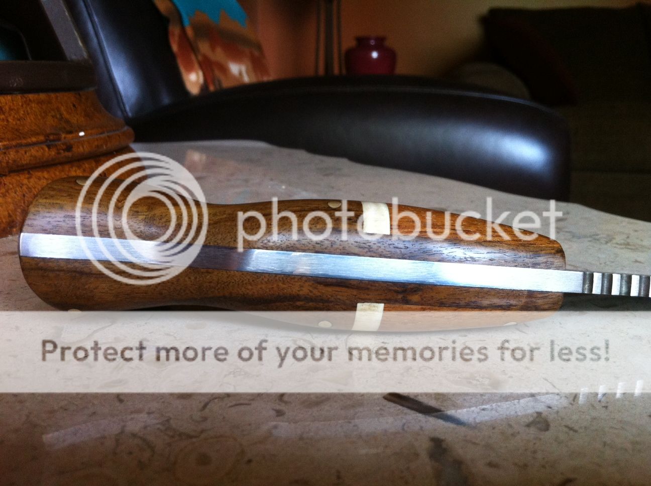

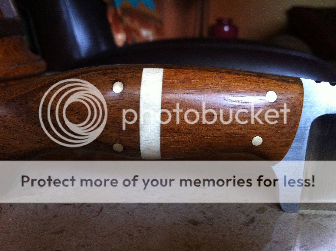

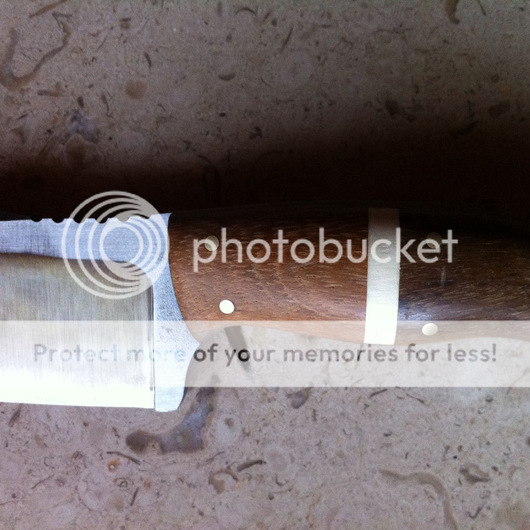

This afternoon I picked up sandpaper in progressive grits up to 2000 and some tung oil and did the finishing detail work on my handle. I refined the edges of my full tang and then sanded the wood up to 2000 and applied tung oil. I am very happy with the results and the oil really brought out the beauty in my woods. So I guess it’s basically finished other than over the next few days I will apply a couple more coats of oil. I give all the credit for my handle finish to the contributors of this posting as it had great information: http://www.bladeforums.com/forums/sh...h-wood-handles .
