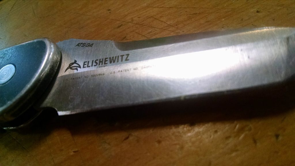

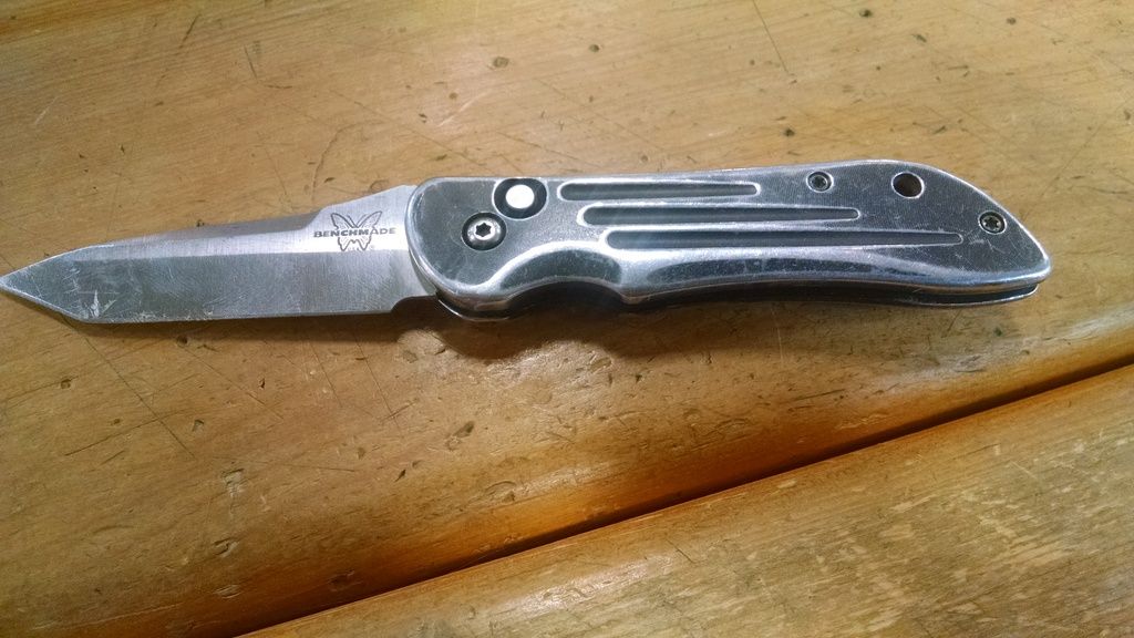

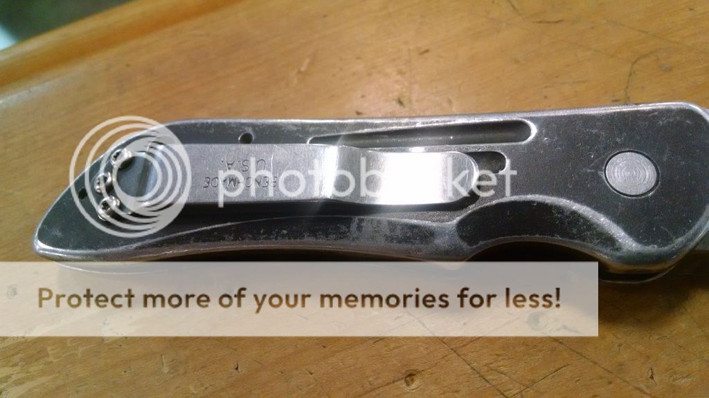

There was even a brief knife industry switch to Japanese Hitachi ATS 34 led by Bob Loveless in the 1990s
Lots of Spydercos and Benchmades in ATS 34
Heres a picture of a survivor!
:D
a Benchmade Auto stryker someone was kind enough to let me photo.
Held up great
