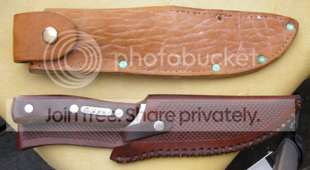

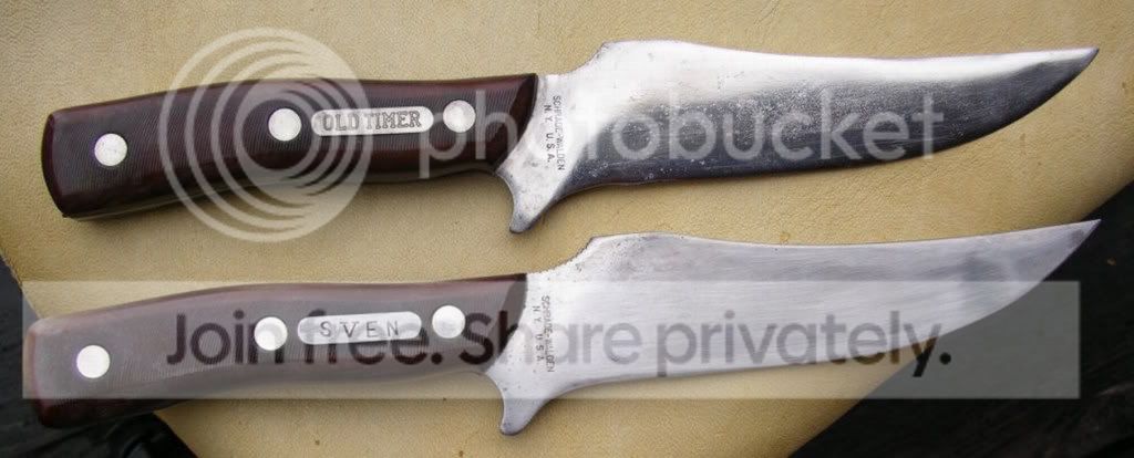

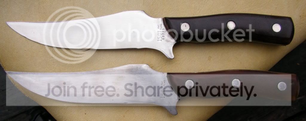

here are pics of the 2 Schrade-Walden 15OTs described above:
both Schrade-Walden/N.Y. U.S.A.
upper knife: 15OT Pat./Pend./09735
lower knife:15OT Pat./Pend.
and the sheaths:upper is knife with serial#, not original ?
lower: basketweave and knife named SVEN
from info in this thread, i think the serial # knife is the older as the Pat. Pend. on knife with SVEN shield is not an etch.
1964 was first year of production for 15OT. any idea as to when serial #s were started ? '64 ? 65?
and how long it took to get to 09735 ?

The wierd sheath is not original, at least I have never seen one like that issued with a 15OT.
Records show that 5,346 of the Schrade Walden knives, and 836 of the Sears #10600 were shipped in 1964, before the patent issued. 6,244 of the SW shipped in 1965 along with 2,552 of the #10600 Sears knives. Of this 1965 shipment it is unknown how many bore the “PAT. PEND” stamp, or exacly when that stamping stopped.
PAT. PEND. etch was before PAT. PEND. stamp. then PAT. PEND. stamp, then PAT. PEND. stamp and serial (#37669 has this stamp).
These are my conclusions from studying the knives I have seen and the examples of each in my own collection. Keep in mind that I was not there like Henry Baer when these subtile changes were made during those first two years, so my conclusions about this marking sequence is a guess 44 years after the fact, an educated guess, but a guess nonetheless. Every time I think I have the correct answers to the sequence, an exception to the rule of thumb pokes me in the eye (such as knife #37669).

It does not appear to me that your "SVEN" knife has the original blade finish. If it did, it is possible that you might see a Ted Williams signature etch, or some other indication that it was made for Sears or some other retailer as an SFO with a blank shield. The "SVEN" stamping looks like it was done one letter at a time using standard letter punches. The sheath you show with that knife conforms to the sheaths I have seen with the first production of the pattern (does it have the aluminum clad fiber insert too?). The stamping on the tang with no serial number matches my NIB Sears #10600 Ted Williams "Old Timer Hunter".
Mine does have the Old Timer shield, but no blade etch. On my example, the only indication of Sears retail origin is the Ted Williams logo in several places on the box. I have a later one with the signature etch and blank shield. I also have one etched "ZYLCO" with a blank shield and several with Craftsman tang stamps and blank shields.
the sheath has no insert and as a result has a small tear where the tip of the blade has poked through the edge of the leather at the stitching with full insertion.
yes blade has fine horizontal scratches covering both sides. it was cleaned up with something abraisive.
so MAYBE it is an early one before the protective sheath inserts were supplied.
i had been looking for the Ted Williams etched one when i came across this knife. so thanks Codger; maybe i did get a T.W. afterall !
