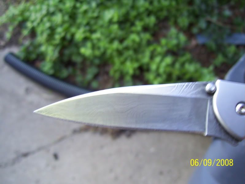

I purchased a DAM leek recently, within a couple of weeks, and when it arrived in the mail everything was perfect. I used it lightly over the next couple of days and decided it was time to give it a little wash. I put a few drops of dish soap on either side and carefully cleaned the blade with my fingers. To my amazement, some type of coating came off. Now the layers have almost no definition, the whole blade is a light color, not to far from say S30V.

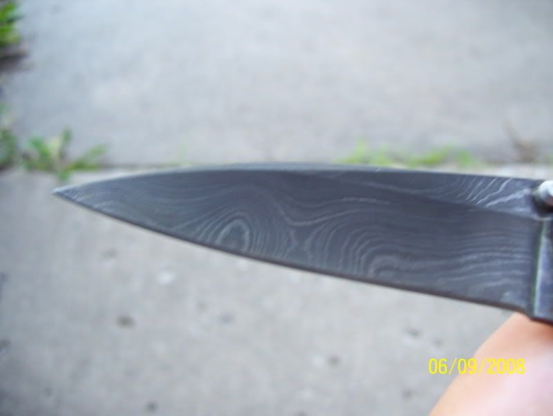

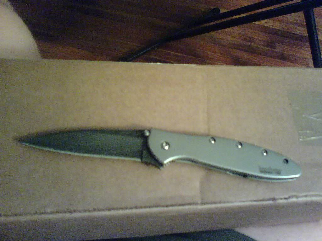

Cell phone pic, fresh from the box:
After the horrid washing:

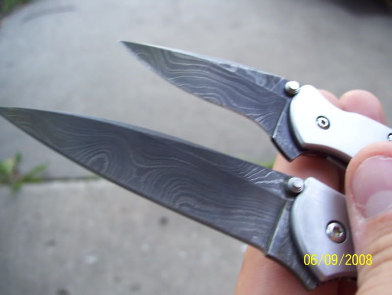

and with the new chive:

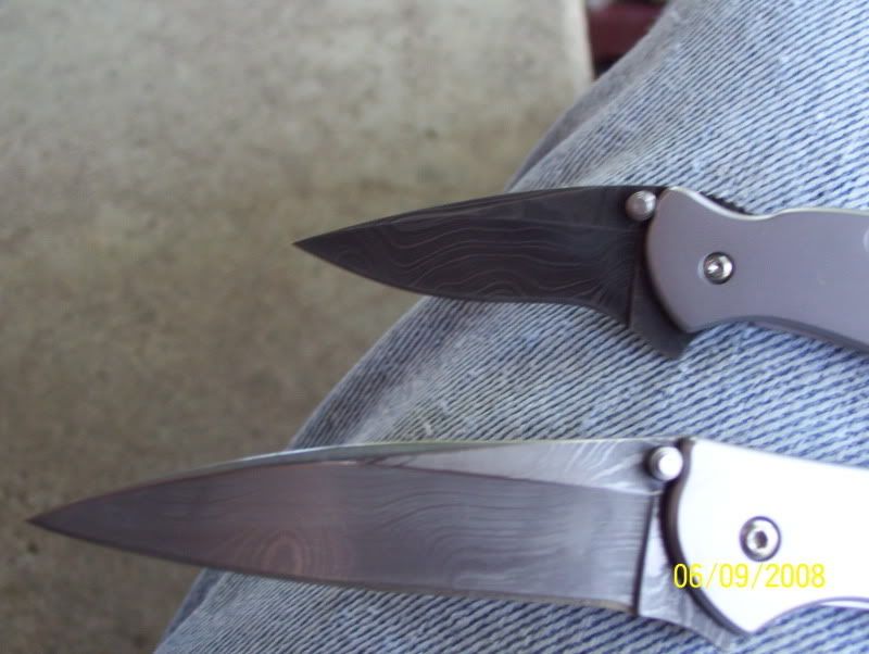

Now after the etching process:
and again with my new chive for comparison:
I used some denatured alcohol to clean the blade with. The etching solution I got was a powder, from a small mom and pop type electrnics store. It had to be mixed with warm water. No Radio Shack in or around my area carried the stuff, I think because it contains anhydrous ferric chloride, I think, I really have no idea why. Also most the people I talked to had no idea what I saying and eventually I started just asking if they had SKU#xyz.
Anyhow, followed the tutorial from start to finish and everything went smoothly. :)
All is well that ends well.
