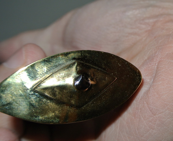

I got my WWII, and I spent the last few days thinking long and hard about what I was going to say in my review. I hate to be the first guy to say that the emperor has no clothes, but somebody has to say it. Everybody knows the blades are good quality. Everything about this kukri screams quality, including the sheath, karda, chakmak, etc. But, there is one fatal flaw: The handle is total crap.
I'm not talking about quality - like I said, everything is quality. The first thing I noticed when I picked it up and waved it around a little in the air was the retarded shape of the handle digging into my wrist and palm. Seriously, a ten year old kid could make a better-functioning handle. I've done it, I've seen it done, and it's brain-dead easy. Here's a good example:

I'm going to either cut it away and make a new handle for it, or I might put it back on the market for one of you guys to get it. I really like the balance and the forged workmanship, but let's get real. These handles are for people who had no idea there was a better way to do it.
A suggestion for Himalayan Imports: If you can't get the Nepali craftsmen to put a proper handle on the blade, save everyone some time, effort, and hassle, and just start selling the blades without the handles. No more losses due to cracked "blems", and everyone is happy. Traditional handles are fine for collectors, but for people that want to use these kukris (for work or play), putting a labor-intensive inferior handle on them is just wasteful. It's only going to make it harder to put a "real" handle on it.
One thing I noticed is that people don't seem to have much trouble with the pokey handles on the heavy ang kholas. I think that is because the swing speed is slow enough that the user can use a choked-up grip to keep delicate flesh away from pointy handle parts. My WWII is light for its size, and just gently waving it around is enough to cause it to slip down and take a bite out of my hand.
This is monumentally bad design. The handle actually tapers to a smaller diameter towards the end of the handle. That's like trying to hold on to one of those cone-shaped paper cups for water coolers. There's no way to keep a grip on it, it just keeps slipping towards the pointy palm-stabbers at the end of the handle. It's like a watermelon seed - the tighter you squeeze it, the more it slips.
I'm not sure which end of the knife is the most dangerous!
If I can get a better handle on this, then maybe I can do a better review of the more positive aspects of this knife. I might decide to sell it instead.

While I prefer wood to horn, I've found the design to be very good. I have sanded my handles a little hear and there to get a better fit. Mainly on the palm side to prevent the "digging".
As for the blade slipping out of my hand, I have had an issue of that any more than any other handle. Read the threads on proper technique. I've learned that the shape is very good at preventing the knife from flying out of my hand. The way the handle flares out before the end is normally very effective at keeping the knife from slipping out.
I would also like to point out that a more polite way to express how you feel would be preferred in the future.
I'm not worried about the knife actually coming out of my hand. The flared ends of the handle ensure that won't happen. I didn't mean to be impolite, just unambiguous and unequivocating. The traditional handle design really really should not be the only available design, especially when better designs are a lot cheaper and easier to produce. In fact, I would pay the same price again for the same knife without a handle and just a handle kit, just so it wouldn't be such a bother to try removing the traditional one to replace it.

When I got my first khukuri, the traditional handle would poke into my hand while I swung it. After reading up about the proper technique and trying it out, I found that I could indeed grip swing the khuk in such a way that my hand was out of the way of the "pointy" top/bottom.
I think the traditional handle shape evolved that way for various reasons. Some people don't like it initially (me included) but learn to appreciate it.
Thanks for the info Steve Tall. I've seen the YouTube videos of people chopping away with these, and the ones that make it look easy are the people that have been using the same kukri for years. They all hold the knife in an unnatural way such that it doesn't dig into their hands, so I know it's possible. I figured I would probably be removing the handle, which was why I was so quit to buy one of the nicer "blems" after a little encouraging from everyone. I just wish I had gotten the chiruwa - I didn't realize they normally have such a short tang. That's not a problem with plenty of epoxy, so I'm sure whatever I decide to do, it will work out well.
Metal files and sand paper does wonder to correct the forms and fits better, I also find that wearing a glove really help with comfort and slippage. There are practically no aftermarket demands on these unless it's from kami bura, so my advice is to rehandle it with micarta. Tirhta are known to produce great steel but crappy finish. My M43 from him are rough on the edges too but it is what it is a blemish, not much to drill on.

You don't need to "go crazy with a belt sander". You'd be surprised was a little file and sandpaper work can achieve. Without changing the look much at all, you can improve the comfort greatly with just a few minutes of work.

Take some sandpaper or files to the parts that bother you. Round or soften the parts that dig you. Do so a little at a time, checking often. At some point you will find the handle comfortable if you've been watching and sanding in the right places.
Then work on your understanding of the design and your technique. As you gain more experience with your blade you will come to love the traditional designs as we all have, or you will be one of those whom simply cannot tolerate them and will have to find a product that better suits your preferences. It doesnt mean the traditional design is "crap" or flawed in some way....or that your perception is wrong... just that you are incompatible.
