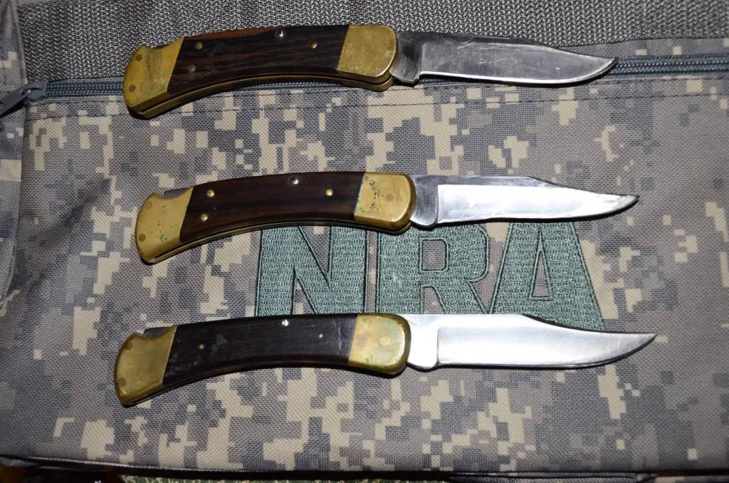

Thanks and sorry about the confusion. When I said edges I was referring to the overall edges of the knife handle (the brass bolsters and wood handles), not the blade, I should not have said edge as that would mean the blade.
The oldest knife I have based on the dots has the more modern, rounded look (bolster edges are rounded) and the 2nd oldest has the flat bolsters (the corners having a much sharper ridge). I thought it would be the other way around.
In my post a few spots up is a link to some photos. I got a close up of the two bolsters on each knife side by side that shows the flat vs rounded edges of the brass bolsters if that helps. thanks
Buck began to 'Radius' the handles on their 110 toward the end of the 3 dots and more at the 4 dots time frame. Someone probably did that as the 2 dots frames were not radiused. The frame not being radiused on your 3 dot dates it. DM

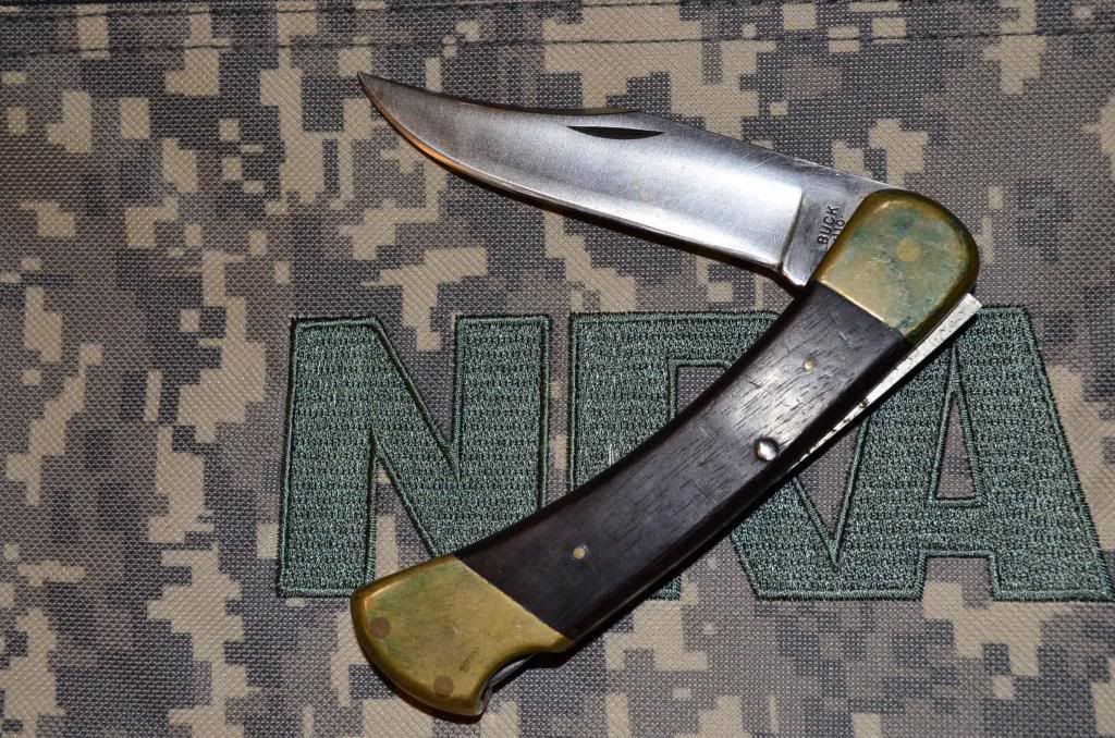

here is a photo of my two dot 110 with the rounded bolsters (radiused I see is the term). Since the 110's from this era had the flat bolsters/edges on the inlay you guys are saying this was done to my knife by a prior owner? is it possible the factory did it afterwards because the curves match perfectly the curves on the 110's I have that were made later that were radiused/.
http://i803.photobucket.com/albums/yy314/germanshepherd13/_DSC0237_zpsff52159a.jpg
and here is a photo of the two dot with 3 dot at top, 110 X in middle and two dot on bottom cor comparison
http://i803.photobucket.com/albums/yy314/germanshepherd13/_DSC0236_zps9face5e8.jpg
