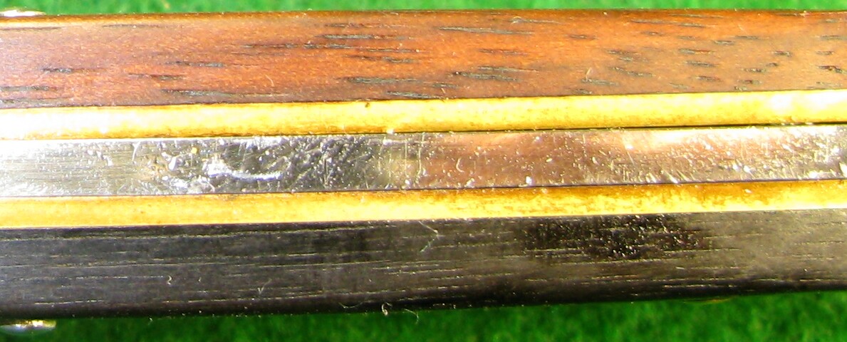

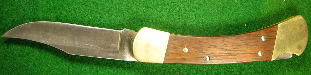

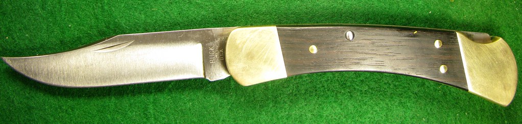

Why are the handles diff colors/materials?
It doesn't look rehandled (the pins look "factory" to me)

One of them is rosewood?
What is the darker one??
The two colors kinda bothered me at first
Now, I am at peace with it and think it look kinda cool :cool:
Thanks for help you Buckians
I went on a Buck buying bender
More pics to come.......
there was also another woods used
both i believe are ebony
which has different colors
but they will be the same wood
most times they tryed to match better but
did not always happen..

Nice one Trent. 334Dave has forgot more about the 110 than most will ever know.
Here are some extra points.
-You have a 3 pin knife due to the inlay pins. The rocker rivet does not count.
-Its macassar ebony, sometime called golden ebony due to the golden hues and stripping at times. As Dave said, they tried to match but didn't always.
-You have a 2 dot knife which is 74-79 manufacture. The large (1/8th) inlay pins indicates later production, probably 76 or after. Earlier knives had 1/16th pins and their number varied from two to four back to three.
Dave's right about the deep clip on that blade...very nice piece.

Same wood huh??
Never thought of that
And believe me I THOUGHT about a lot of reasons why the wood was diff
Sometimes the obvious solution is right in front of you
Yes Trent,They did try to match them better than that.Thats the first I've seen like that.But I believe its Macassar Ebony.Great find at a great price.I usually have to give 30-40$ for one like yours.DM
There is another possibility on the scale color.
That lighter side looks a lot like a piece of sequa wood.
Did that thought occur to anyone else?? You know how the Bucks like to use up excess inventory:) I think its a very interesting piece.

Hello, I have a 2 dot 112 that has that exact same handle (issue?). I am a noob in the world of buck, so I thought the previous owner displayed it with the lighter side up.....so I thought the sunlight had faded one side:D. I am glad you guys are here, because I would have kept on believing my theory. I am with you though Trent Rock, at first all i wanted to do was stain the lighter side, but I kinda grew to appreciate it.

:cool:...Don't forget what happens when a knife like a 110 has been stored on it's side leaving one side exposed for years. It will indeed change colors as the "down" side will not have interacted with the air or light nearly as much as the exposed side. I have a tinned 110 from only 4 years ago that was never opened and when I did open it I saw the "down" side was much darker than the "up" side already...:)
