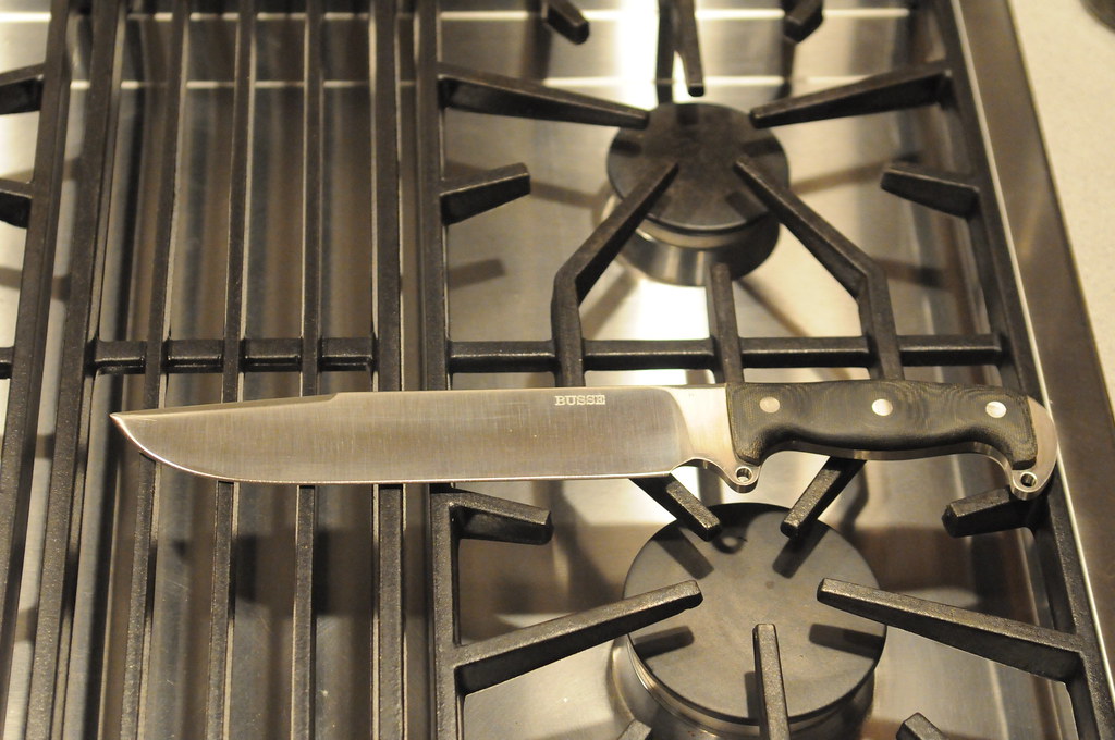

I'm assuming that is inclusive. One thing I'm sure of without having to do the math myself is that there is no way in heck the knife Nozh pictured here is anywhere near 30 degrees. Just looking at it is enough to tell that an answer of 30 degrees signifies either a mathematical error or an error in the initially input measurements.
