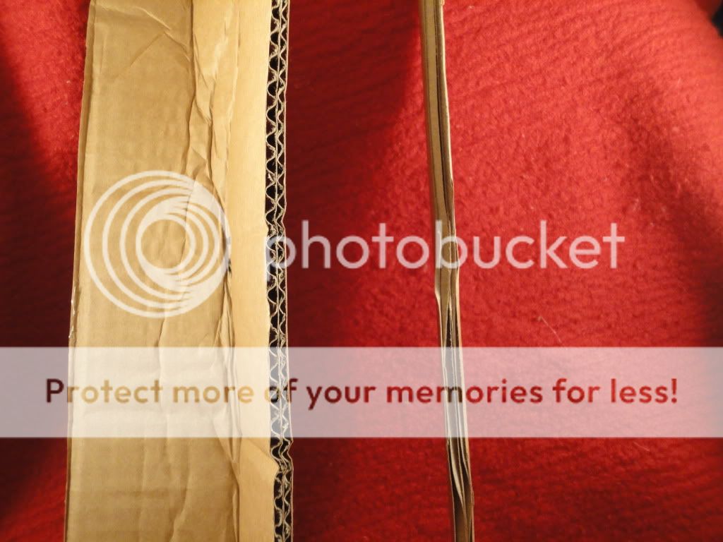

51 lb. edge crush cardboard

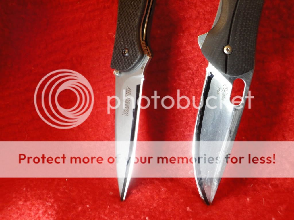

bevels with sharpie still on from edge pro

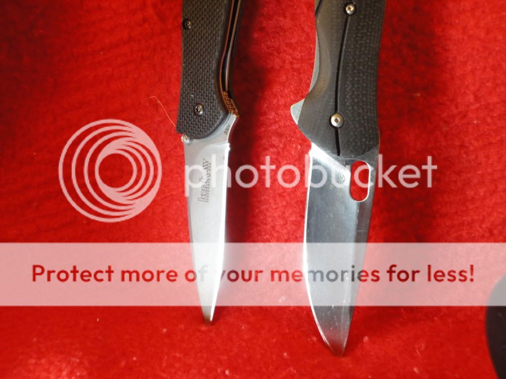

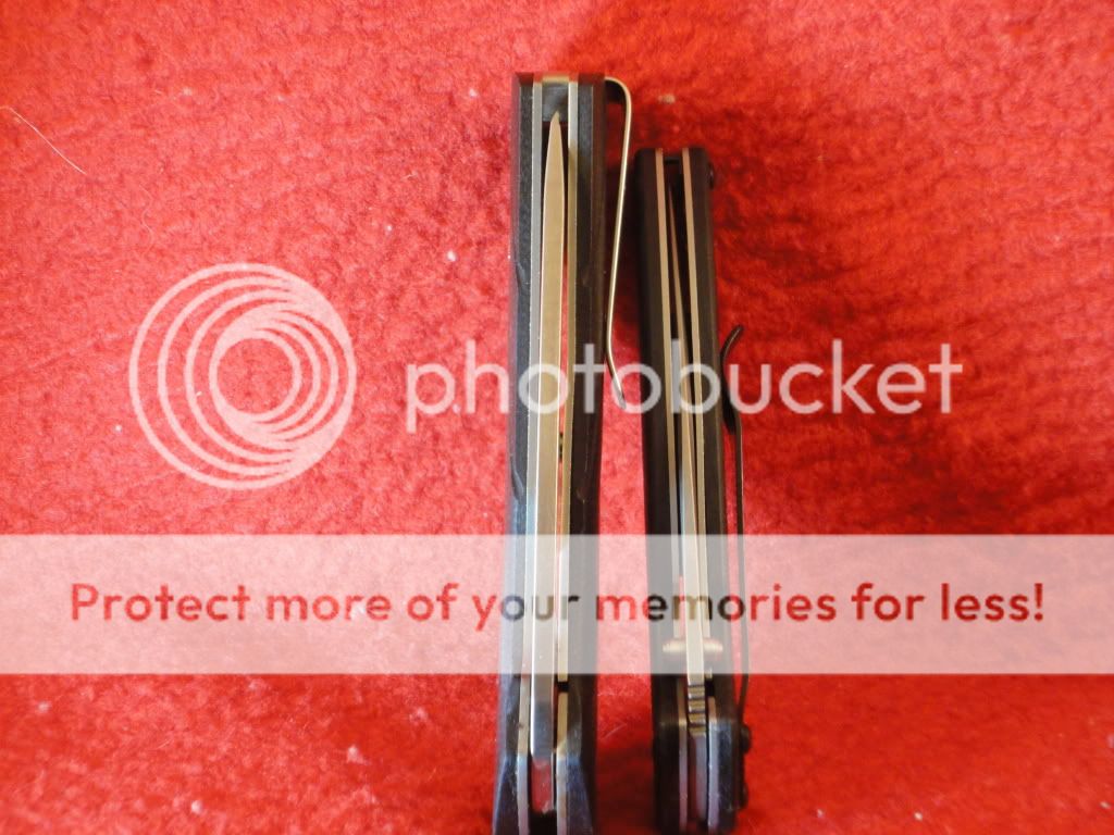

buck vantage pro & leek relative blade thickness
s30 blades ready for cutting
all cardboard came from same co at same strength. the leek out of box was very sharp & did 50 12 in. cuts before quit shaving. after polishing to 6000 on edge pro at 24 degrees & light leather stroup i made 50 cuts with each knife. both still shaving hair after 50 cuts but the buck would slice telephone paper somewhat easier in straight line.both had blades with cutting edges nearly = but the leek sliced easier since it had a more slender blade which reduced friction & lateral stress. for surgery & lighter tasks my choice would be the leek.all around usage goes to the buck since it could also handle some outdoor camping with rougher usage. i was surprised at the leek since earlier kershaws i tried were'nt as good performance wise.--dennis this is no rigid empirical survey but it does give some info

Why is the tip of the Vantage all gnarled up? Poor sharpening technique?
(3rd photo)

What Dennis did was a good test to see how close the 2 blades were, cutting 50 Ft of cardboard with each blade gives a good indication of how they should perform.
The results were positive for both knives and seem to be pretty even when cutting cardboard.
Cardboard can be a good test medium for testing as it can be very hard on edges and very abrasive depending on the cardboard used. It can really tear an edge up very fast from what I have seen from my own testing.
The results are meaninless because they do not have the same blade geometry:
"but the leek sliced easier since it had a more slender blade"
It's like comparing tangerines and tangelos, the steel is the same, but the blades are not.
