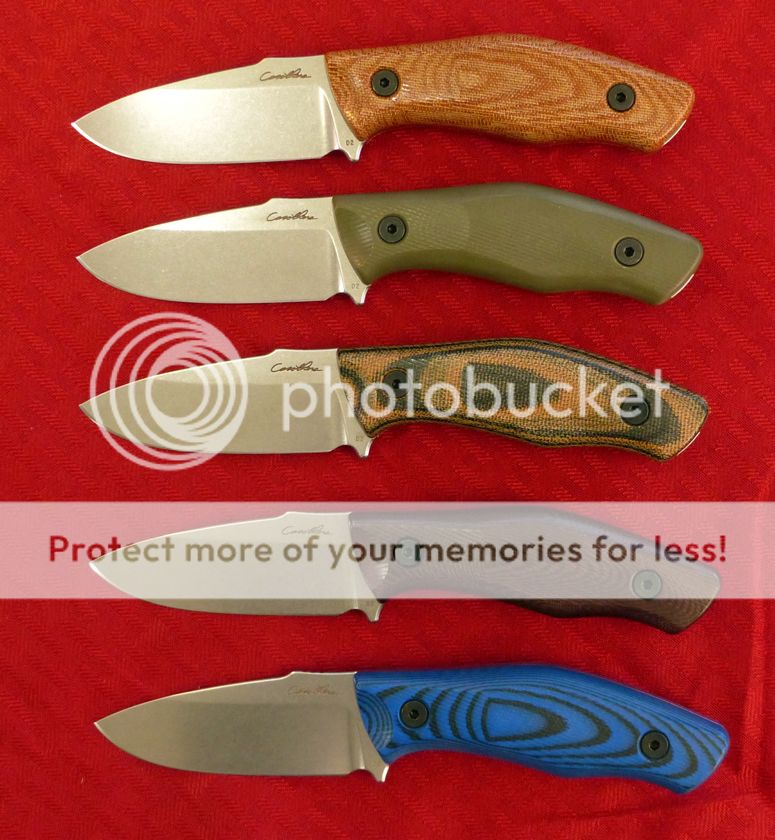

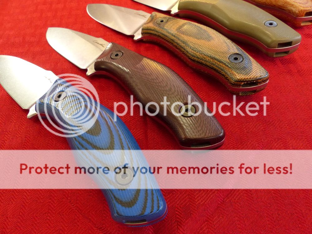

The 3" EDC was designed as a collaboration with Lorien Arnold. It is a well made, no frills, high performance, small utility knife. The steel is Crucible D2 at HRC 62.5-63.5 with a fully optimized heat treat with very good edge retention and edge stability. You'll be surprised how sharp this gets and how well it holds an edge. If you have never used really good D2, it is gonna blow your mind.

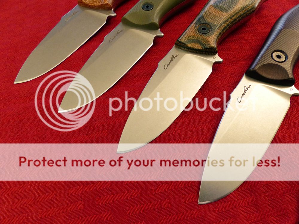

This steel with this heat treat will support a relatively fine edge, so this was taken under .015" before sharpening (though I'm leaving some additional meat in the tip) and it was sharpened 18 degrees per side. This is relatively acute and it cuts very well, but is durable. They're also lightly hand ground after machining to give it a slight convex grind.
The primary grinds on these are more narrow than the Field Knife. They are quite "slicey"
Some might consider this a tactical knife but the point is not reinforced and it is not shaped or balanced as a weapon. It's thin behind the edge. It is a hard working cutting tool, a tradesman's knife and small woods knife.
It's very light weight.

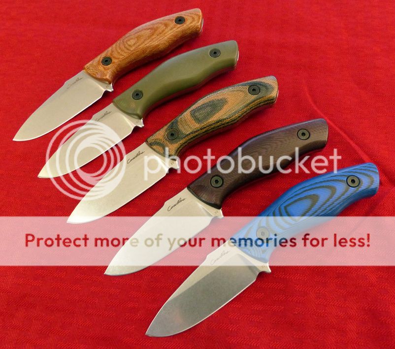

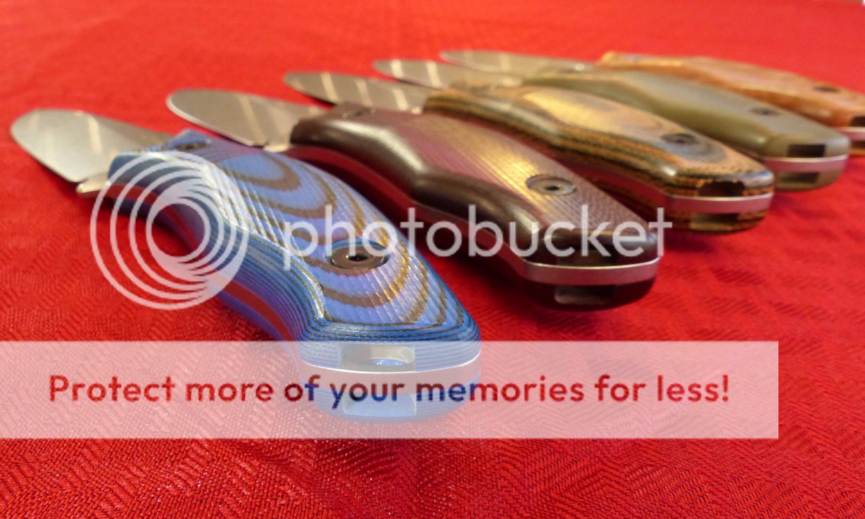

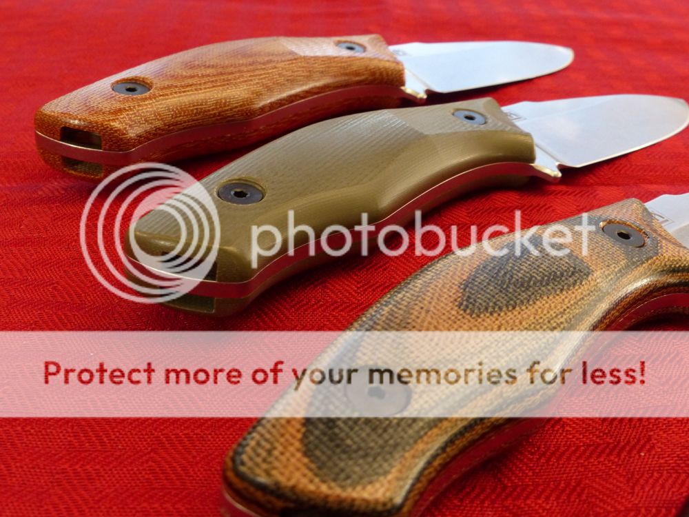

The handle is ergonomically designed for a standard forward, reverse, saber and pinch grips for an average to relatively large hand. Despite its compact size it fills the hand and allows extended hard work without hand fatigue. The tang is internally skeletonized. The scales are 3D sculpted CNC machined. The blade is made of 1/8 D2 with a heat treat that has been optimized to maximize edge retention. Despite being relatively thin it is durable.
A side effect of this heat treat is a higher percentage of free chromium, so although it is not stainless, it is nearly so.
Specs:
D2, 62.5-63.5 HRC, .135 thick at ricasso (a hair over 1/8")
Total length 7.5
Blade length 3.2
Weight 4.8 oz
Edge angle 18 DPS
.020" BTE
Grippy 3D machined scales in micarta or G10
Black oxide treated 18-8 stainless steel fasteners
Hidden lanyard
Choice of vertical or horizontal Kydex sheath made by Dan Crotts of Dozier Knives. If you want one of both sheaths, an extra sheath is $50.
Be aware the horizontal sheath has very high retention. You can't remove the knife by pulling straight back, you have to tilt it up at the same time. See video. If you want something that's easy to get in and out of you should choose the vertical pouch sheath.
Tell me what scale option you choose and I'll build it. There are twenty knives available in this sale. The knives in the picture are not the knives you will receive. I'm sharpening now and they can ship next week.
