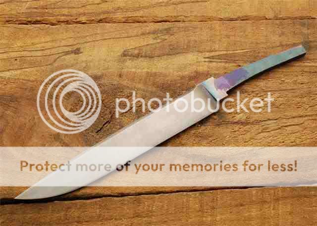

Hi Mr. Cohea,
First off I would like to thank you for inviting me to make the blade for this project. This is the first collaboration I've ever done with anyone and I'm having a great time making my part of this knife.
Burt Foster came up with the design on this knife. Before I started the blade Burt and I talked on the phone while he sent me sketches through e-mail and I looked them over on the phone. Burt refined it until he came out with the above sketch and asked if I liked it and we went from there.
The blade is about 9" long and forged from 1080 and 15N20. The damascus pattern is a four bar "W" twist with a small difference from what I've been making. What I did different is after I made the first weld, forged the bar on a bias 90 degree angle and cut it into four pieces I then put a piece of 15N20 in between the four bars to frame in the "W". If you look closely at the pattern it looks quite different from a regular "W" twist.
I also ground, heat treated, tempered, final ground, hand sanded to 320 grit and softened the tang of the blade and the ricasso. I gave it a quick etch to see how the pattern came out. Then I sent it off to Burt. After Burt is done with the handle he will send it back to me and I'll finish hand sanding the blade to 1200 grit and etch it.
I am really looking forward to seeing how this knife looks finished.
Again thank you for inviting me to be part of this fund raiser Mr. Cohea!
Thanks for looking and have a very merry Christmas everyone,
Kyle

Hi folks, got some pics and text in from Burt Foster today, so it's time for an update.First off, a change had to be made from the original design. Joe need more room for engraving, so Burt decided to go with a full guard instead of just a ferrule.Now for some details.

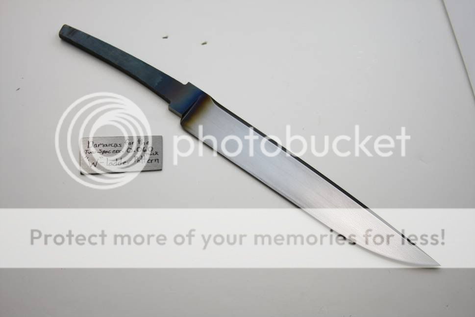

This is the blade as it arrived from Kyle.320 grit hand finish, really nice multi bar damascus barely visible.

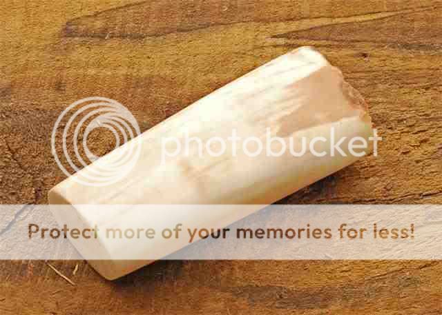

This is the walrus ivory, generously donated by Don Fields of R.Fields Ivory

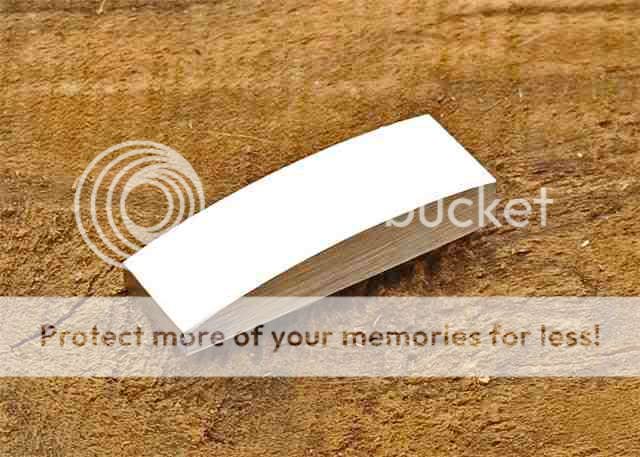

This is the little damascus spacer that will sit between the guard and the handle.It's a piece of w's that Kyle sent with the finished blade.

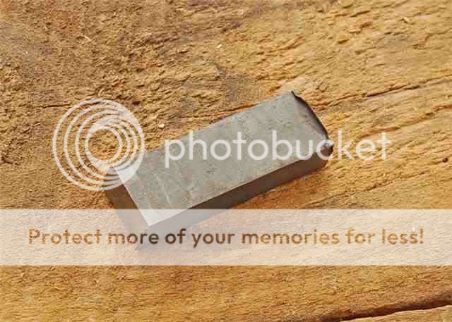

chunk of 416 stainless forged down from 1" bar.
Here's the guard with the top shaped, ready to be slotted for the blade.

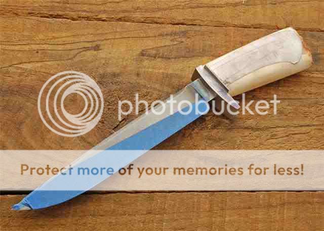

The guard, spacer, and handle, fitted and bedded to the tang, ready for final shaping.

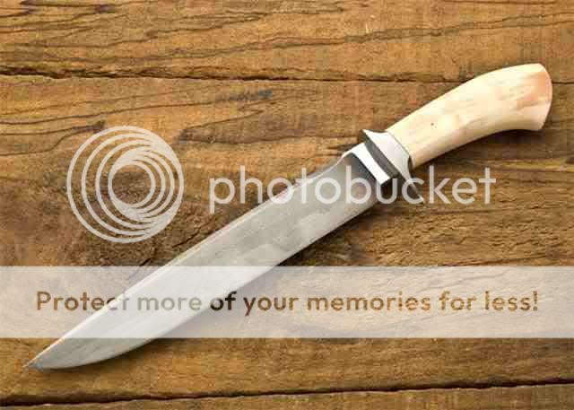

This is the knife as it left my shop.The guard is shaped and sanded to 600 grit, along with the damascus spacer.The handle is shaped and polished.Kyle will etch the blade and spacer, mark the blade with both our marks, assemble the knife, insert the pin, then send it off to Joe Mason for some engraving on the guard.
