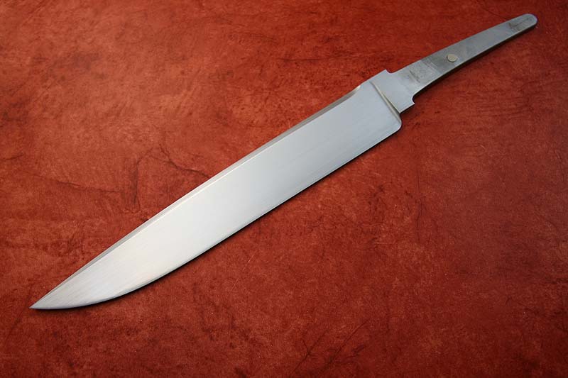

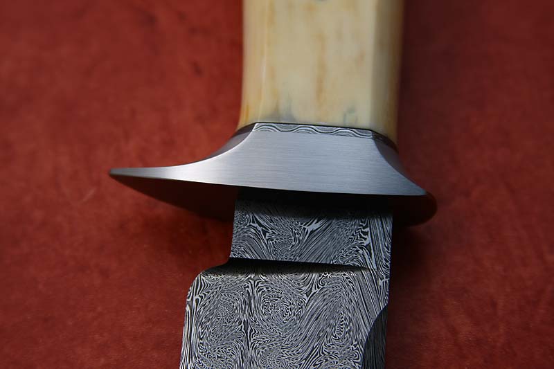

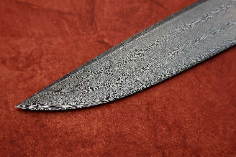

Mr. Foster did a great job with his part of this project! Here are a few pictures of what I did after I got the knife back from Burt Foster.

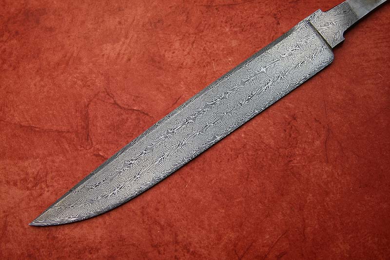

Here I have finished hand sanding the blade and it is ready to be etched.
I etched the blade for 20 minutes going in five minute intervals, etch and clean the blade/ etch and clean the blade...

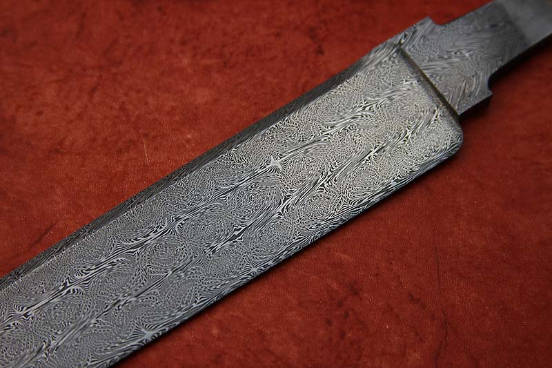

Here is a close up of the damascus pattern.
In this picture you can see how the damascus flows with the blade edge out the tip.
I etched Burt's makers mark then I etched mine.

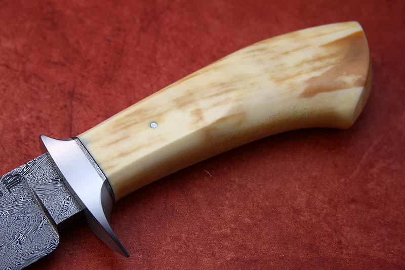

Next I etched the thin damascus spacer in-between the guard and handle. The pattern on the damascus spacer is a "W" Ladder edge view.
In this picture I have epoxied the handle on with West Systems Epoxy and after letting it set over night I put the pin in the handle and cleaned up the ivory with a buffer.

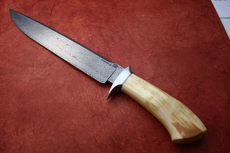

And here's the knife ready to be sent off to Joe Mason for engraving.
Please excuse the poor photography. (I took these pictures not Caleb)

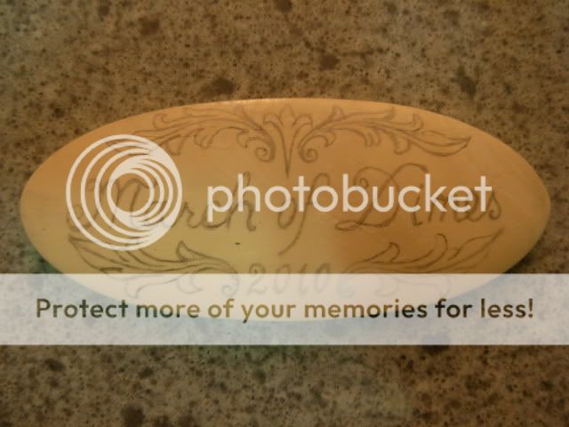

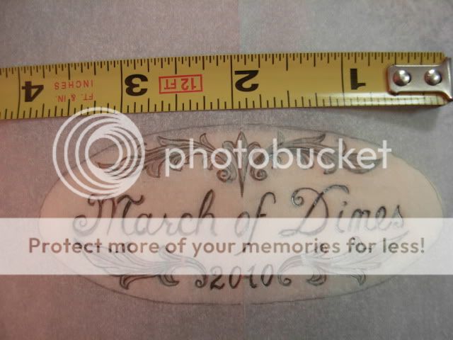

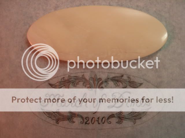

I've made an Ivory pendant to be inlayed into the display box for this project and got my rough sketch of the scrimshaw done.
I thought I'd post a few pics and hopefully get a few opinions before I start the scrimshaw tomorrow.
I went through several different design ideas before settling on this style as my favorite.
I thought it would be good to incorperate leaves based loosly on the engraving displayed on Joe Mason's website in an attempt to tie the scrimshaw in with the knife.
Let me know what you guys think.
-Josh

That looks very nice!!!

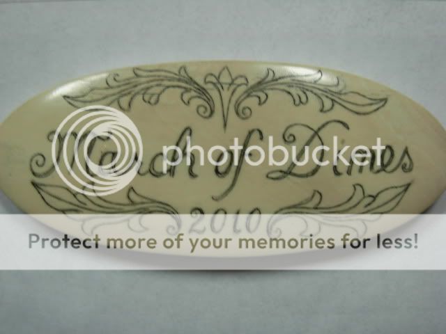

I've made a bit of progress on the scrimshaw.
1st pic is of the pattern transfered onto the Ivory
2nd pic is the bordering completed and "Inked" with black oil paint.
There will be minor adjustments to the border made during the process of shading the leaves and filling the letters with color but It's real close other than the line I missed in the upper right hand leaves.
Hope to finish up later tonight or tomorrow and have it on it's way to John Monday.
