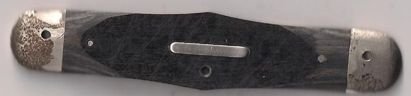

It's fairly easy to hide up in the rafters of the old Queen Factory! (Achoo!) Hanging by one arm and one leg (Achoo!) while snapping pics is a little tougher though. And, there's (Achoo!) 100-plus years of dust up there!!
Managed to get this though!!:cool:
Interesting, no???
Achooooo!!:D

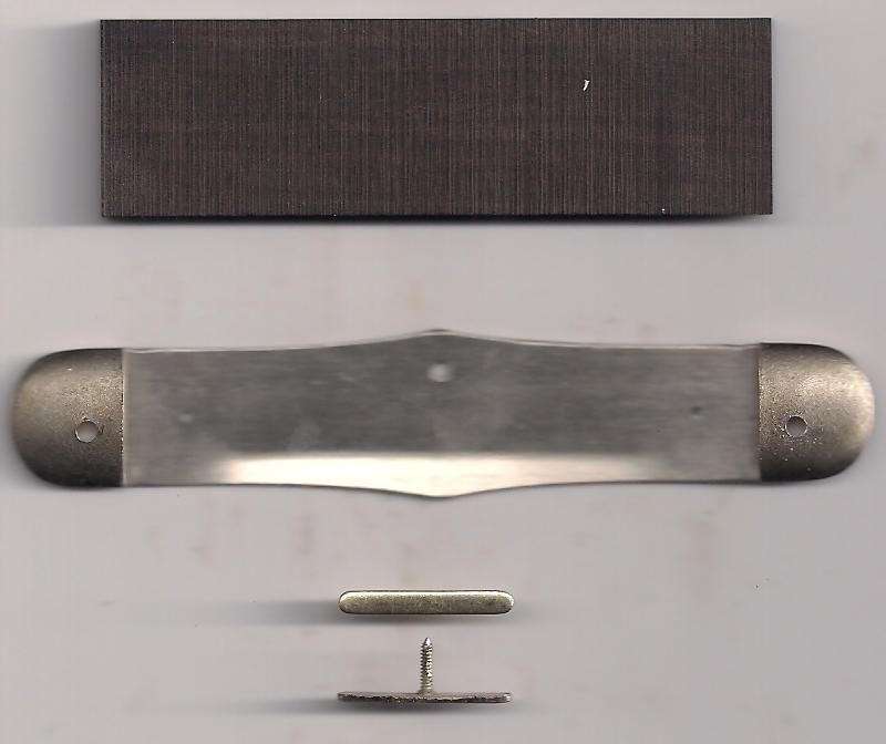

Applying a little subtle pressure, we have extracted the truth behind the handle!:cool:
Note, there is a slight "crimp" in the liner. This causes the liner to "spring" against the Ebony when it is riveted, lessening the chance of gaps showing. An old cutlery trick.

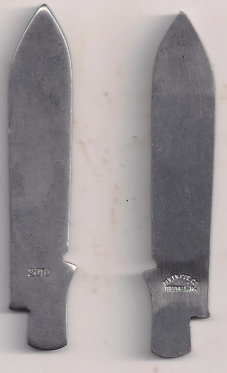

These are tang stamped and ready for grinding and heat treating! Like the Pointer Sisters once sang, "I'm sooo ex-cited!

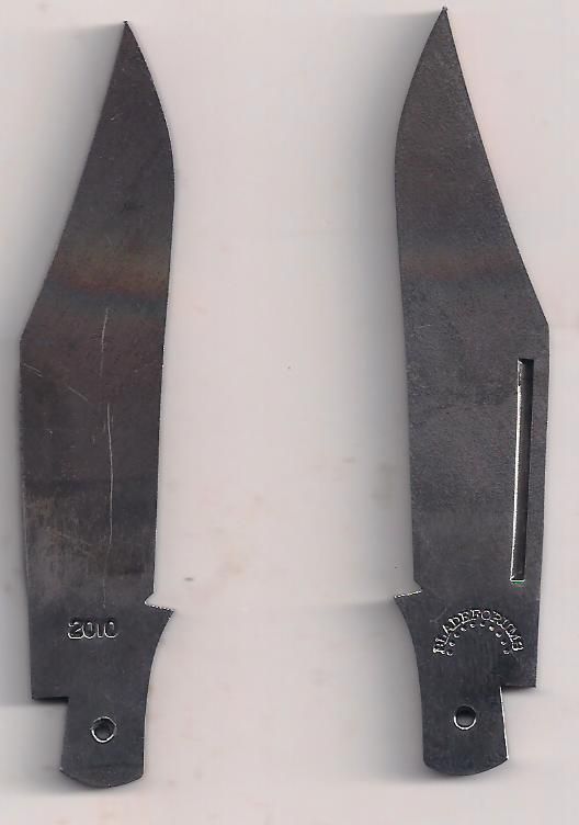

Here are the clip WIP images!
Swedges cut, blades nearly finished!

how cool is that!:thumbup:
thanks charlie!
gene
Charlie, I had forgotten that BF 2010 knife... lol! when I saw your spy picture it just then after few second delay hit me: I am getting one too, how I could have forgotten it :D
Hi Charlie -
Cool!
It is interesting to see one in that stage of completion.
Do you know anything about that, i.e. is it how they build them to put the scales on the bolsters and then put it all together to do the sanding/shaping etc?
Very neat to see a picture of it - thanks for posting it!
best regards -
mqqn
How did you come up with that one Charlie?:eek:
"The real story; (much more boring:yawn:)"
Actually, part of the deal was final approval on the shield they had in stock. So they inletted one to show me, and sent the pic.
It saved us a bunch of time and money, and it looks pretty good I think. I like the way the rounded ends are harmonious with the rounded bolsters, if you know what I mean.
They have a much smaller one, but this one seems just right.
And yes, it is pinned!! :thumbup:
They solder or spot-weld a pin on the back, and peen it inside the liner. You will be able to just see it inside.
This makes it easier to finish the shield to whatever depth is needed without losing the peen on the face.
I think GEC uses this method also.
