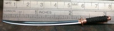

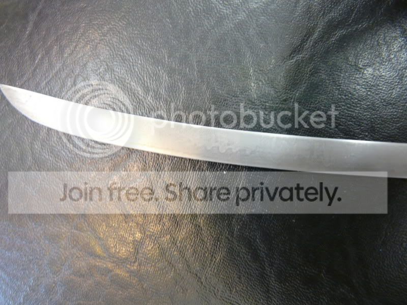

Ok....so i wondered if it was possible..... I did a real thin clay coat and took a razor blade and spread out some super thin fingers coming out of the clay, trying to replicate a choji hamon. I did 3 seperate normalizing heats before i attempted to quench. Well i turned the light out and watched as the blade came up to sunset red, checked for magnetism, and did a 3 sec on, 3 sec off interrupted quench in 125 degree water.....and prayed. It came out a touch bent but it went into temper cycles sandwiched between some pieces of 3/4 x 1 inch 1018 at 400 for 2 cycles of 2 hours. Came out straight as an arrow! Here is the result.

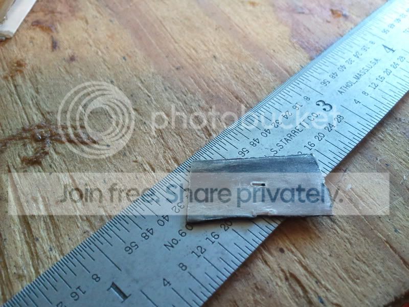

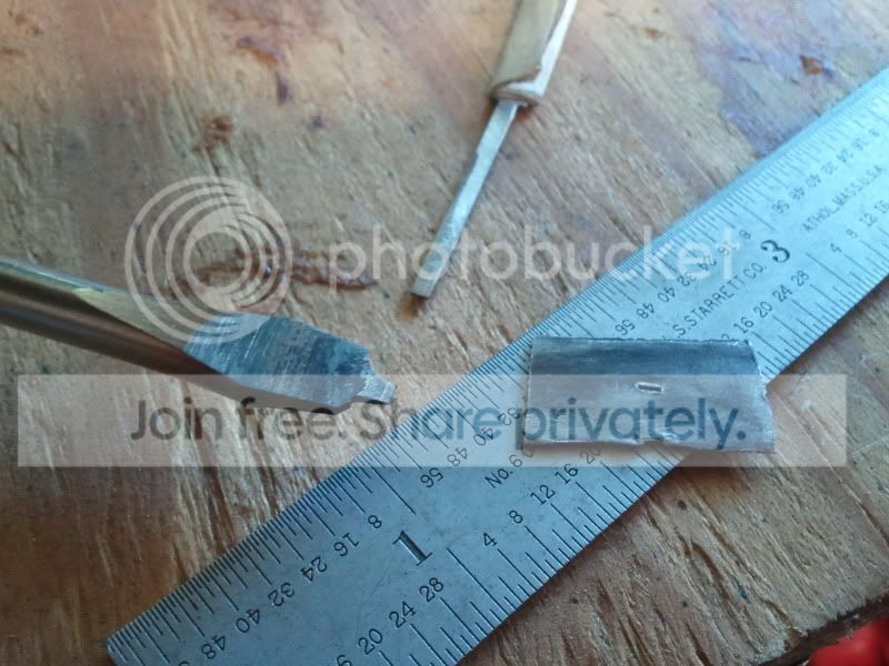

I started working on the guard today. It took me about 15 tries to get one I think will work. Broke a bunch of mini drill bits in the process. I started with some worn out hack saw blades for the stock, they were pretty flexible but really tough and I couldn't get the slot straight, so I went to my bicycle parts bin, found an old fender that was the right thickness and cut it up. It is mild steel and I still broke some bits. So I decided to make a punch to cut the slot. Took an old screwdriver, ground it to shape, heated it to critical and quenched in water. It did get pretty darn hard. Made a few practice runs before I got the hang of it. The neat thing is the knife I am copying is actually made this way as well! The hole is slightly undersized which is perfect, I will be sure to get a nice tight fit.
