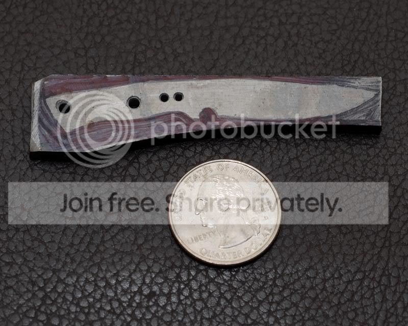

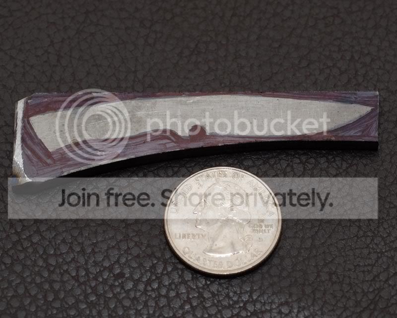

Glue up! I made the phenolic burlap "mycarta" myself. (ignore the green marker, it was just for layout) I tried to make it glow in the dark but it is very faint. I'm surprised how tough this home-made material is, it grinds slower than any G10 or micarta that I have ground yet!
I'll have more updates in a couple of days... this epoxy needs to cure now. :D

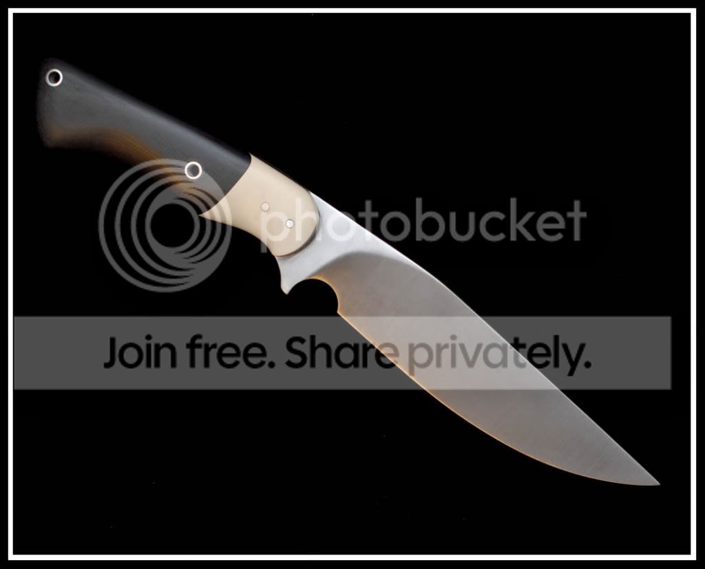

Alright, So I have had a busy day I worked all day on this KITH and tried to take Photos when I thought about it. First off I want to say this was a BLAST, I decided to use the same LORIEN design in the "Pay It Forward" thread HERE I am finishing up.

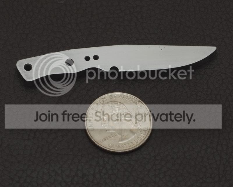

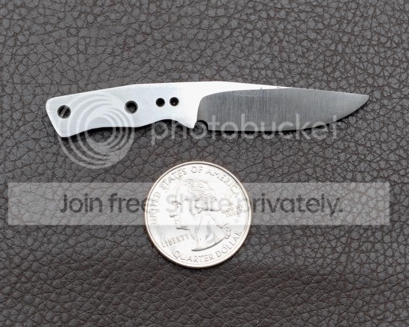

I dug through the scrap bucket and found a suitable piece of 5/32" (I was hoping to find thinner stock) 1095 Dropped Lorien's design on the Copy machine and set it to 25%. Traced the design on my piece of steel:
Drilled Pin Holes:
Profiled:
Ground:

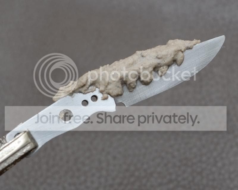

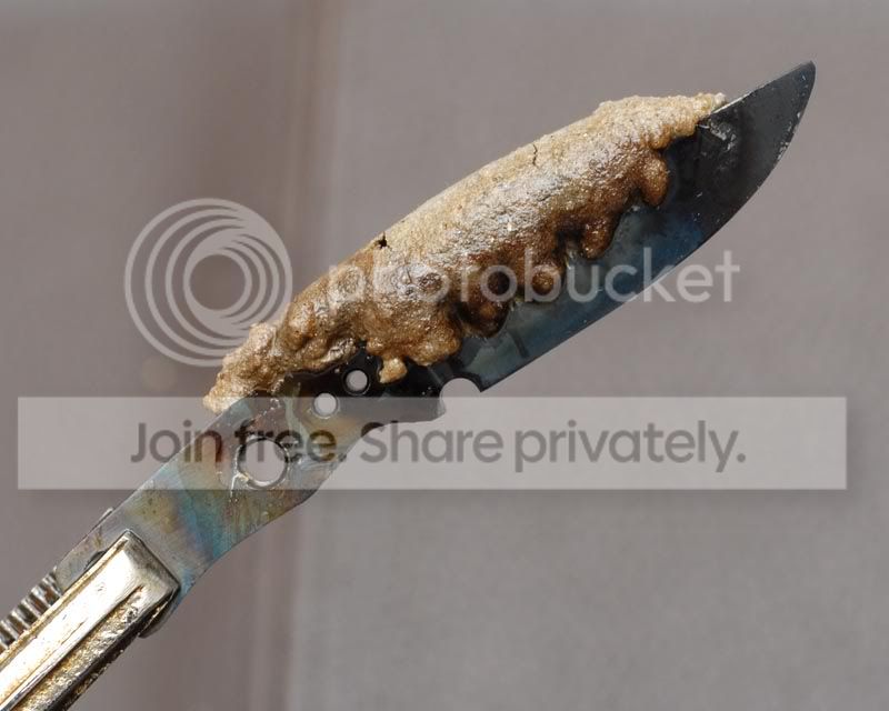

Clay for Hamon (Attempt):

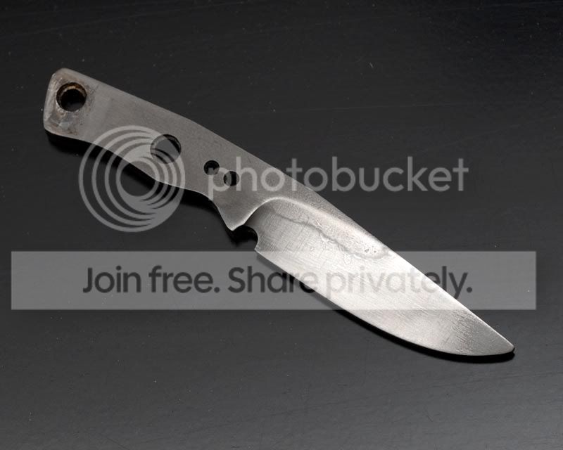

Post HT:
I cleaned up the blade and it looked like I got a great Hamon, but there was something funky going on, on the tip. Almost like a secondary Hamon, I should have left well enough alone but I didn't.
I Ran the blade through 3 normalizing cycles and Clay/HT'd again. This time I got a very faint Hamon but the strange thing is, the blade now looks like very mild Damascus? WTF? I am guessing that I messed up the HT and caught it in some type of transition... I left it cause it looks cool and this is a Mini not something that will be cutting and chopping.

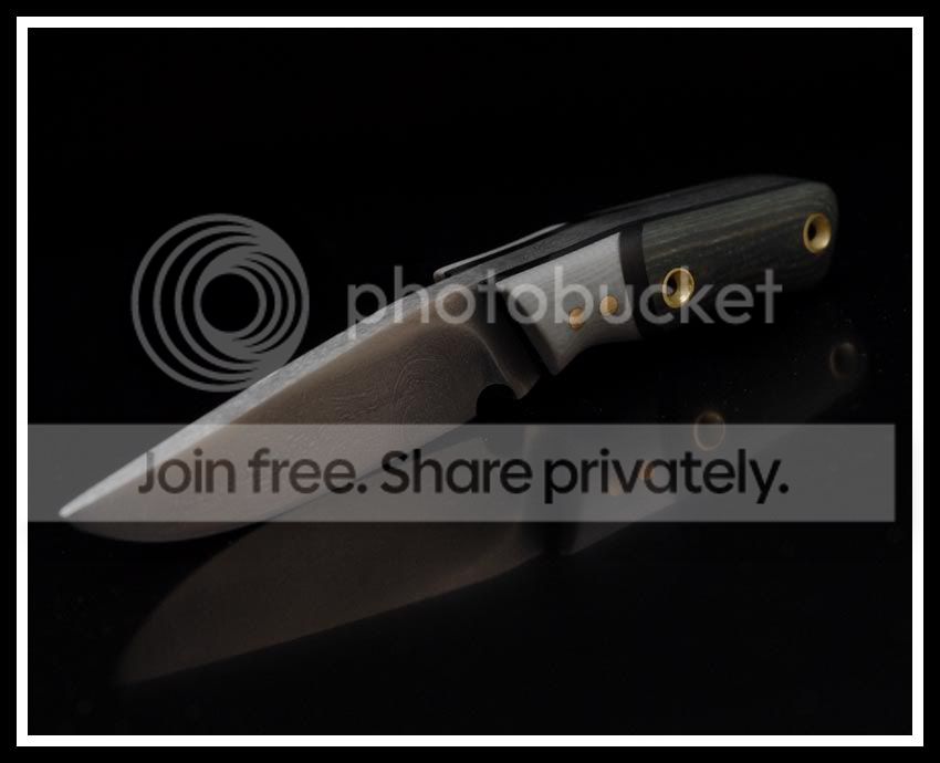

I wanted to do the two tone scales like I did on my PIF, which is a difficult task for me. So unfortunately I did not take any photos of that process. I am pretty happy how it turned out.

Lorien's PIF:

Ryan that is incredible! The damascus effect is really cool. I can't believe the detail you got on something so small.
How did you attach the scales?
Thanks Dan! I used 5 min. Epoxy instead of acraglas, and pins just like my full size knives. Here is an in hand photo. I had a lot of fun on this one.
