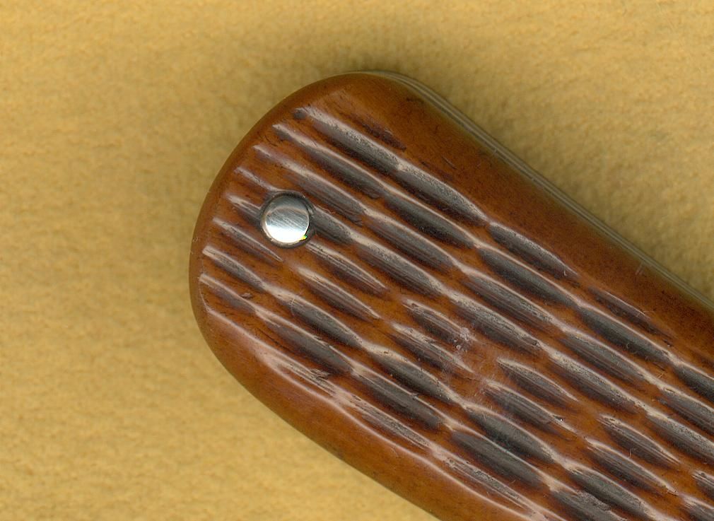

Well like most everyone, I really like the design of this year's Forum knife, and so I've decided to actually carry and use it.
So I've looked it over carefully, and I am altering it ever so slightly, to bring it closer to perfection, if that is possible!
I will hone the blades to my liking, but first; I prefer a little darker jigged bone, so I washed the knife in hot soapy water, to get as much oil out of the surface as possible. Then I warmed it up real good with my wife's hair dryer, and dosed it with Fiebeing's oil dye.
Before:
After:
Before I dyed it, I rounded the butt edge of the bone slightly, as it felt sharp to the heel of my hand:
If you are using your knife, or making it yours, post pics here if you like!
I'll post more as I get into tuning and using it!

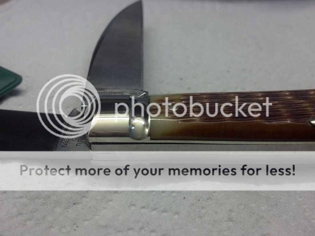

Now I can't be the only one who misses the rattail groove from the original knife description, can I? So here is my attempt. And for once I didn't forget the work-in-progress pictures, I hope you enjoy them :)
Before starting I just stood there, contemplating for 2 minutes, like in the cartoons with the angel and devil on my shoulders. Guess who won :devilish: :D

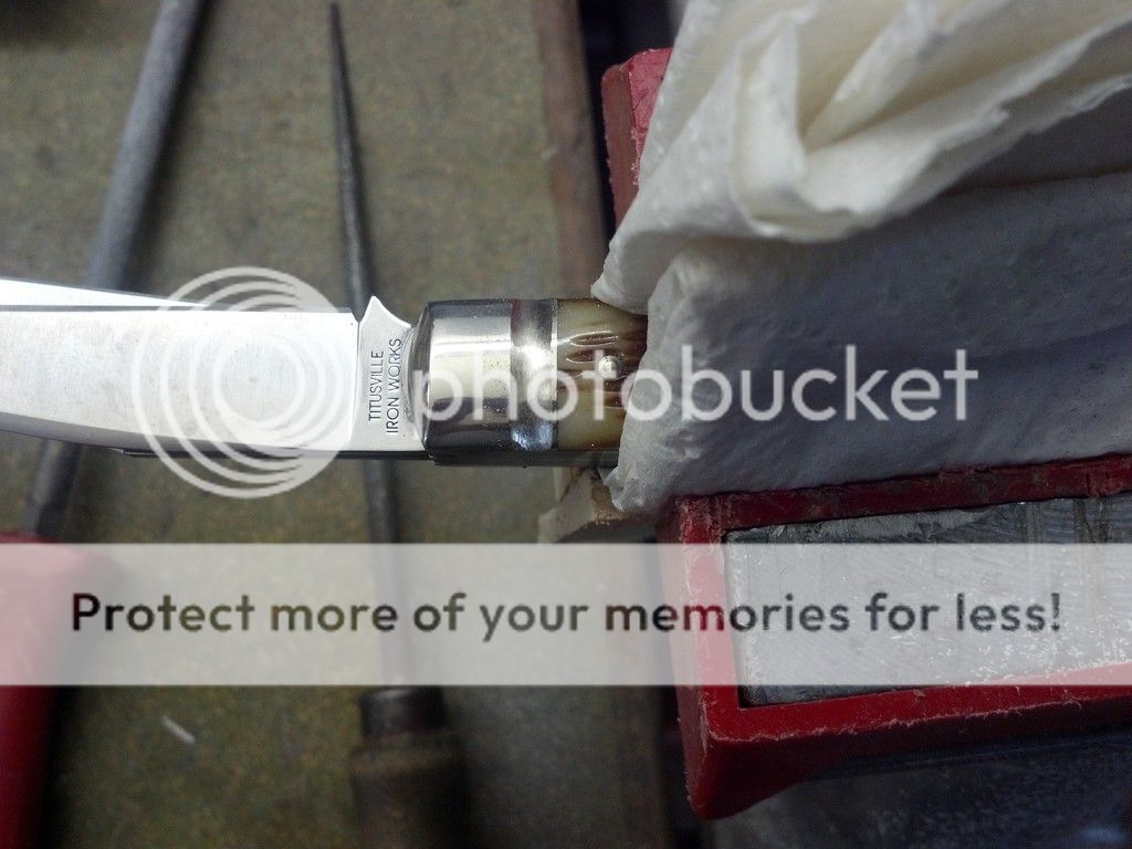

Filing the groove, the middle one from the three existing grooves works very well as a guide.

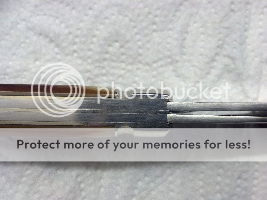

Done filing, to my surprise the grooves seem even enough.
After some sanding, ready for polishing. I wasn't sure if I should polish it or apply a satin finish to the whole thing, but that is easily changed.

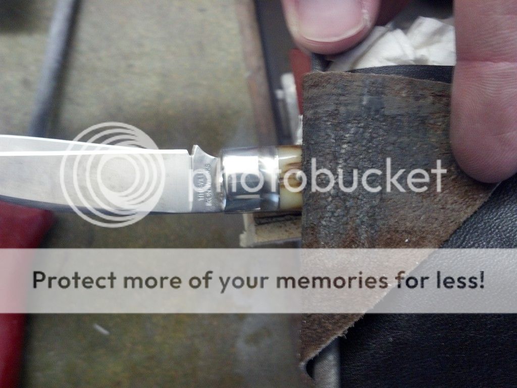

Polishing with a piece of leather and buffing compound.

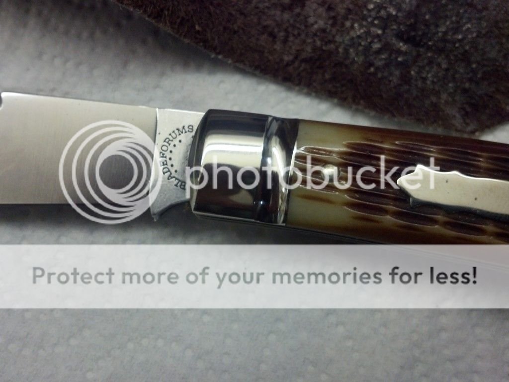

All done.
And the other side.
Really happy with the result, no regrets and all the fear was for nothing :)
As you can see I also put some nice new edges on there, the wharncliffe is very acute and is reserved for delicate slicing work.
Plus I blatantly stole the other ideas, slightly rounding off the butt and honing the outside of the clip blade spine.
