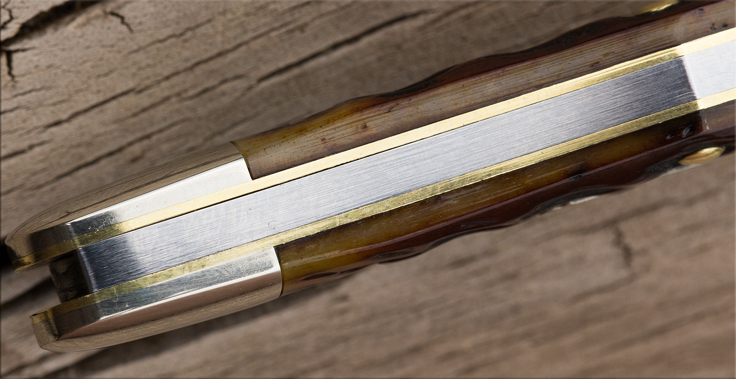

@ivonrei @BDubbs that would be yours truly. Mine arrived the same, large gap between the spring and liner, gap was on the end with the main blade. Used some Quick Release oil and worked the blade holding it with a shop rag. After a few cycles felt a "pop" and whatever piece of gunk that was lodged in there was gone and so was the gap. Maybe a burr but probably just debris. Was disappointed and ready to send it to GEC. Here is a before pic, don't have an after pic but zero gap now. Good luck resolving yours.
I had not heard this before.
Good information to keep filed away, thanks. :cool::thumbsup::thumbsup::thumbsup:
