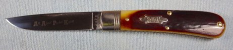

Spent a little time today on my previously 'brushed' Ironwood Mustang. Used some strips of 1000, 1500, and 2000 grit sandpaper - and then a few polishes with some Mother's Mag & Aluminum Polish. I'm pretty happy with the results. :thumbsup:
That looks fantastic! I'm curious, did you sand the wood also or work around it?
That looks really good!
Thanks for the kind words! I used the various grits lightly on everything - except the blade - which was covered with some blue painter's tape until I was done. The mag polish was used on all the surfaces that got sanded. I did have to go through the process a few times because a brush line would show up here and there that wasn't noticed until after polishing...in either the wood or NS. Took my time, maybe an hour start to finish. I'm thinking some pocket carry will polish it even more. :D
