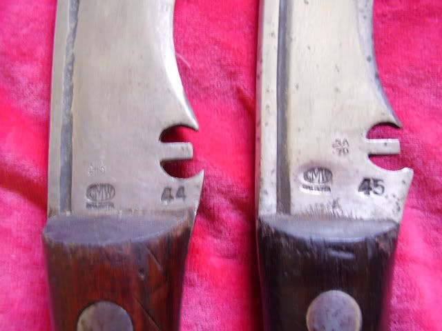

CMW {Calcutta}, produced very high quality specimens that have many easily recognizable manufacturer & army inspection stamps.1944, 1945
Many MK.III were sadley rather badly stamped. Other manufactures include Chowdri & DKW who both produced during 1945 at least but most likely for the Indian army after Independence as well.
There are vast Numbers of other makers of these kukri in both WW2 & ever since. Once again those marked Allied Steel or Tempered Steel , Made in India are from around or after Indian independence in 1947.
Many of these kukris have been made to the present day & it has been used by many Indian army Gorkha units as well as commercially exported in lower quality versions to the USA & Europe for over 60 years.
It weights from 19 oz to 26 oz. {On those I have examined.}
1944 & 45 versions of the CMW mk.III kukri & detail of manufacturers stamp & army inspection marks.

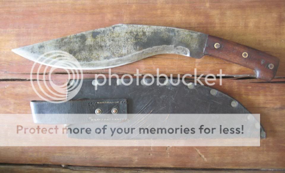

I don't suppose you have any information on this style of military kukri?
I've been curious about it since I first saw the picture, but I don't know where to go to find more info.
Per this book on military knives, they are a mystery, but have been seen in photographs being worn by British troops in India between "the wars".
Per a member on another forum, they were "Chin Rifles" khukuri used in Burma. I'm guessing he is referring to Chindit units. I've seen a wide variety of khuks in photos from Burma, but not these, so I can't say either way.
I have shamelessly:D stolen a photo of one from Jay Goliath. He, at one time, had access to one. Maybe he'll drop in.
So that really is about the only information available on them. That's a little sad. I'd be interested to get the full story on them. Maybe we can get HI to make a run of them, call them Chindit Kukris. of course to prevent fraud they would be HI marked and all that.
Of course! Not much though.. Its an Enep not a kukri. Flook called it a kukri & everyone just followed on... I can see why though!
Its a British Indian Army rendition Of a traditional Burmese knife. {Just as kukri & Dha were also copied.} Its a powerful chopper!
It was carried by some the Burma Rifles on occasion, & is based on their traditional knife often called an Enep in Thailand. It was also issued to some British Mechanical Engineering troops. Possibly others as well. Most scabbards have soldiers numbers on, often multiples off.
The were made from at least 1917 to 1927 at Cossipore armoury in India.
The Chindits were formed in 1942,{My father was one of them. Long after these were made. ;) {The chin rifles were attached to them then though.}
