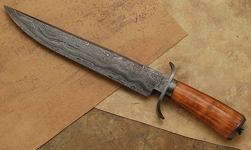

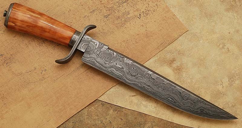

Here’s a piece I finished recently. My client asked if I could make him a unique fighter using any left over Damascus pieces I might have from previous projects. After locating and cleaning up 22 pieces of different sizes I put them into a 3”x3”x3” can and welded them up, this is what came out.

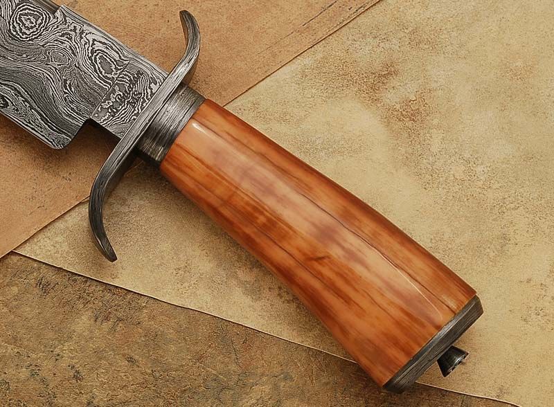

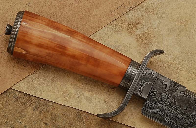

The blade, guard, spacer, butt cap are all from the same Damascus .The specs are
OAL 16 1/4" with a 11" blade , just a little under 1 3/4" at 1.670 wide at the widest point and .345 thick at the ricasso, its a heavy blade with a balance point approx. 1" in front of the guard. Handle is a beautiful piece of walrus Ivory.
Thanks for lookin”
Bill
