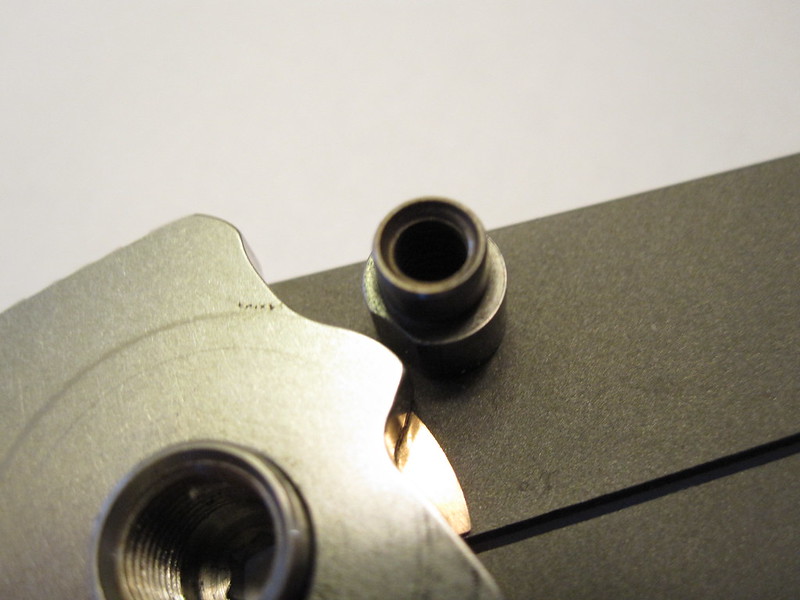

Take down:
The amount of work and detail put in this thing makes it a work of art IMO
Notice the work on the stop pin to increase clearance of the blade

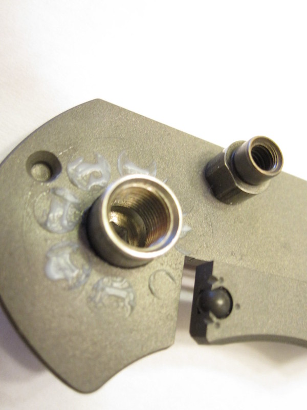

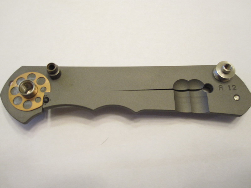

Notice the HUGE pivot (increased stiffness) and notice the washer details (smaller holes near the lock face to hold less lubricant near that area. Reduced contamination/wear???; held in place by a small hook/indent)

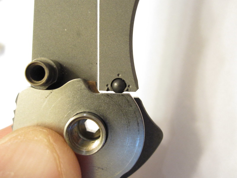

Notice how beautifully the titanium is "deformed" to trap the ceramic ball
This is my first experience with this locking system. Notice the small contact patch between the lock bar and the blade tang (only the ceramic ball is in touch)

Very nice pics! It shows a good example of the amount of grease used, I always use too much.

When I took mine down to see what was inside I was intrigued by the stop pin and the way it interacts with the blade. Does anyone know the function of the scallop in the stop pin? It almost looks like rotating the stop pin will change the lockup. I don't have calipers so I couldn't check to see if it is eccentric. I can't imagine ever needing to change the lockup but it is a cool feature if that is what it does. Who knows, I may be way off on this one but I'm sure someone here can set me straight.

Those are some great pics! I received my 25 on Friday and am not planning to take it apart in the near future, so it was great to see the insides and all the nice details. That ceramic ball is larger than I thought it would be. Is it larger than the one in the Umnumzaan?
