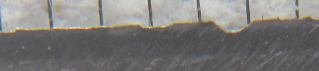

My test of edge stability (didn't test edge retention for normal uses) of a small blade in 26C3 64.5rc (400F tempered). cut a bunch of newspaper and cardboard = passed. whittled pork rib bone: marrow end = passed, hard end = ripple. Here is result of failure mode testing
* note: fractured neutral axis is very close to center line.
Tentatively put 26C3 edge stability a tiny bit lower than w2, 10xx, 52100. It was easy to get this edge very sharp - in a way more similar to blue#2 than 52100, ok a hair splitting assessment ;)

Robert, I value your opinion. What was your temper temp? I’m guessing 400f but just wanted to clarify for the threads sake and for future reference.
