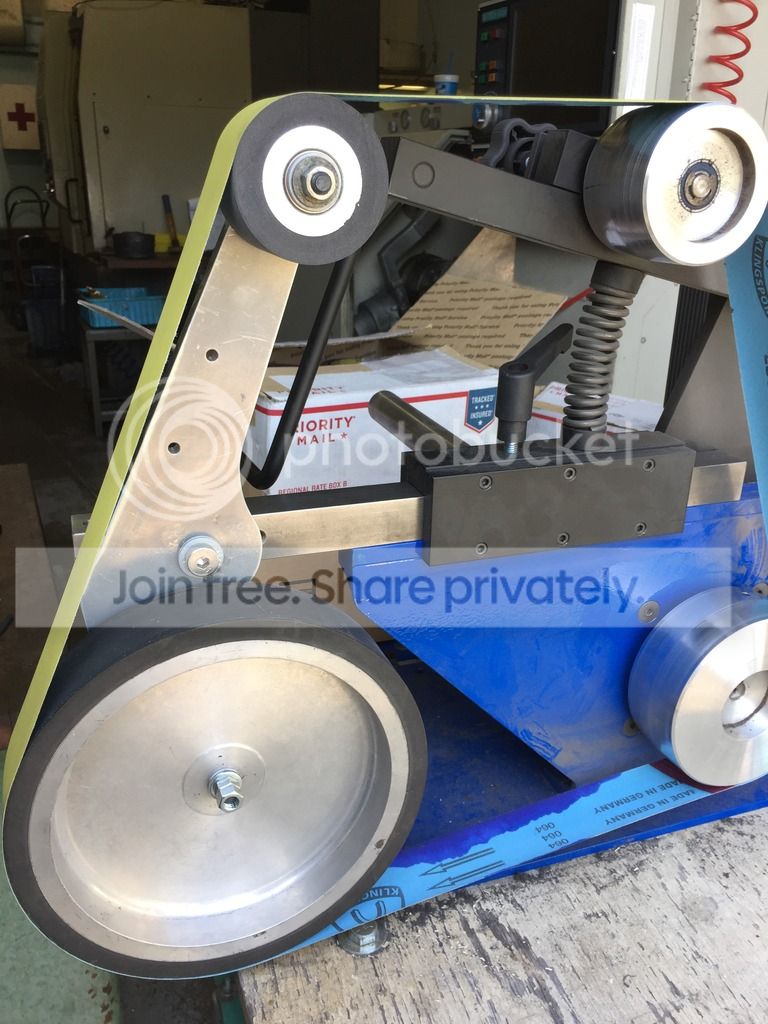

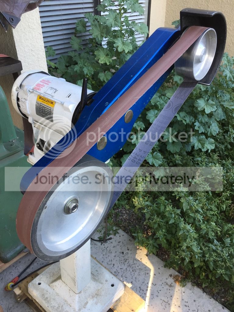

I have an Esteem and Hardcore Grinder. The Esteem I bought new, the Hardcore I acquired used, it has a Baldor DC variable motor and 2500 RPM.
I think the Hardcore might be more versatile...at least for me....
With all the attachments, the Hardcore and TW-90 might be about the same pricing
my Esteem has some glass on the platen.
I agree the Esteem tool rest needs 3 hands to make it work. I don't like it very much
I also feel like I can stall the motor when flat grinding
with a 10" wheel
with a swivel platen I made
