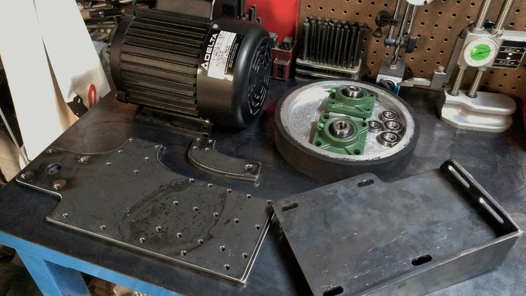

I went to a good friend's house today and made use of his plasma table. Considering how little work we did dialing everything in, I was happy with the results. There were some cosmetics issues here and there, but nothing that can't be massaged out. I decided to just drill the small holes on the mill, as plasma can be pretty iffy with smaller holes, even if using fine-cut consumables and spending some tuning time. I probably would have used laser or water if it was in the budget, but this is more than sufficient for my current needs.

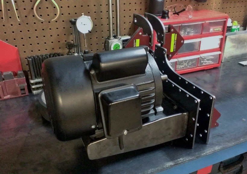

This is a little mockup I did, just to get a feel for everything with the motor in place. I'm pretty happy with it. It looks like everything will line up nicely. The line of holes along the bottom is for the tilt mechanism. It will be a heavy duty piano hinge, and the side shown will have two spring loaded draw latches for the vertical position, while the horizontal position will rely on rubber stops.

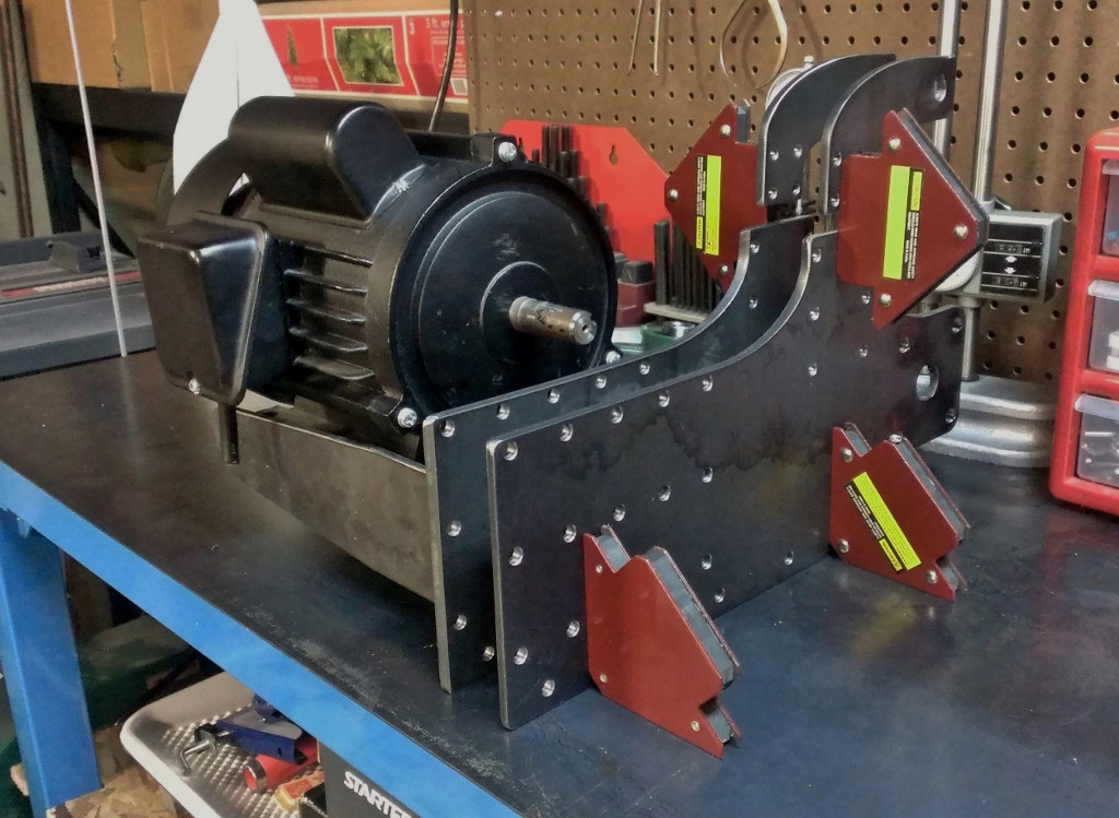

Here's the current family photo. I'm still waiting on some parts and materials, notably the material for the idler and drive wheels, as well as the step pulleys, shaft material, and some fasteners/odds and ends. I got the motor from my old boss, it's a single phase 1hp/1750rpm take-off from a very nice Delta drill press that was refitted with a DC motor and speed control. I wish I could justify a variable speed setup right now, as I'm a huge fan, I've had variable speed on almost every machine I've used in the past years, and I love it. I'll just have to live with the 3-speed step pulley setup for now.

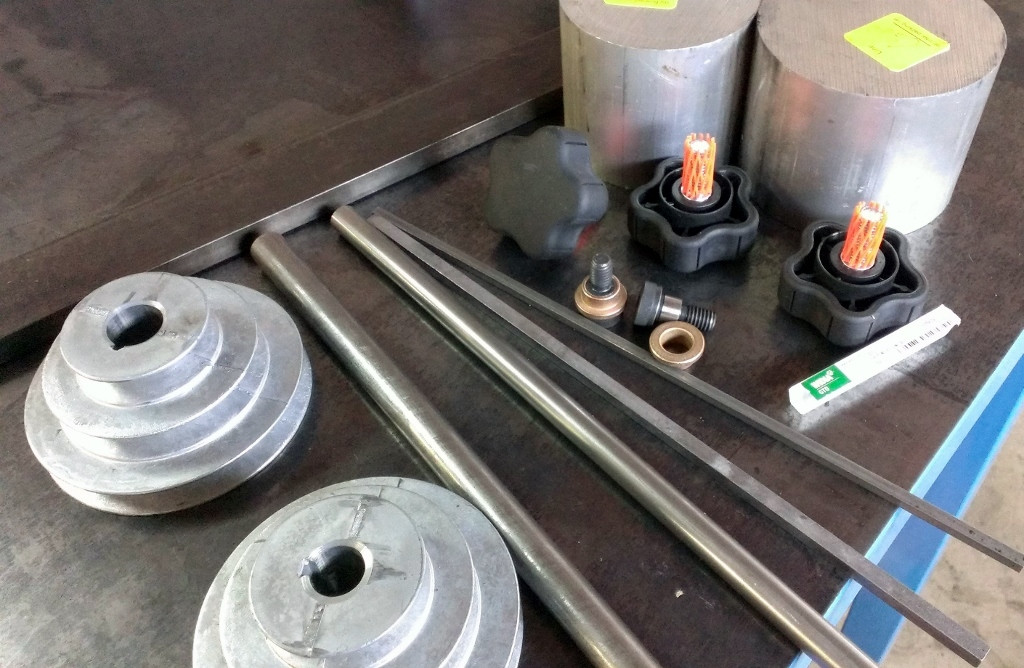

I got my second to last order in today, but I'm still missing my hinge and latches (for the tilt mechanism). I also got the knobs (for clamping the tooling/idler arms in place), key stock, pulleys, steel bar for the crosspieces, shaft material, the 6061 billets for the drive and idler wheels, and the shoulder screws and oilite bronze bushings for the tension arm mechanism (probably overkill, but they're cheap and cool :)).

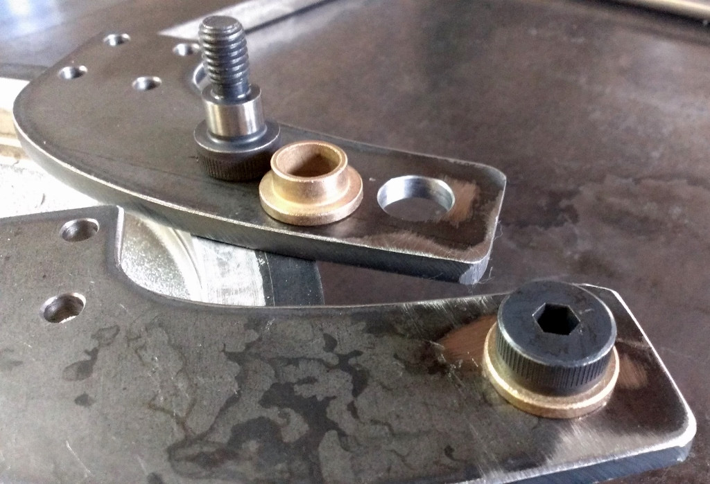

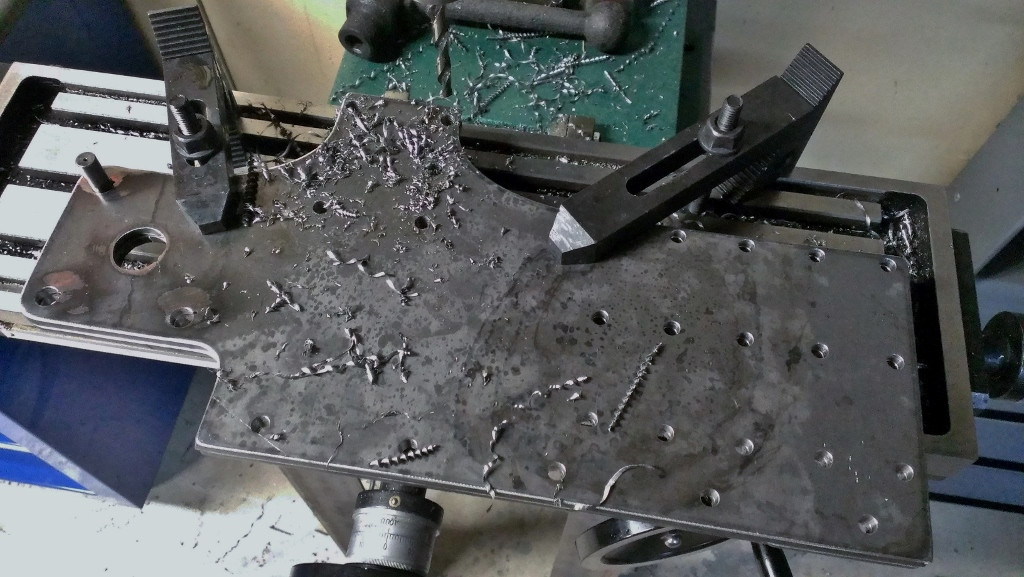

The only real work I did today was boring the idler arm support brackets to 5/8" to accept the bushings for the idler arm pivots (1/2" shoulder screws). It's the first time I've used the my adjustable boring head on my small mill, and it worked quite nicely. It's kind of exciting to be doing real(ish) machining out of my own garage. :)

Very nice build! I see alot of care and quality and thought going into it, so I gotta bust your chops about using pot metal/aluminum pullies instead of cast iron! :D
The hinges are all made from 1" OD tubing with 1/4" walls, swinging on grade-5 1/2" fasteners. I added a photo of my tracking adjuster in case you are still in the design phase in that.
I forgot to comment on this before. It looks like a robust mechanism. I am kind of putting off designing mine, but I really need to have it done by tomorrow night. I want to try and have it be sturdy yet compact, not quite sure what angle I'm going to take at the moment. (edit: I think I came up with an idea, will possibly update this post later if it isn't stupid)
I know, I know, figured someone would razz me for it. :p
They were the only ones McMaster had, and I already was ordering from them, so I had to go with the budget conscious option. I do plan to upgrade to cast iron in the future, but I also will eventually go variable speed so I may just order everything at the same time. I did some hand dressing on them and had to tweak one a little, but they will (hopefully) be passable for now.

I assume your 10" contact wheel is the one from Grizzly. Let us know how it works out once you add the bearings. I am in the midst of my own grinder build (not nearly as nice- based on the No Weld Grinder), and while I expect to do most of my work on the platen, for about $80 and a little work, I may want to try the same.
